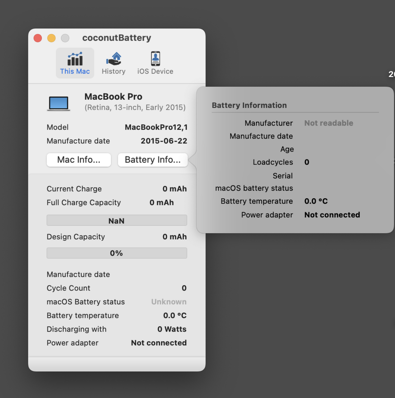

I have reset the SMC and downloaded coconut battery with no luck.
Here is a screenshot below from coconut battery for your reference:
I asked Ifixit for a solution and they just sent me another battery to replace it with. The exact same issue has happened again after Ifixit sent me another new replacement battery. The issue has happened in the exact same way within roughly the same amount of time.
My laptop does not show a battery icon in the menu bar and it will not turn on unless plugged into the power.
Is there something wrong with my laptop / logic board or is there something wrong with this batch of batteries that Ifixit are sending me?
Please help. I am stumped.

Coconut gets info from: About This Mac>System Report>Hardware>Power. I take it it's the same lack of readings there too? Also, was all the relevant info re battery displayed properly within the weeks it actually worked?
It is the same lack of readings there too, yes.
It was all displayed correctly until it stops working. So odd
