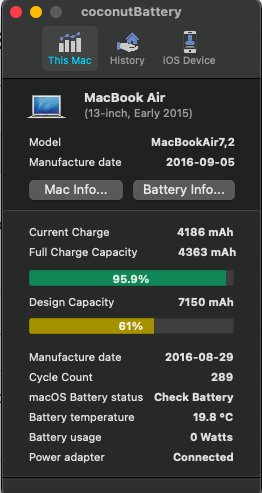

Had it for 4 years from new and just noticed after upgrading to MacOS Big Sur that battery service indicator warning is on. Battery cycles are only 289. Is this normal for so few cycles? If so can anyone recommend replacement battery in UK. Seems to be quite a few different ones on Amazon ranging from £40 up to around £80.

What is the battery health according to coconut flavor?
See screenshot. I tend to use the Macbook plugged in to power most of the time. Could this have something to do with it?
View attachment 1668961:
All laptop batteries will degrade over time, even if they are not being used.
The battery is just over 4 years old. I've had batteries that lasted to about 5 years before they needed to be replaced.
Keeping it connected to a charger at all times may or may not have accelerated its depletion.
At this point, I recommend replacing it. Upgrading to Big Sur and getting the replacement warning may have been pure coincidence. I'm surprised you didn't receive the warning around 75%.

I think it was coincidence, I just hadn't checked the health previously when using Catalina and maybe missed previous warning message. I tried running without power this morning to see how long battery lasted. Was on a Teams call for about an hour which I know is heavy on the battery, then got about another 30 mins, battery was down at about 43% and then just died on me. Are you able to recommend suitable replacement battery?
