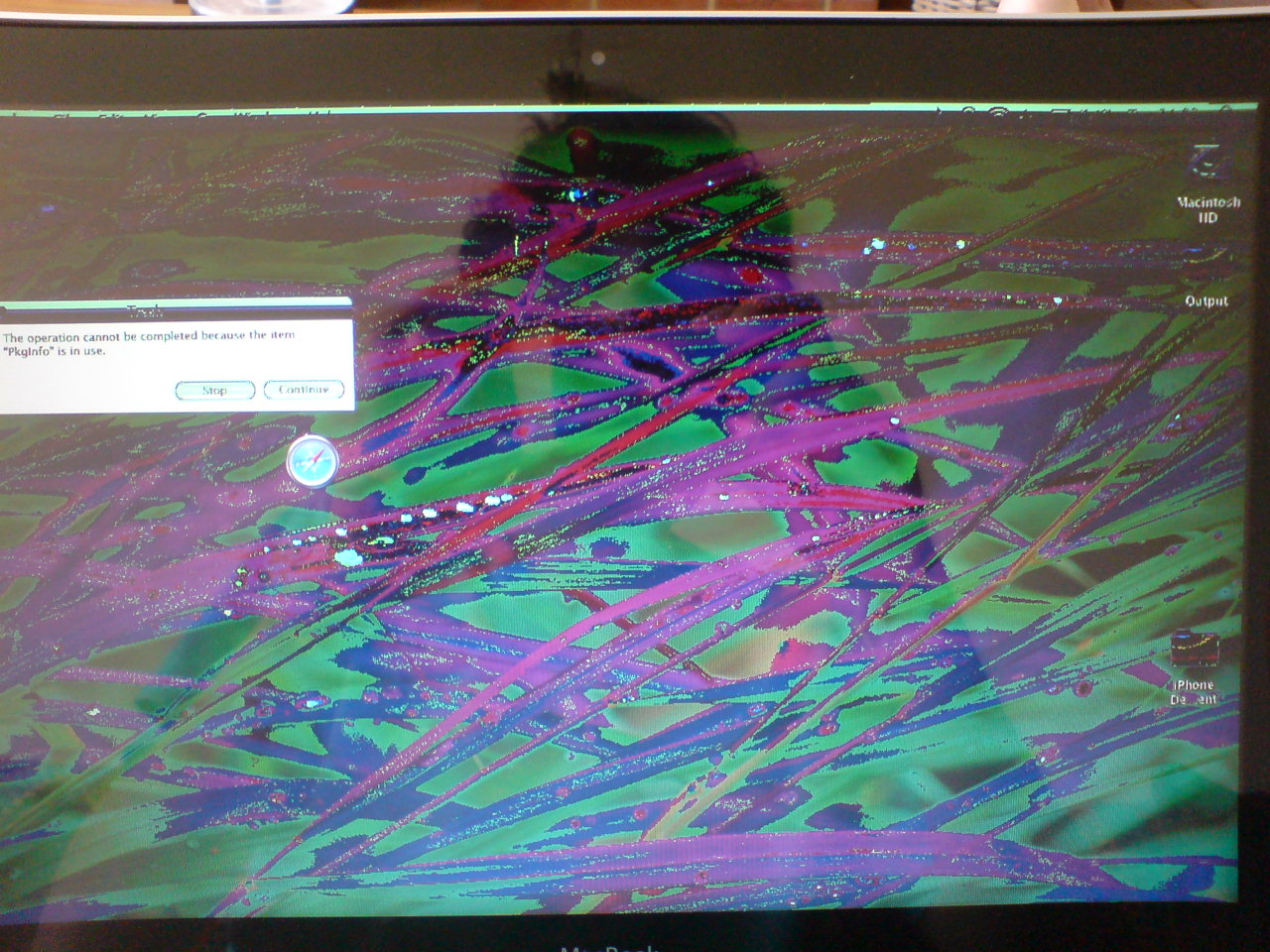

I couldn't find anything about this problem, so I've decided to make a post:
So earlier today I was using my dads Macbook when all of a sudden the screen suddenly changed the colours (see attachment) I then closed the lid and opened it again, finding that the problem had been fixed. However - a minute or so later it happened again so I snapped a photo of it; then closed the lid and opened it again and now it hasn't reoccurred yet. Also, the cursor seemed to have changed the Safari symbol for some reason.
We're now wondering what the problem is, and if the Macbook needs to be sent to apple? Thanks in advance.

Looks like a bad graphics card. Have you tried rebooting?
Yeah it hasn't done it again, but I will report back when/if it does. We're going on holiday for two weeks on Saturday and we are taking our Macs so that we can save pictures; shall have to see if it happens during that time. It's just an odd problem as I haven't found anyone else having it from searching google.
I have been struggling with the same problem with my Macbook for a while. I brought it in today and they are replacing the logic board. I wasn't able to bring the computer in for a while since I needed it for school. The problem is more annoying than anything. Just make sure your are constantly saving your work when you use the computer since it will have it's problem at anytime. When you get back from your trip take it to the genius bar with the pictures they will help you out.
Thanks for you help, we'll take it in with pictures. It hasn't happened again but we'll probably take it in after our holiday.
I went to the Applestore one week ago and told me it was a common problem with the Graphicscard. So it was free of charge and replaced in almost a week 😀

Had the same problem. It was the logic board and it is very common for this macbook. No problems after taking it in for replacement.

That looks similar to what the Macbook did, except it hasn't happened again since the first two times that it occurred on that one day. Have no idea what happened but it's now working months later - quite odd. I doubt it's the hard drive since that should have no impact on what happens to the graphics :/ Have you taken it into apple? It's probably the logic board as suggested by other people, just don't know why it was a one-off with my dad's macbook.
