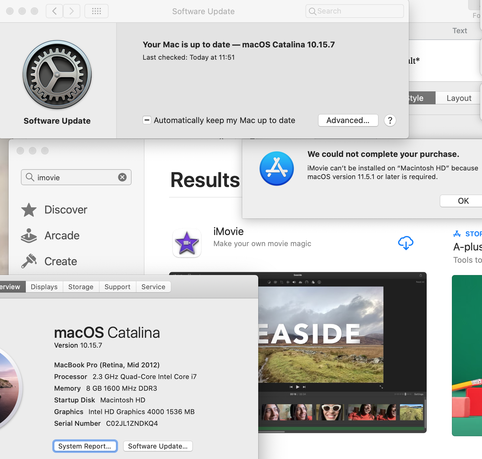

thanks for suggestion , l tried to download it from app store, and it says my 2012 mbpr needs latest software, but on checking, l am running latest. is my 2012 mbpr just getting slowly removed from the apple family? pls see attachment

What software is the 2012 MBP running?
You’re running Catalina, while the App Store says you need 11.6, which is Big Sur. Catalina is 10.15. Your Mac is just outdated. I think @Fishrrman above has your answer.
