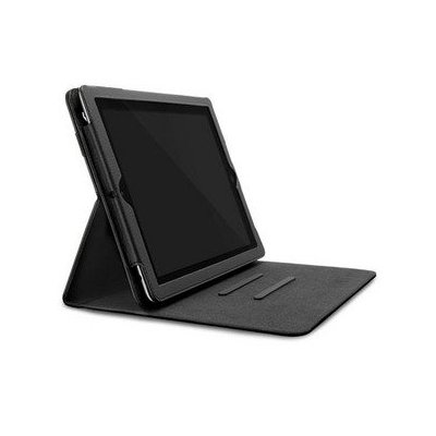

I'm wondering if using a back cover makes a difference in heat. Were any of these results using a back cover? The aluminum back is a very effective heat sink and I'm wondering if bottling that heat is not good.
I'm using the Incase Book Jacket and getting average temperatures of 25c
