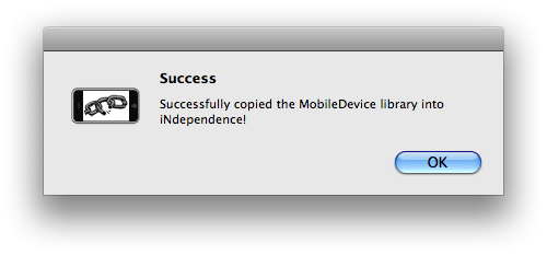

If you use the MobileDevice_7_4_2.framework file downloaded from Rapidshare, you need to rename it to MobileDevice.h before you try to select it using the Independence MobDev tool.
Don't ask me why this crucial step isn't mentioned in the instructions... took me a lot of trial and error to figure it out. I finally figured it out by searching the Macintosh HD for "MobileDevice" and noticing that the one that is actually installed by iTunes is MobileDevice.h
You sir, are a god! How in tarnation did you figure that out?????
I renamed the MobileDevice_7_4_2.framework file to MobileDevice.h,
and it magically turned into a folder. I was then able to navigate to this
folder using MobDev tool, and selected it. Then I selected the INdependence
app, and I got the following message:
I then downgraded to 1.1.1 and used INdependence to kick it out of DFU mode.
Now I'm back on 1.1.1 with all my favorite programs. Thanks so much!! 🙂
