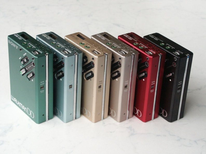

I’m more into anodised blue than red but those are freakin‘ gorgeous. :D

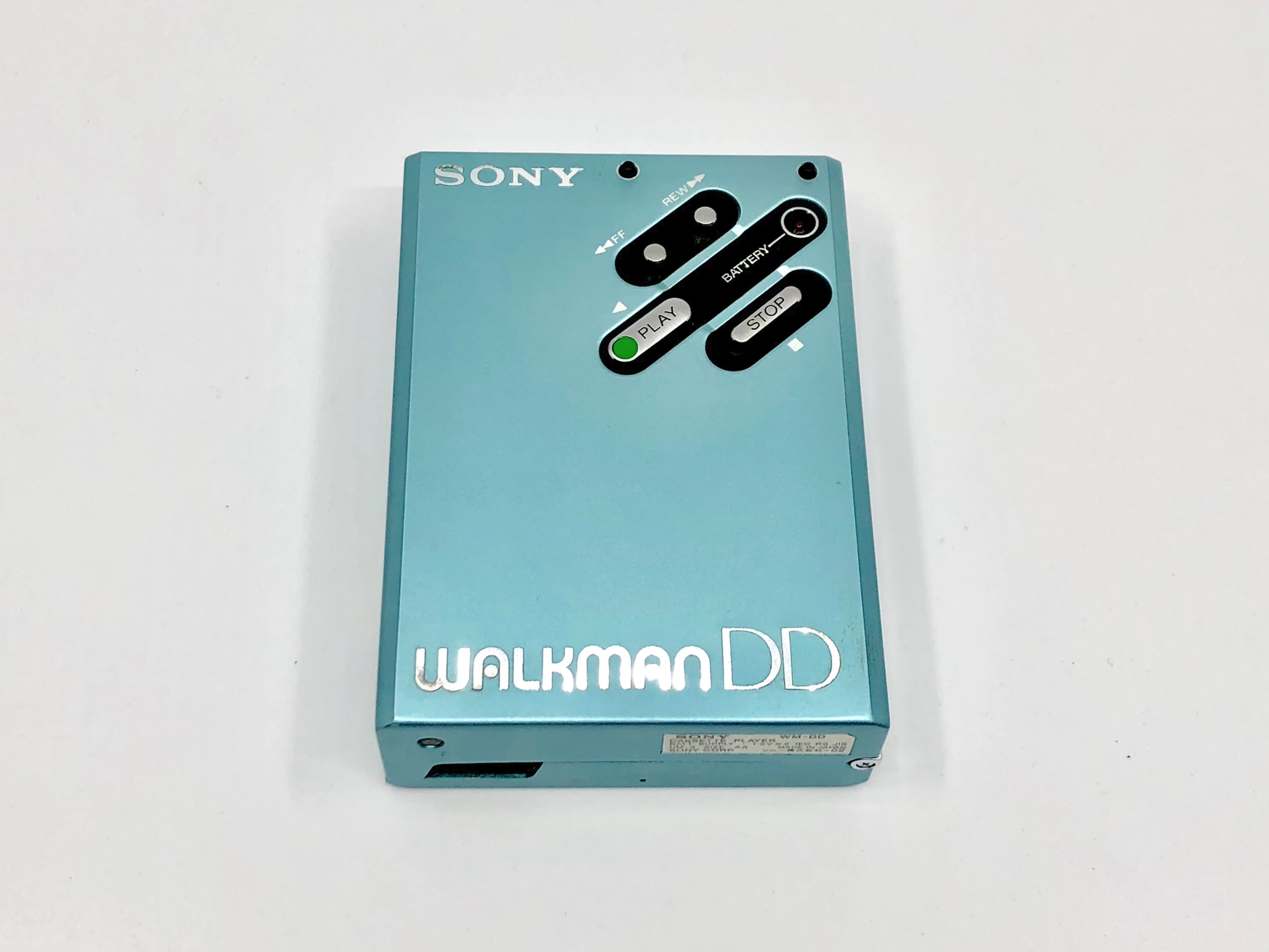

Yes, the blue editions are amazing, too! As is green:
This one has, almost, a robin’s egg mood:

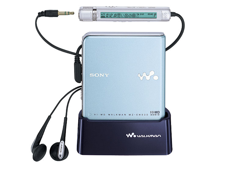

Given the way the 1980s slab period was right during when pastels and de-saturated hues were having their moment, I would have loved to see more vivid blue and green variants. (The frequency of solid red appearing for several of Sony’s limited edition variants is, of course, self-evident.)
A blue, for instance, might have more closely resembled the much later anodized blue of the Handspring Visor Edge:
