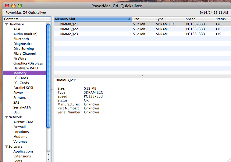

I have seen various discussions around here and elsewhere about whether or not ECC RAM will work in the various G4 towers requiring SD-RAM. Most say that it won't work, with some saying that it does.
Not too long ago, I found myself short of 512mb sticks, and went to my favorite virtual boneyard-Ebay-to stock up on them. I ordered 5 sticks of PC-133 from Hong Kong.
This was advertised just as standard PC-133 low density RAM. Nowhere in the description nor on the sticks themselves does it claim to be ECC.
None the less, I put one stick of it in my Quicksilver, and this particular stick is identified in system profiler as ECC.
I've had it running for about a week, and have had zero issues. That included some heavy Photoshop use and other tasks which should have taxed the system resources.
As I said, the RAM stick I installed is not marked as to being ECC. It is a Transcend brand stick, and carries the part number 266885-0079.

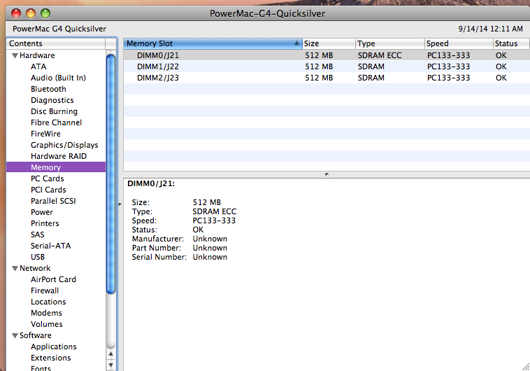

Here's the system profiler screen shot.
Reactions: lepidotós

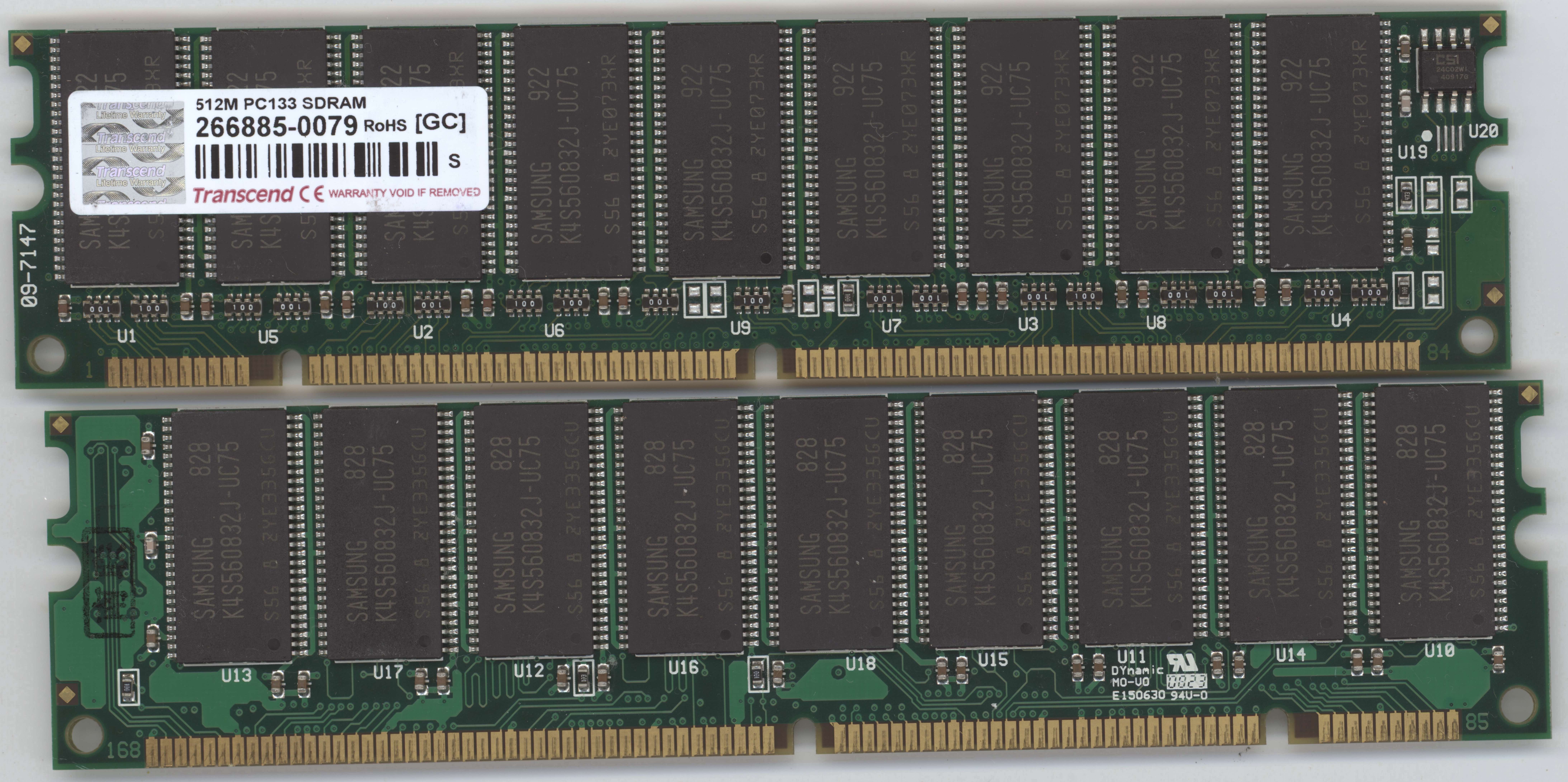

Post pic of the module, part number search returns nothing.
ECC ones have little extra chips which handle error correction. If it would be an ECC stick, it shouldn't work together with non-ECC ones.
More likely OS can't read SPD of the module and identifies it wrongly.

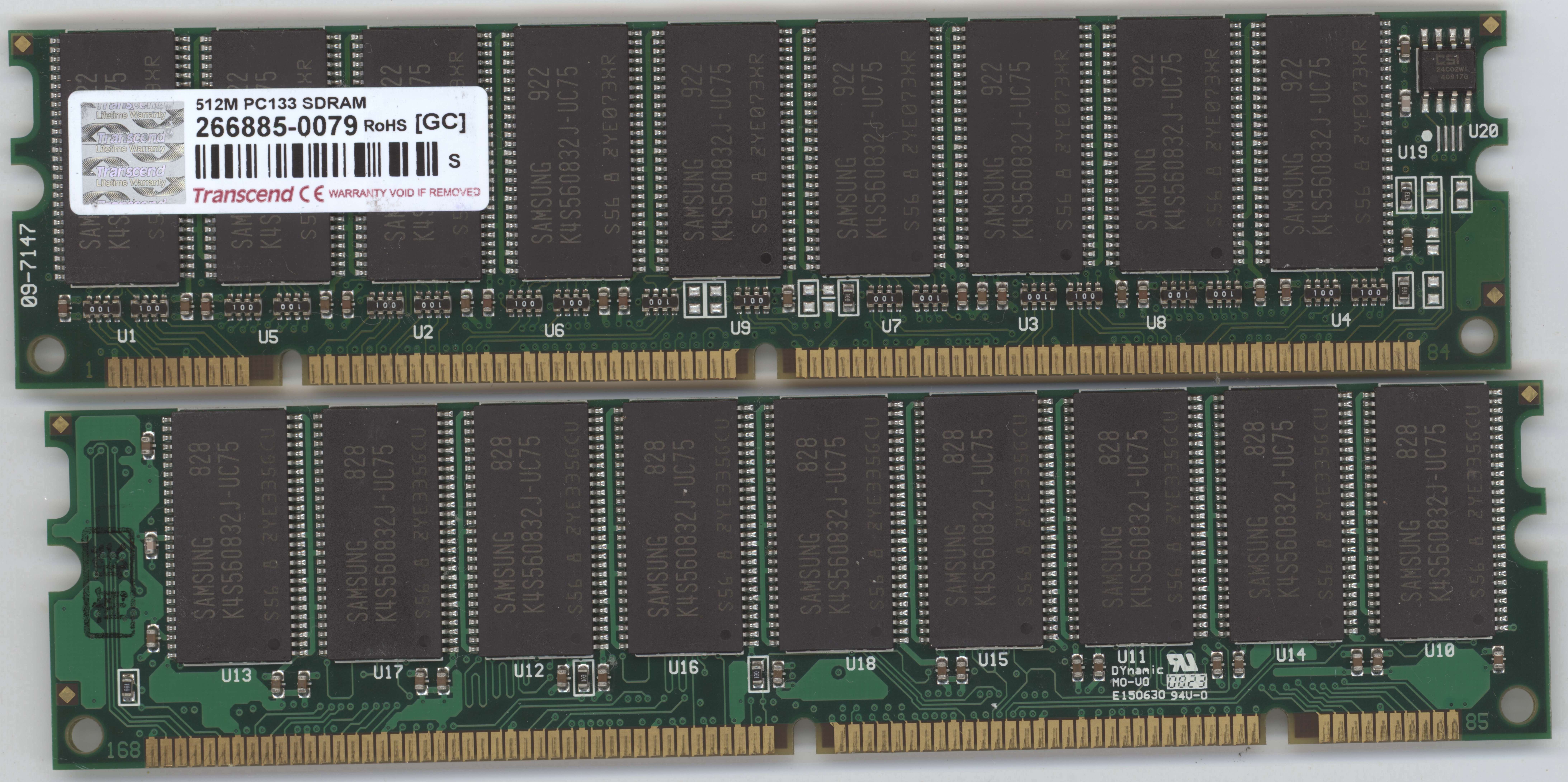

Here's a front and back scan. These are actually two separate modules, but look otherwise identical to me.
I'll also point out that these have 9 chips per side-every other 512 I looked at had 8 chips per side.
The ones with 9 chips are ECC memory. Check out Wikipedia. It looks like you got ECC memory working on a Quicksilver.
That isn't ECC ram. It's missing the extra controller chip that is often half the size of a regular SD-RAM chip.
Intell, it's ECC unbuffered from what I see. That extra controller you mentioned is present only on registered RAM. 9th "regular" chip just handles error correction.
