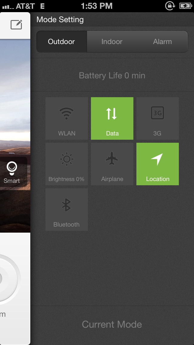

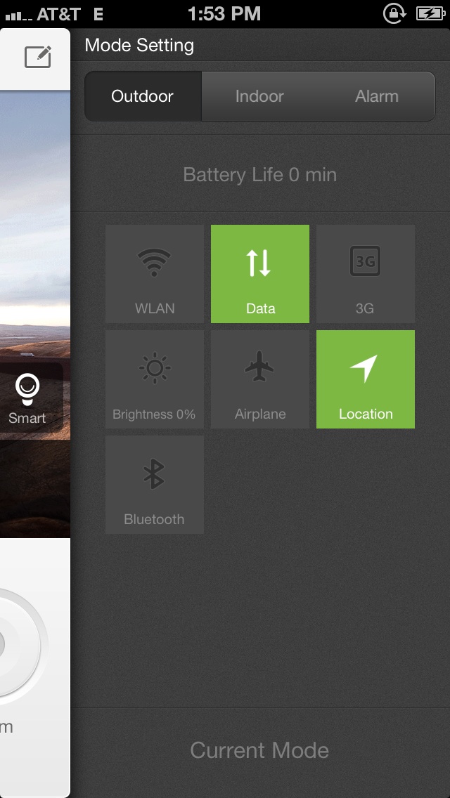

Hey guys I found a tweak that makes my iPhone 5 go into edge from lte!!
Batterydoctorpro!
