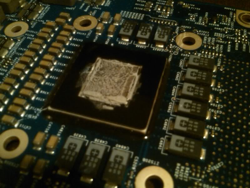

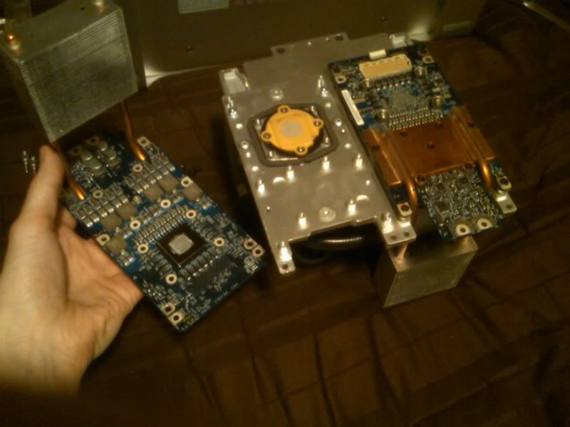

Got bored tonight and did the thermal swap. The old stuff worked, but it was hard and crusty.
I used Arctic Silver 5, it was all I had laying around. The pictures are of the old thermal compound, I didn't take pics of the new stuff.
This was pretty straightforward. If anyone has any questions feel free to ask, I'd love to help.
Temps seem to have dropped 2-4ºC. I'm idling at 36º give or take 1º now. Might improve after a few heat cycles too, who knows.
Apple uses enough thermal grease on one machine to do a whole fleet of computers lol. They definitely were not shy when they put it on from the factory. Lol
The pictures posted are not that bad in comparison to other Apple machines. Take a look at a MacBook or MacBook Pro.. it's bad. Sometimes there is so much it covers the entire chip, not just the die.

Yeah, I wasn't taken aback by the amount on my Powermac. It was decent. They could've done with a little less, but it wouldn't have made too much of a difference. There's always gonna be a little "squish" on the outsides of the chip.
