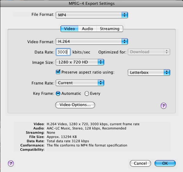

You're shooting in 1920x1080i.
You should export the movie to 1280x720i using the AVC codec (H.264).
What you are experiencing sounds like a settings problem, where your source video is interlaced, but you encoded the video progressively.
Set them manually to the resolution I suggested above, however, don't use progressive scan. Your encoded video should remain interlaced (the same as your source). A target bitrate of around 4,00kbs - 5,000kbs will give you very good quality, and a 2-pass variable bitrate (VBR) is best.
There are only two situations where you should encode progressively:
1) The source video is progressive, i.e you shot in progressive scan (i.e 1080p).
2) You de-interlace the source video, i.e remove the fields.
edit: However, AVOID de-interlacing whenever possible. It reduces the picture quality very noticeably.

Thanks for the advice - my export is running
exman,
So, I have started the export from Imovie project to .MP4 as suggested.
There is only 30 minutes of footage reporting that it will take 144 minutes to make the export.

Looking forward to your experience. I've been shooting with an HG20 and have been having a similar problem.
So, I used this alternate export process to make a .MP4 file.
On the iMac it looks good, but unfortunately it will not play on my PS3.
This encode method takes a long time, but the file, when viewed on the iMac does look better, problem now is the PS3 refuses to play it, even though it really should, as it plays other .mp4 files.

To play MP4 on PS3, you need to encode the audio on the MP4 using the AAC codec, alongside H.264 video codec.
good morning exman
So, I did mess up the encode. Thanks, I guess I can try it again.

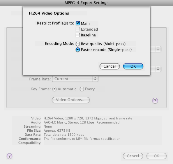

There is only one more settings I can suggest.
Click on Video Options, chose "Main" and "Single-pass". Your particular PS3 might not like multipass. Single-pass encode will be much faster, but won't produce the same picture quality as multi-pass.

exman,
Well, that worked. It seems it was the 'multipass' that caused the issue. Thank you very much for your help.
