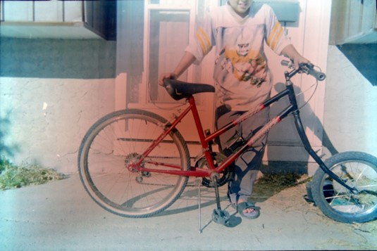

I am using a Fujifilm X1M with a adapted Nikkor 55mm f3.5 macro with a 21mm extension tube.
I am using a Logan 8x10 5000 Kelvin light box.
As of the last few days my negatives have a very orange cast in the middle. This has never happened before.
Here is a link to the raw image from the camera as well a edited negative in .psd file format.
https://drive.google.com/open?id=0Bw7r75MN3Zj6X2F6Rjc1T3B6Rk0
I have even tried Lab Mode which helps a bit, but the orange cast is still there.
Maybe my problem is I am placing my negatives on the Lightbox without a barrier between the Lightbox and the negative. I then flatten the negative with a piece of anti-glare framing glass.

That looks like a damaged negative to me. (I can't see the original as I can't connect to Google Drive from work.) It looks like the edges of the color shift run parallel to the image border. How were the negatives stored?

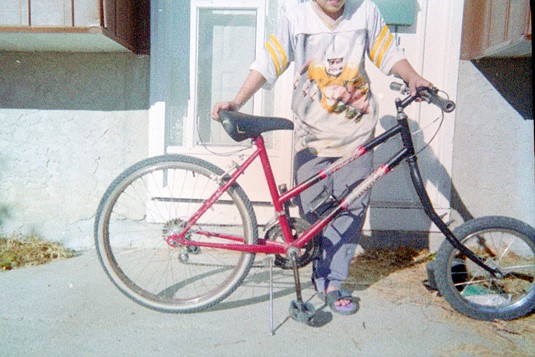

I have figured out the issue. It seems to be with my light source. With my Logan Electric 8 x 10" Slim-Edge Light Pad (#A-5A) it has two 5400K color-corrected fluorescent lights.
When I used my Sony Xperia Z5 as a Lightbox with a lightbox app I was able to get a image without the brown in the middle. The white balance with my phone was 3750K.

Captured using my phone's display as a light box at 3750K.
What shutter speed were you using when you shot with the Logan?
Shutter speed could possibly be an issue. In general, with fluorescent lighting you should never use a shutter speed higher than the AC frequency powering the tubes. With convention fluorescents that means 1/50-1/60th of a second. With "compact fluorescents" and with conventional tube using some electronic ballasts the frequency is higher than the AC supply, often allow shutter speeds over 1/500th.
IMHO, flare seems a more likely culprit, at least give the limited information provided by the OP. There is a massive difference between the size of the two light sources the OP has used. The large light box (8x10") will spill a massive amount of light unless the extra area is masked off. The small phone will not pose as great a problem.
I did not cover the extra light emitting. I will maybe cut out some back construction paper and try to keep the light from glaring everywhere.
Also, if you aren't using a completely enclosed "slide duplicator", you need to turn off all other lights in the room. Any light striking the lens side of the negative can reflect back into the lens creating problems/flaws.
