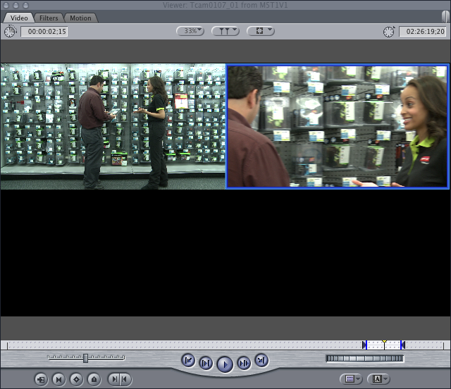

It says the Graid supports "multistream" prores. This is for a multiple camera shoot that the clips are multiclipped together so you can watch 2 or more angles simultaneously.. If you are not dealing with this, don't worry about it. The single drive won't work as well as the raid because the raid can access both disks independently and increase the speed but if you are going this route you'd be running it eSata anyway.
Multiclip:
