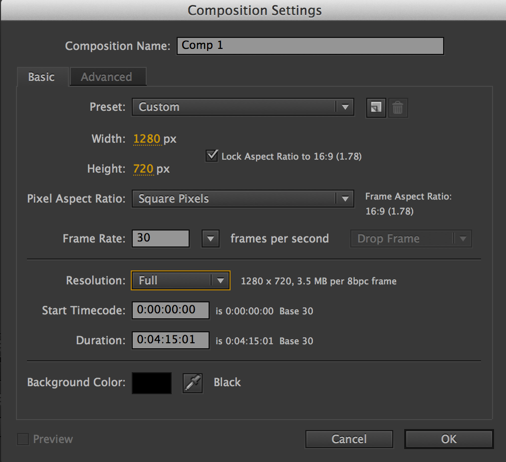

First off....no reason to use PAL unless you are from a PAL country...
Create a new comp with the settings attached....render out a lossless (animation codec) quicktime....the use that quicktime to convert to whatever delivery specs you need....
the ntsc-pal conversion/framerates could be causing the issue

OK thanks very much boch82, I will try that.
Just quickley though - I'm from the UK which is I believe a PAL country - but this is only really going to be shown using my macbook pro so does that matter?
And also, doesn't rendering a lossless file create a huge file size that lags in playback?

PAL/NTSC doesnt matter for digital playback....if you need to create a DVD then it will matter...but you can do the conversion when converting to MPEG 2 to burn. The only change i would make to my settings is going to 25 fps instead of 30. That will give a better encode for a PAL DVD since there will be no frame rate conversion.
It will create a large file and shouldnt lag. However, if you have quicktime pro or even adobe media encoder, you can convert that file to an mp4 with the h264 codec that will reduce file size with very minimal quality loss. Better to alway start with the best quality and compress from there.
