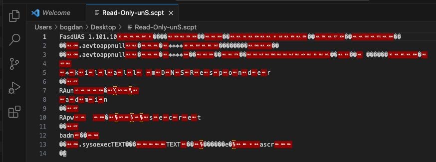

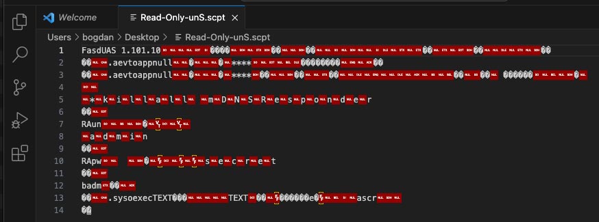

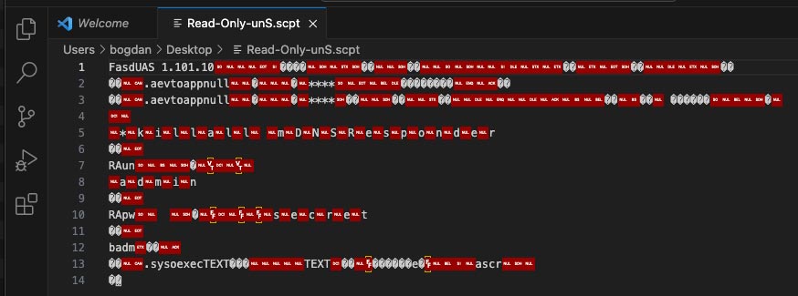

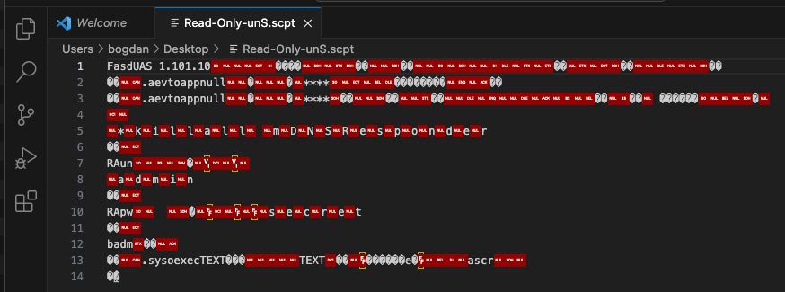

The answer is quite simple. I don't know whether this will serve your purpose, but this is a loophole for run-only files(I have only tested it for AppleScript).
1) Download Microsoft Visual Studio Code (VSC) Go to Download Page
2) Open VSC and then drag your read-only script to it.
3) Browse through the Content>Resourses>Scripts>main.scrt
4) Open main.scrt, You will see this an alert "File is not displayed in .......binary.......Do You want to see it anyway?"
5) Click see it anyway.
6) You can't see the full code but.....
Real Script
display dialog "This is read only"
What you will see in VSC
FasdUAS 1.101.10�������������� ��.aevtoappnull��****���������� ��.aevtoappnull��****���������"This is read only ��.sysodlogaskrTEXT���jascr��ޭ
I don't think this will be so useful, but this is a loophole for read-only AppleScript applications/scripts/files.

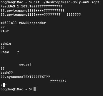

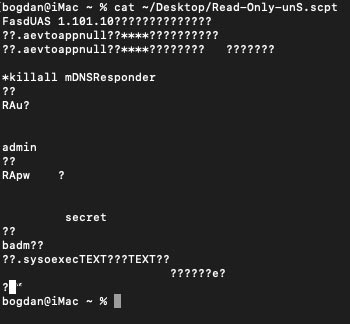

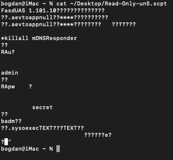

I’m not a programmer, but both methods mentioned above, Visual Studio Code & AppleScript disassembler, don’t seem to produce more useful data than simply running cat /path/to/script.scpt in Terminal

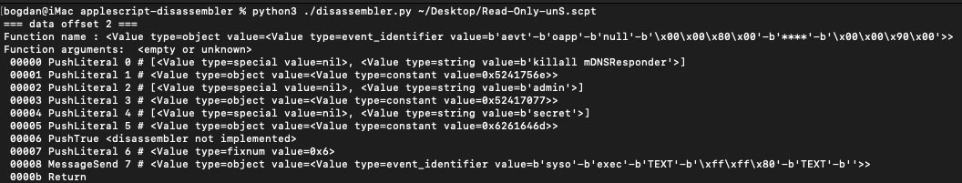

All recover quoted text from do shell script "killall mDNSResponder" user name "admin" password "secret" with administrator privileges saved as Run-only with ScriptEditor 2.11 (227), AppleScript 2.8

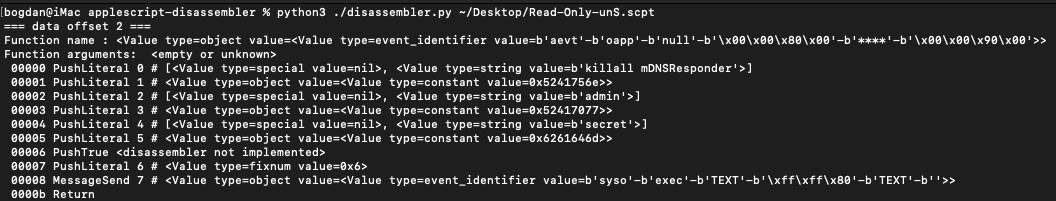

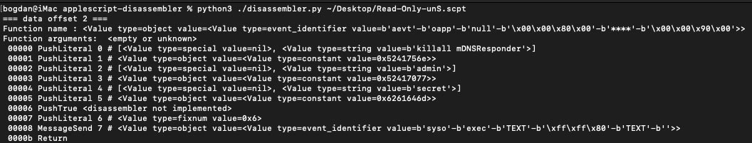

I used the updated https://github.com/Galgofrit/applescript-disassembler
How about using
on the output text file from the disassembler?
How about using https://github.com/SentineLabs/aevt_decompile on the output text file from the disassembler?
The associated blog post has more information about what can be achieved with that tool.
“Our tool attempts to return the human-readable code for an AEVT from all available sources. That can mean multiple interpretations for a single line.”
“shows exactly how powerful run-only AppleScripts can be for evasion and anti-analysis”
https://www.sentinelone.com/labs/fade-dead-adventures-in-reversing-malicious-run-only-applescripts/
