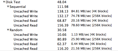

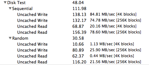

My stock Hitachi 250 GB hard drive's sequential write speed appears to be significantly degraded since the EFI 1.7 firmware update that Apple rolled out yesterday. I've run the test several times, and the results are consistent. Here are the Xbench scores, with pre-upgrade on the left:
I just did a PRAM reset, and it seems to have fixed the slow speed. The speeds now match the pre-upgrade speeds. I should have tried this before posting.
