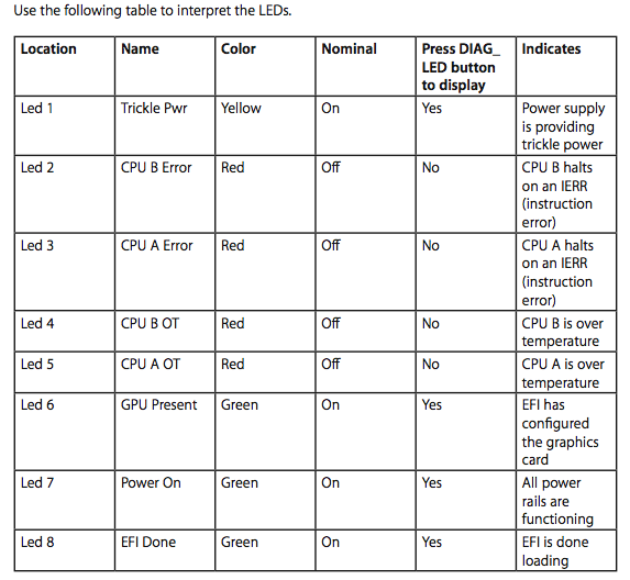

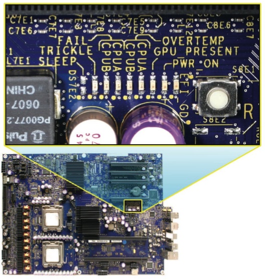

Update from the Mac Pro service manual:
Diagnostic LEDs
The Mac Pro logic board includes a set of LEDs to help service providers troubleshoot the
computer. The LEDs are located toward the rear of the logic board, under the memory cage, next
to PCI card slot 1. You can view these LEDs by removing the computer’s side access panel and
looking through the memory cage to the logic board below. LEDs 2, 3, 4, and 5 are normally off
and will automatically illuminate if an error occurs. To read LEDs 1, 6, 7, and 8, you must press the
DIAG_LED button, which is adjacent to the LEDs. To press the DIAG_LED button, use the nylon
probe tool (Apple part number 922-5065).
LED 2 CPU B (Lower Processor) Error
LED 3 CPU A (Upper Processor) Error
Normally off. These LEDs come on if an error occurs or if the BootROM is corrupted. They do not
depend on the DIAG_LED button being pressed.
Related symptoms include no video or the computer is hung up. If the BootROM is corrupted,
the optical drive tray should eject, prompting for the insertion of a recovery disc to restore the
BootROM.
Press DIAG_LED button with something non-conductive and see if rightmost LED lights up green. If it does light up then EFI startup process has finished without errors.
