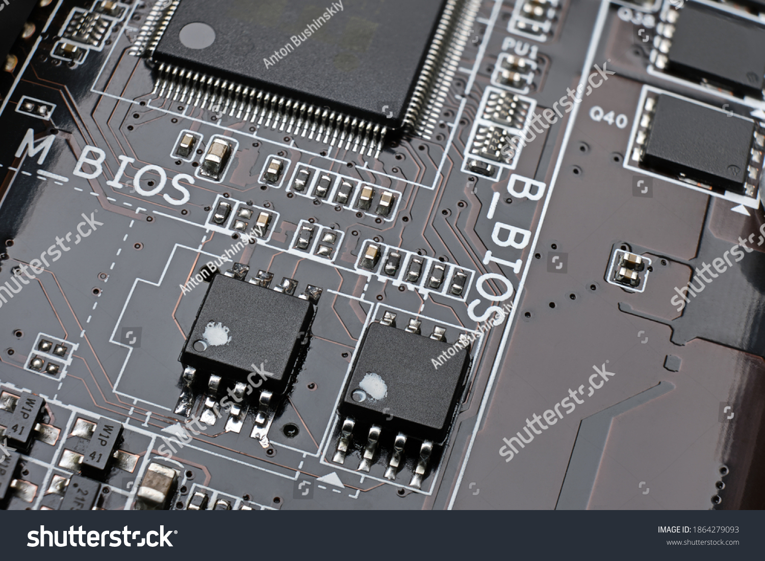

The Medusa comes with an attachment that can clip onto some bios chips. Doesn't your imac have one of these bios chips? (see pic. the pic is only and example of what the chip would look like)
Correct! So it doesn't clip onto the thin iMac (A1418 & A1419) motherboards. It does do to macbook BIOS chips..

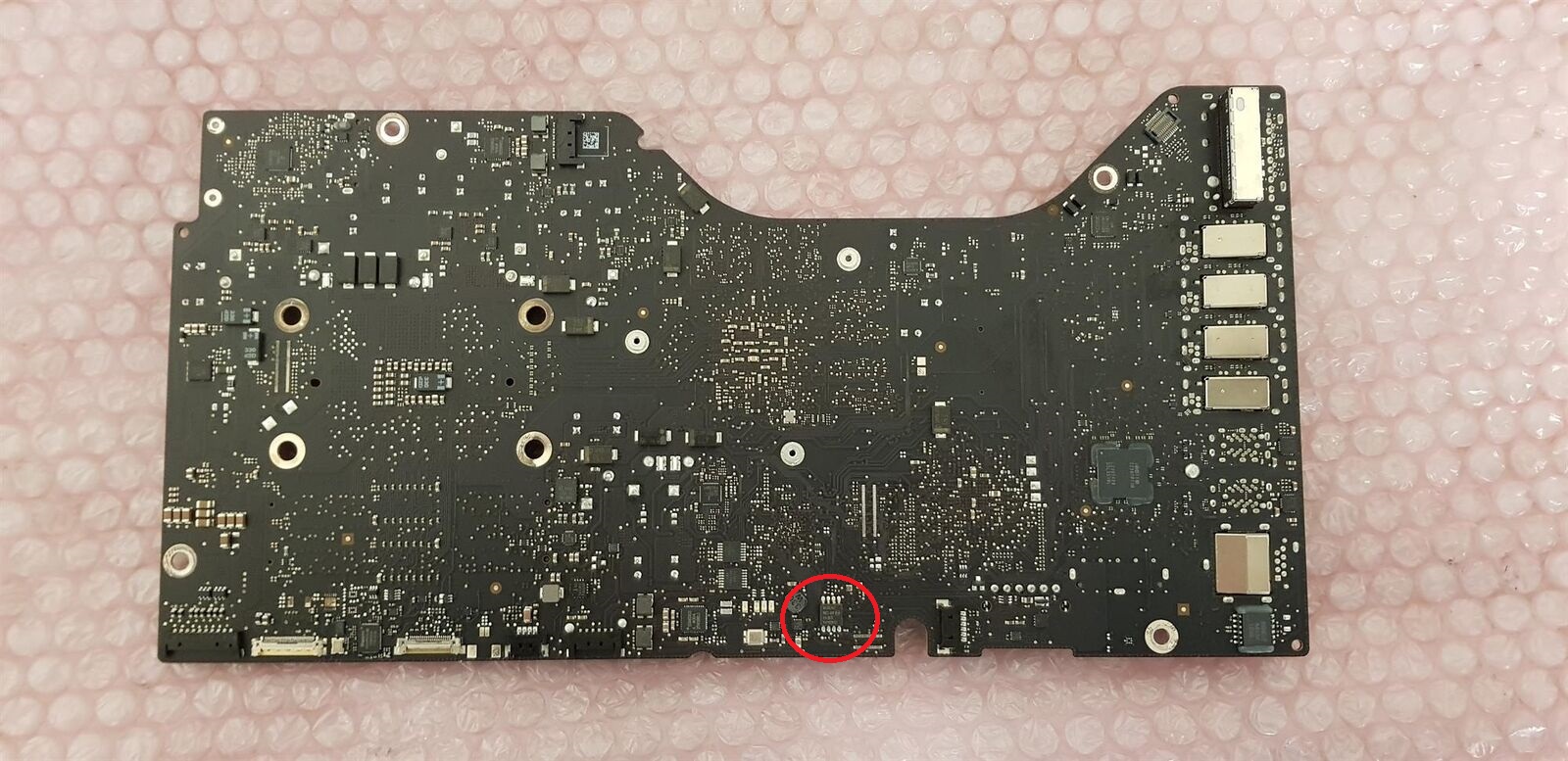

I just looked at an online pic of an A1418 motherboard and noticed where the bios chip is. I can see it is one of the flat chips that one would normally have to remove but I notice in the pic that the solder pads leading to each pin are accessible but it would need a special adapter to fit it. I know the guy behind CMIZapper made such an adapter for his own use but was planning to make them for sale but not sure if he has. Might be worth asking him if he has such an adapter available.
@laptech so as promised letting you know how the meeting went. Turns out Medusa works perfectly well with this machine and removing the motherboard was not even necessary. The Medusa clamp hooks onto the BIOS chip and within 15 seconds the firmware was flashed. Problem solved.
