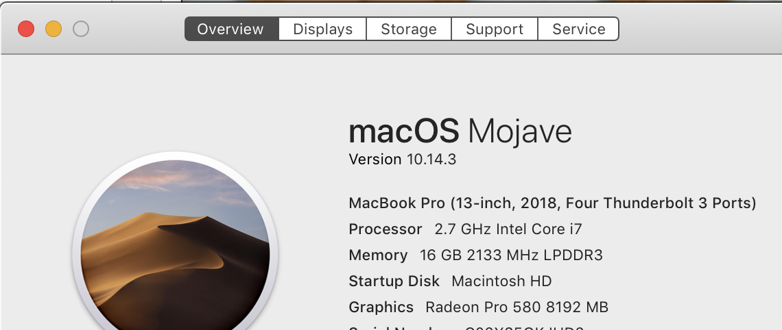

Hmmm. Here is a picture of my "About this Mac" with the lid open. Unless I'm missing something it does seem you have a problem.

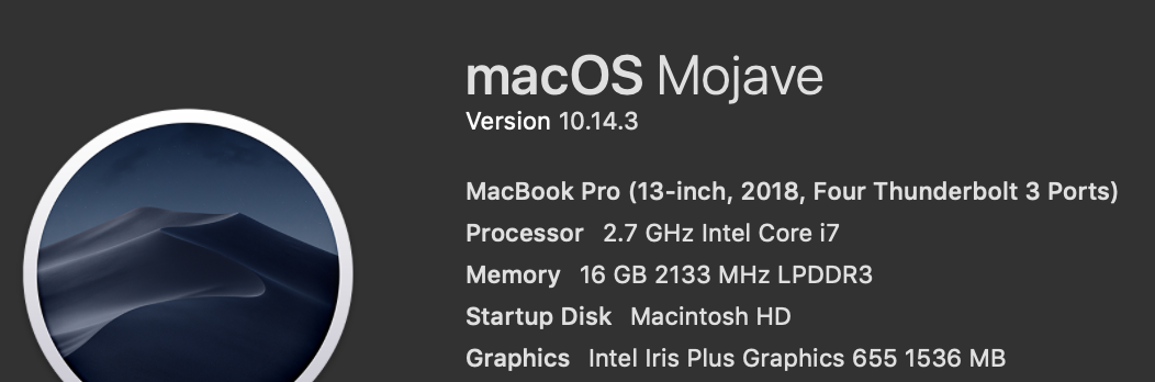

Weird. I just did this. Running clamshell and I'm on the Radeon. I then open the lid, and I drop to the Iris.

Hmmm, okay well I did some experimenting and found that with the lid open, even though my "About This Mac" says Intel, it's only using that for the internal display. So if I look at displays, it shows the internal running on intel iris, and the external using the eGUP. The GPU activity monitor bears this out showing activity with both chips. So, that at least clears that up. I know there is a script out there that can force the eGPU to drive the internal too, and I may go that route. Thank you for the assist!
