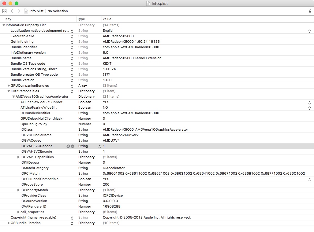

HEVC encode and decode support for Vega GPUs is shown in the AMDRadeonX5000.kext driver.
im glad someone finally mentioned this 🙂
I also believe the hackintosh guys have been able to add these strings to the Polaris kexts and get HEVC on the go there as well but dont hold me to that
I do wonder very much if Vega HEVC decoding/encoding works with a Vega Card in a 5,1? or if Apple is only allowing it on the iMacPro1,1 somehow currently...

I suppose I could test it, but there’s no indication Vega HEVC wouldn’t work on the cMP. The driver lists the device ID for the card.
