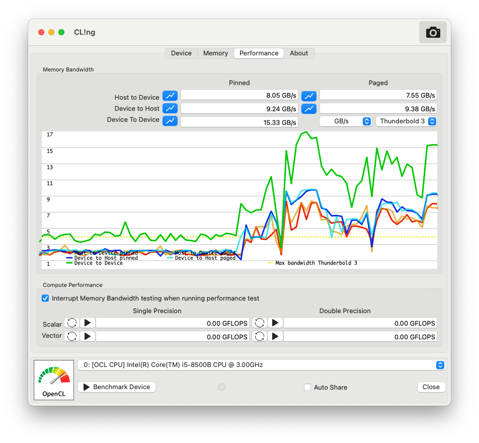

Is there any way for me to aplha/beta test the throughput of the Tbolt controllers? Or get a number to see if there is some throughput for a bit of data on the eGPU controller?
CL!ng.app has a Performance tab which shows memory bandwidth numbers. See examples at egpu.io website.
If your GPU is starved of data, you can increase the resolution so it idles less without loosing much fps.
All right. Can anyone explain what I'm looking at or how I can figure out if the Tbolt controllers are fully loaded?
If I remember correctly, there may be times during system updates where your Mini won't get along with the eGPU. Just keep that in the back of your mind and bypass it using one monitor to get through the update/s.
Click the Device To Device graph button to hide that line on the graph.
Change GB/s to Gb/s or MB/s to measure Gigabits per second or Megabytes per second.
Change the GPU in the bottom menu to the GPU that is in the eGPU enclosure, choose either Metal or Compute.
A Thunderbolt 3 eGPU should have memory bandwidth of ≈22 Gbps or 2750 MB/s.
https://egpu.io/forums/mac-setup/monitoring-thunderbolt-bandwidth/
Similar benchmarks on PCs can be provided by CUDA-Z or by AIDA64 GPGPU Benchmark.
But how can I use Cl!ng to determine if there is more bandwidth on one of the tbolt controllers?
