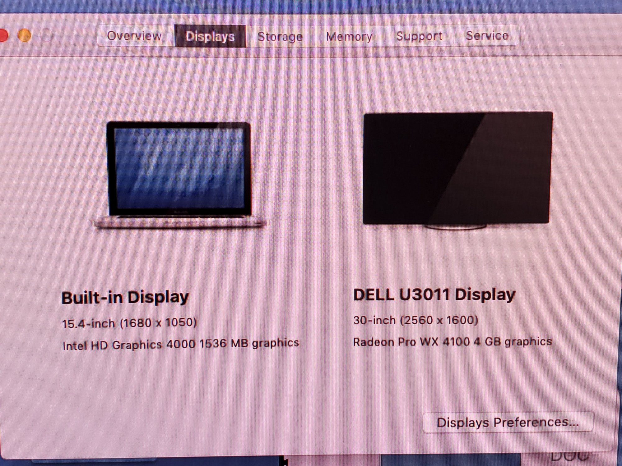

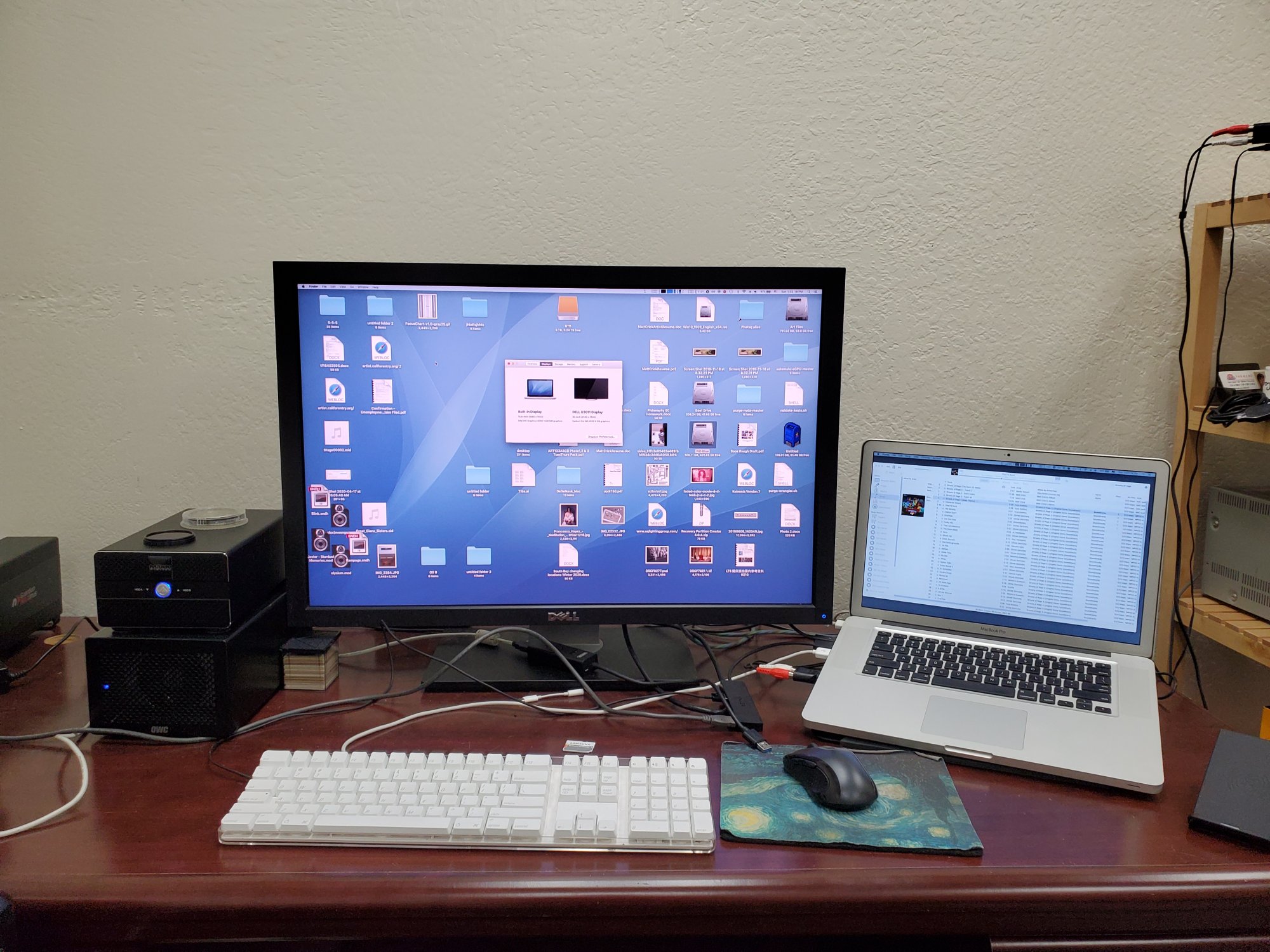

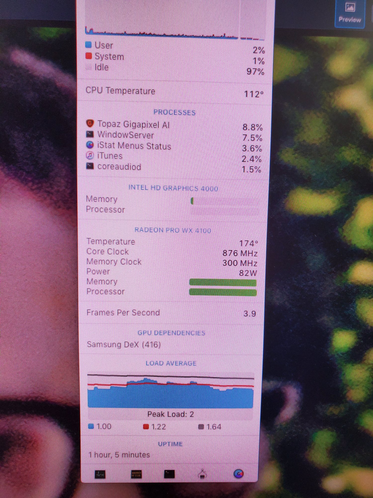

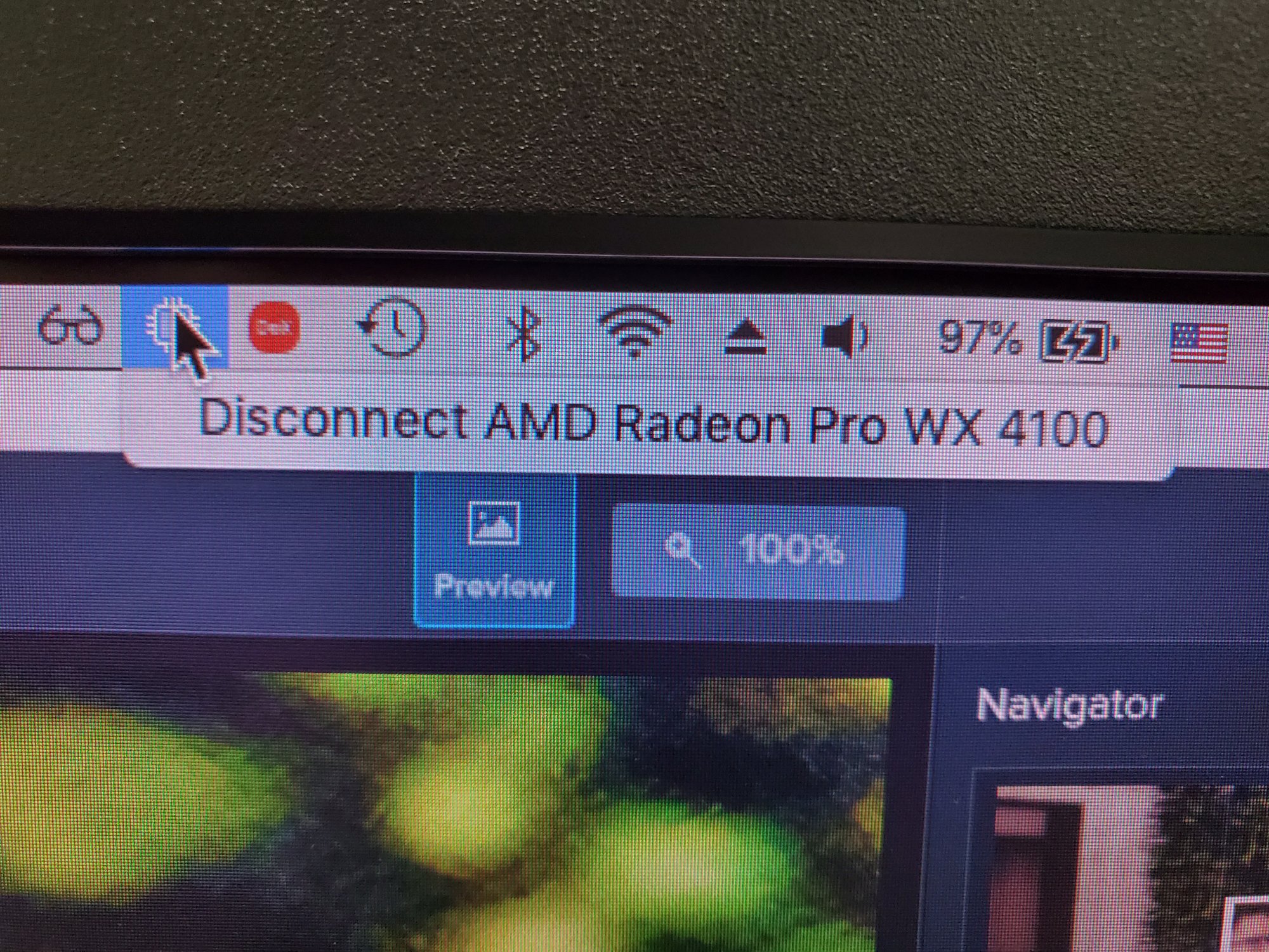

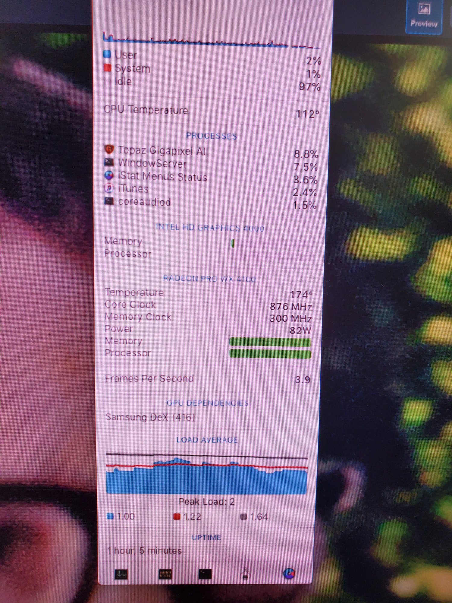

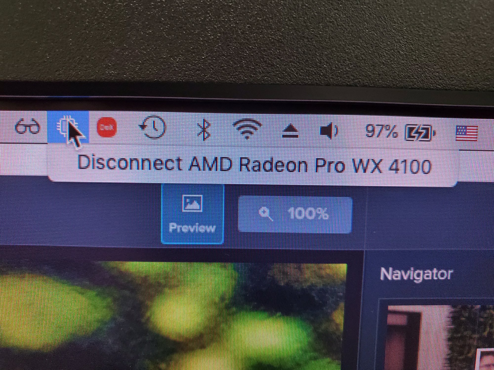

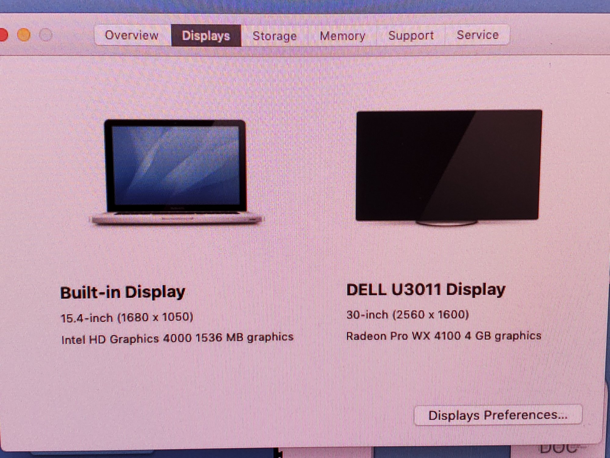

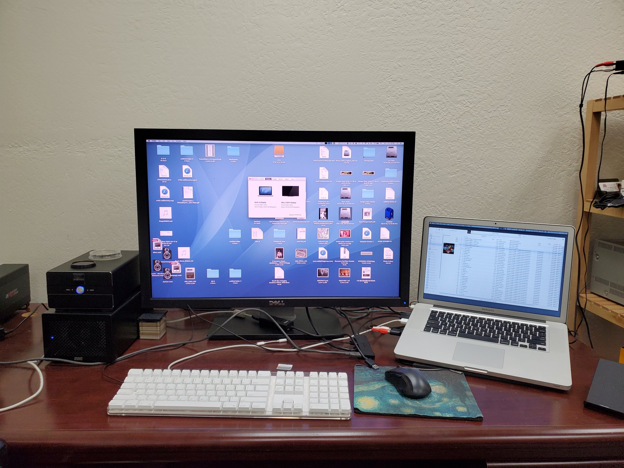

I ran an eGPU on my 2012 MBP in my studio for about a year, very cheap if you know what you want and need. I was running a Dell U3011 which is only 2560x1600 and not 4K.
I used an AMD WX4100 and OWC Helios Thunderbolt 2 enclosure. Both can be had used for under $200.
Check out egpu.io for all the info you can ever need on the subject.

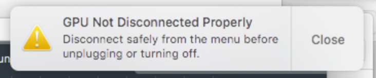

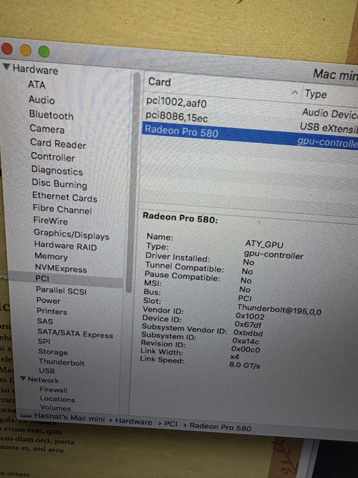

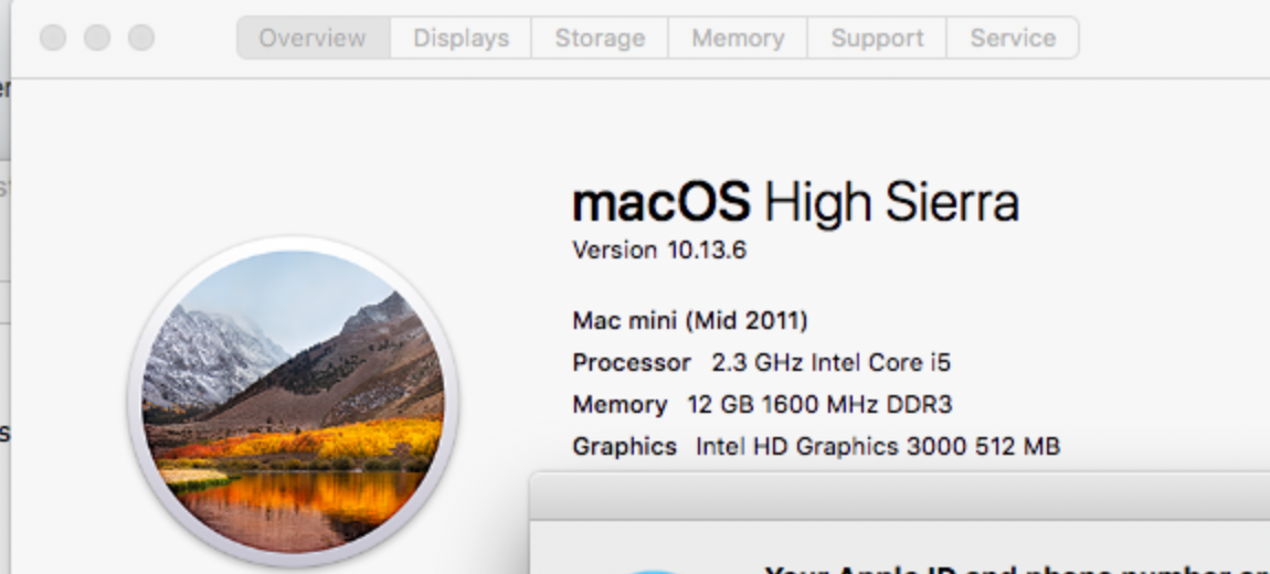

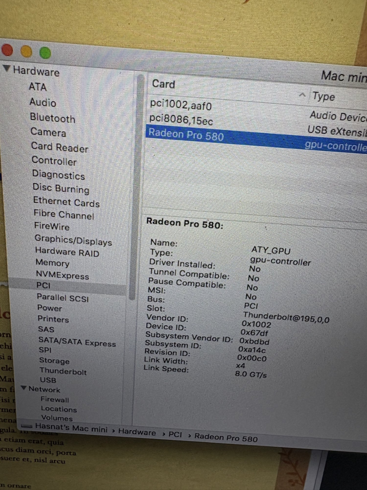

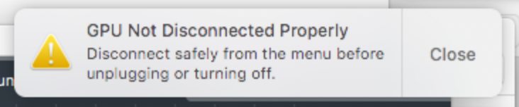

atleast the pair I own recognize but don't talk to each other; I tried the Radeon Pro 580 egpu with mac mini 2011.
No new gpu history popped up in activity monitor (cmd+4); no monitors worked off egpu. funny it says disconnect message but I never got the menu.
