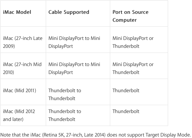

Then I was thinking, I have 2013 iMac 21.5" (i5, 8gb, GT 750m), is it possible to get a thunderbolt adapter and just use the 7870 with the iMac? I'm gonna be running on windows 8.1.
Also could I use the internal iMac display?

I think it can. But I believe you'd use a DisplayPort connection from a PC. I've been doing that for about three years with my 2009 27" iMac. I have a Windows PC and when I play games I switch my iMac's screen to the Windows PC.
I know it's slightly different on newer iMacs with Thunderbolt. But AFAIK the only iMac that doesn't support Target Display Mode is the new Retina iMac.
The 2009 model is different, and the latest iMac that can be the Target Display for other PC is the 2010 iMac. AFAIK, the rule was changed when Thunderbolt introduced.The following is quoted from Apple webpage.
"Support for Target Display Mode via the Thunderbolt port using a Thunderbolt to Thunderbolt cable (sold separately)"
I didn't own this iMac, but other members' posts also show that it only works with Thunderbolt now. I wish I am wrong, but still no successful case to show that a Thunderbolt iMac can be a Display for other PC yet.
