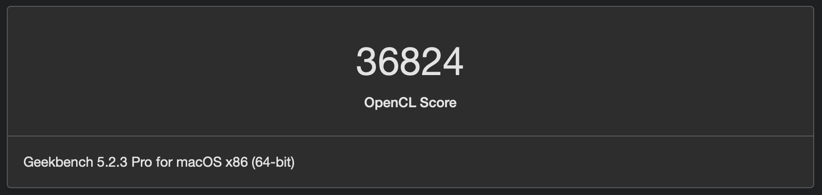

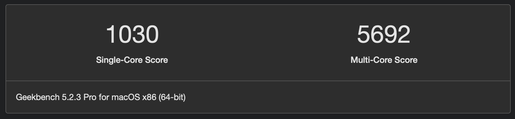

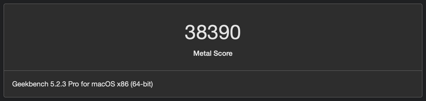

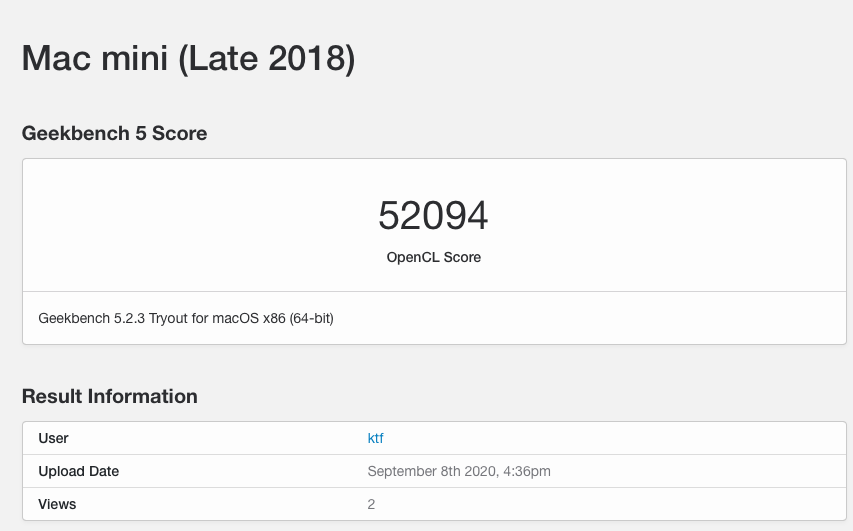

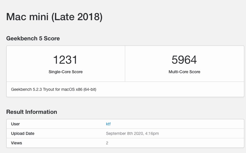

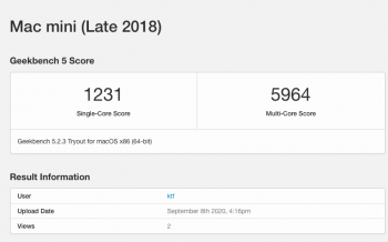

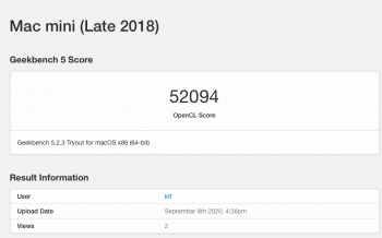

For the heck of it, I ran Geekbench with my new Sapphire eGPU. The results were definitely an improvement over my previous setup.

e.Screen Shot 2020-09-08 at 4.38.14 PM.pngScreen Shot 2020-09-08 at 4.38.42 PM.png
