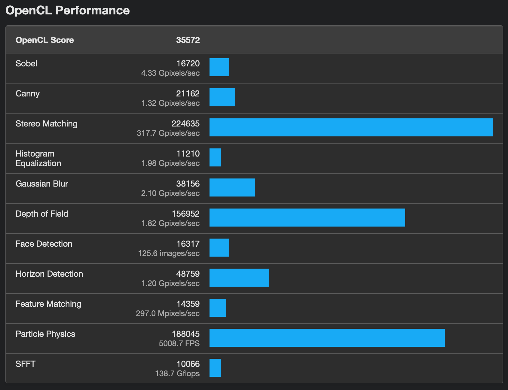

Your Geekbench test caught my eye. My CPU scores are nearly identical. But my Open CL is about 36000, way behind yours even though I supposedly have a more powerful eGPU (the Radeon RX 5700 XT). Maybe the Sonnet with an older card was the way to go after all....

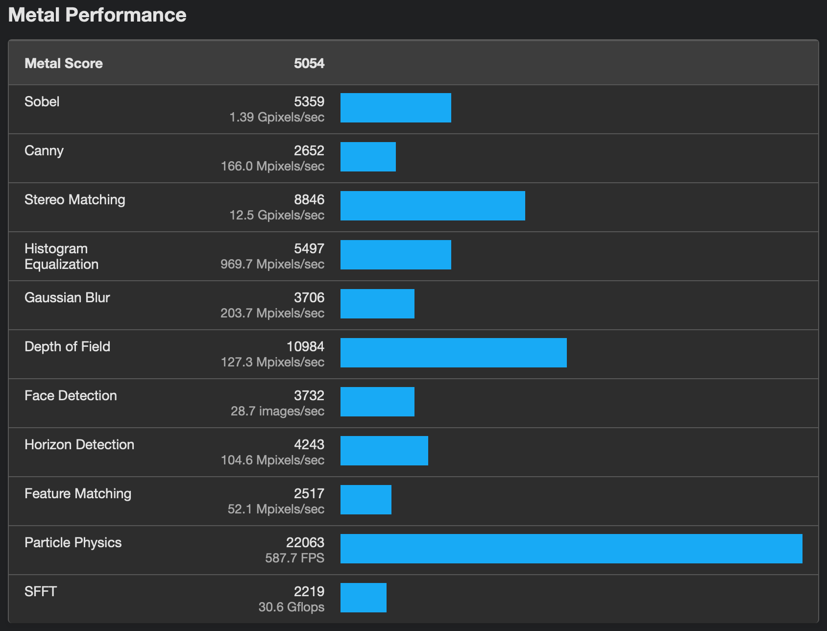

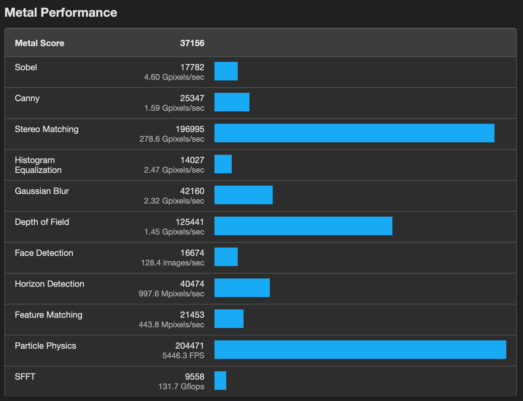

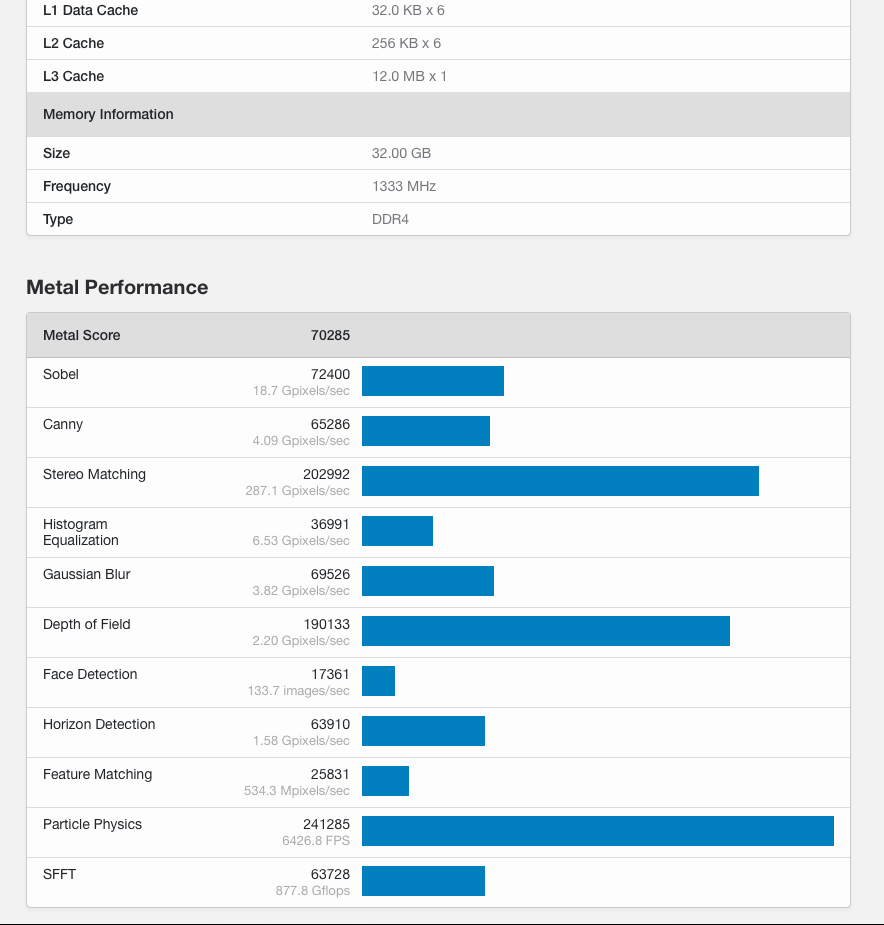

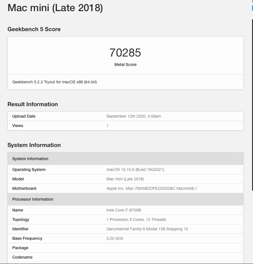

I guess my eGPU is doing its job. I just ran a comparison Geekbench for the built-in Intel UHD 630 and my Sapphire Radeon RX 5700 XT eGPU. The Intel is first.

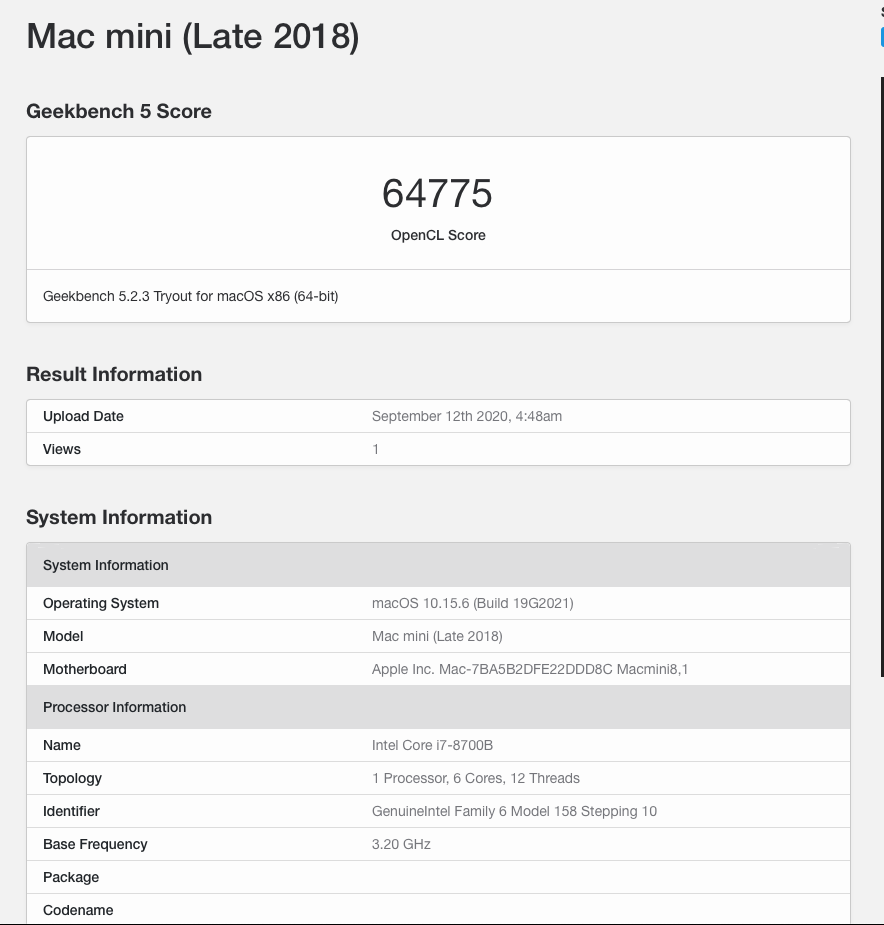

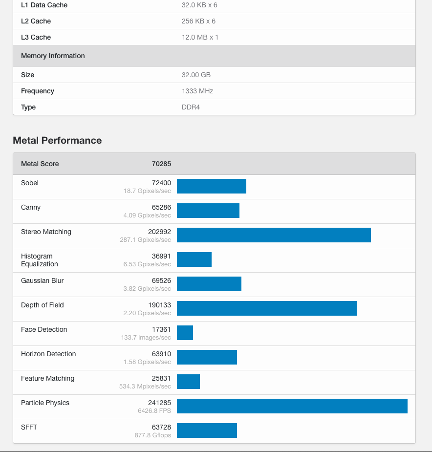

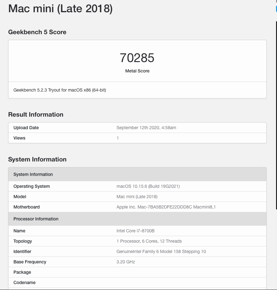

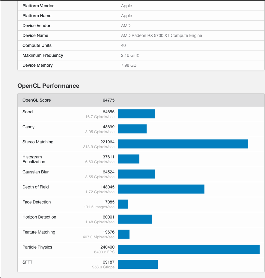

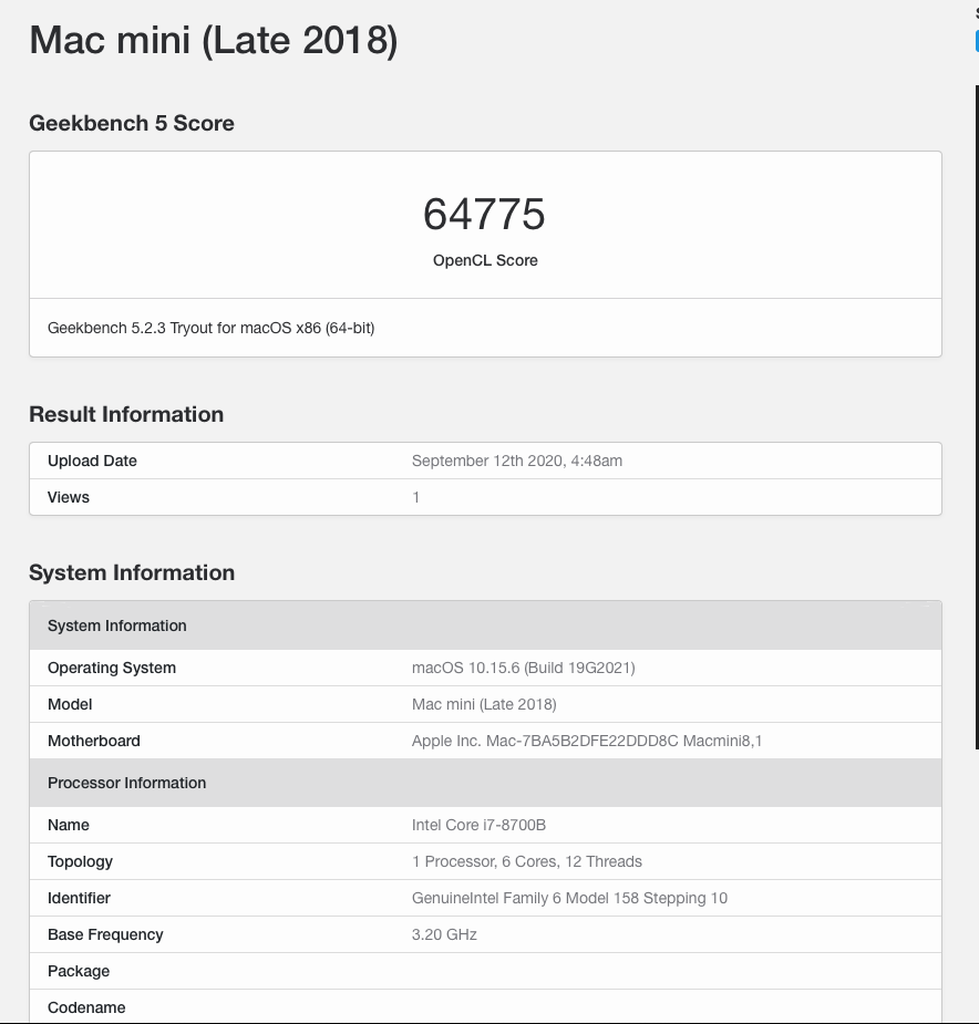

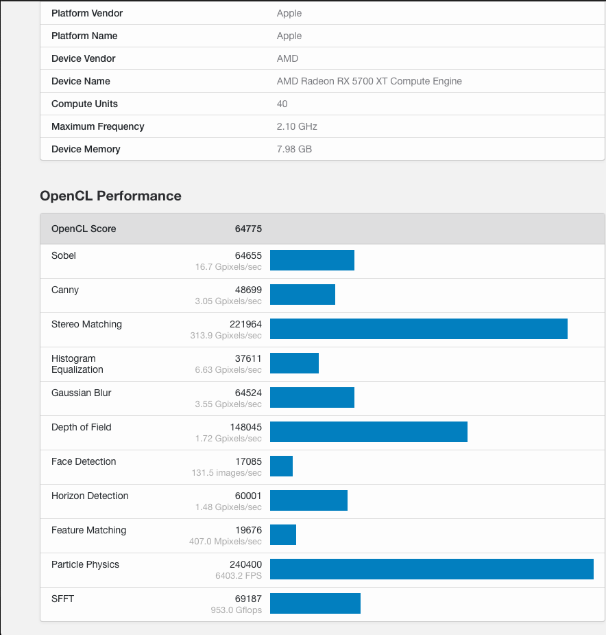

Had a few Kernel panics earlier this week forcing me to do a few hard restarts. Looked to be a one or more Third-party kernel extensions causing the problems. Got a little proactive and did a reformat / clean install of Catalina 10.15.6 with the Supplemental Update. All seems better now except that I'm back to using the second monitor for a boot screen. In any case, I'm really happy with the eGPU and the Mini. I on the other hand think Catalina is one of Apple's worse releases of an operating system in a long time. This was my third clean install of Catalina. The amount of time spent on hacking this OS is immense. Hope for greener pastures with Big Sur. Ran Geekbench 5. The results are better after the OS Re-install.
Red Devil RX 5700XT>OWC Helios FX 550
Screen Shot 2020-09-12 at 4.58.25 AM.pngScreen Shot 2020-09-12 at 4.58.48 AM.png
Screen Shot 2020-09-12 at 4.49.03 AM.pngScreen Shot 2020-09-12 at 5.15.46 AM.png
Red Devil RX 5700XT
View attachment 952210View attachment 952211
View attachment 952214View attachment 952215

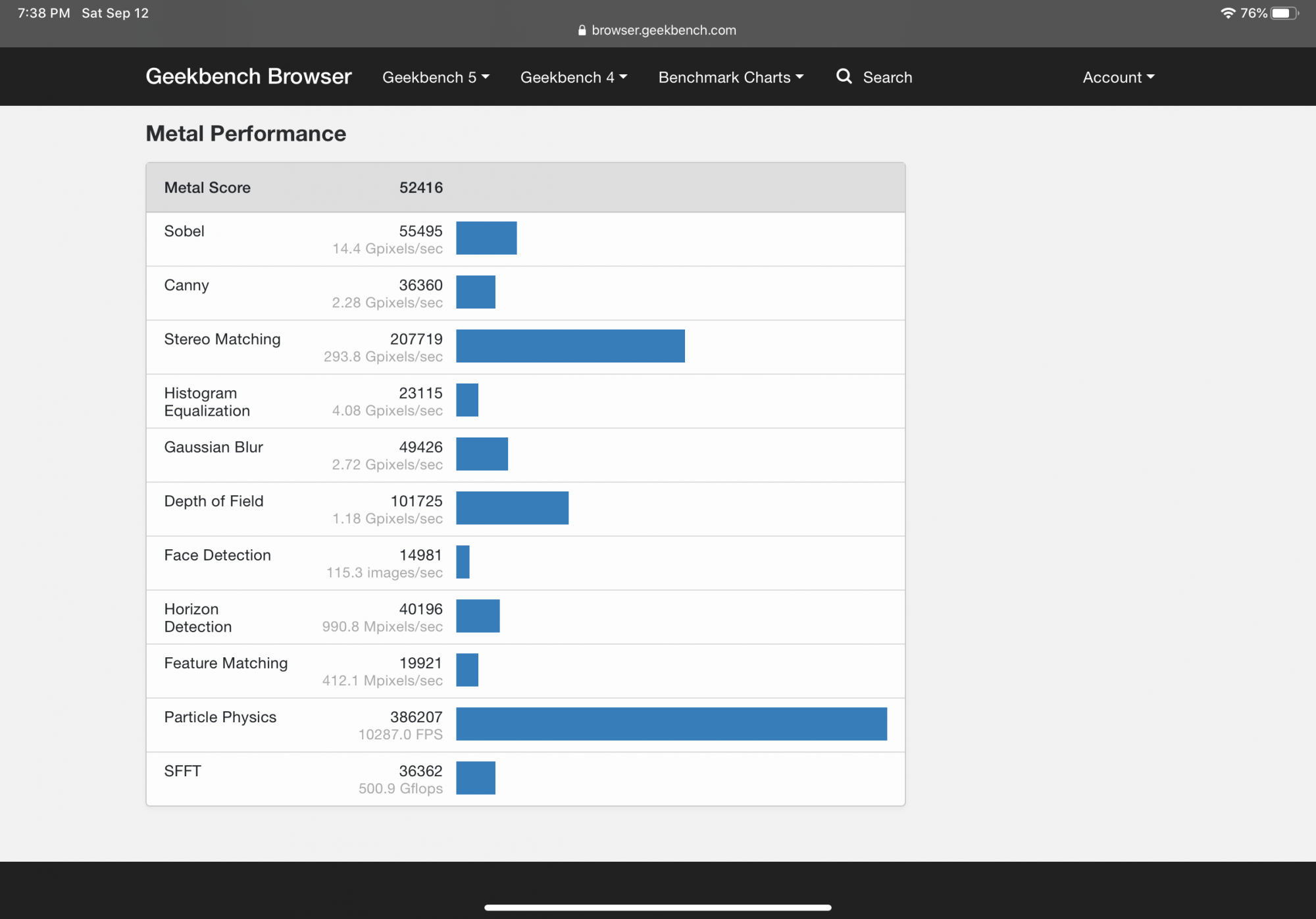

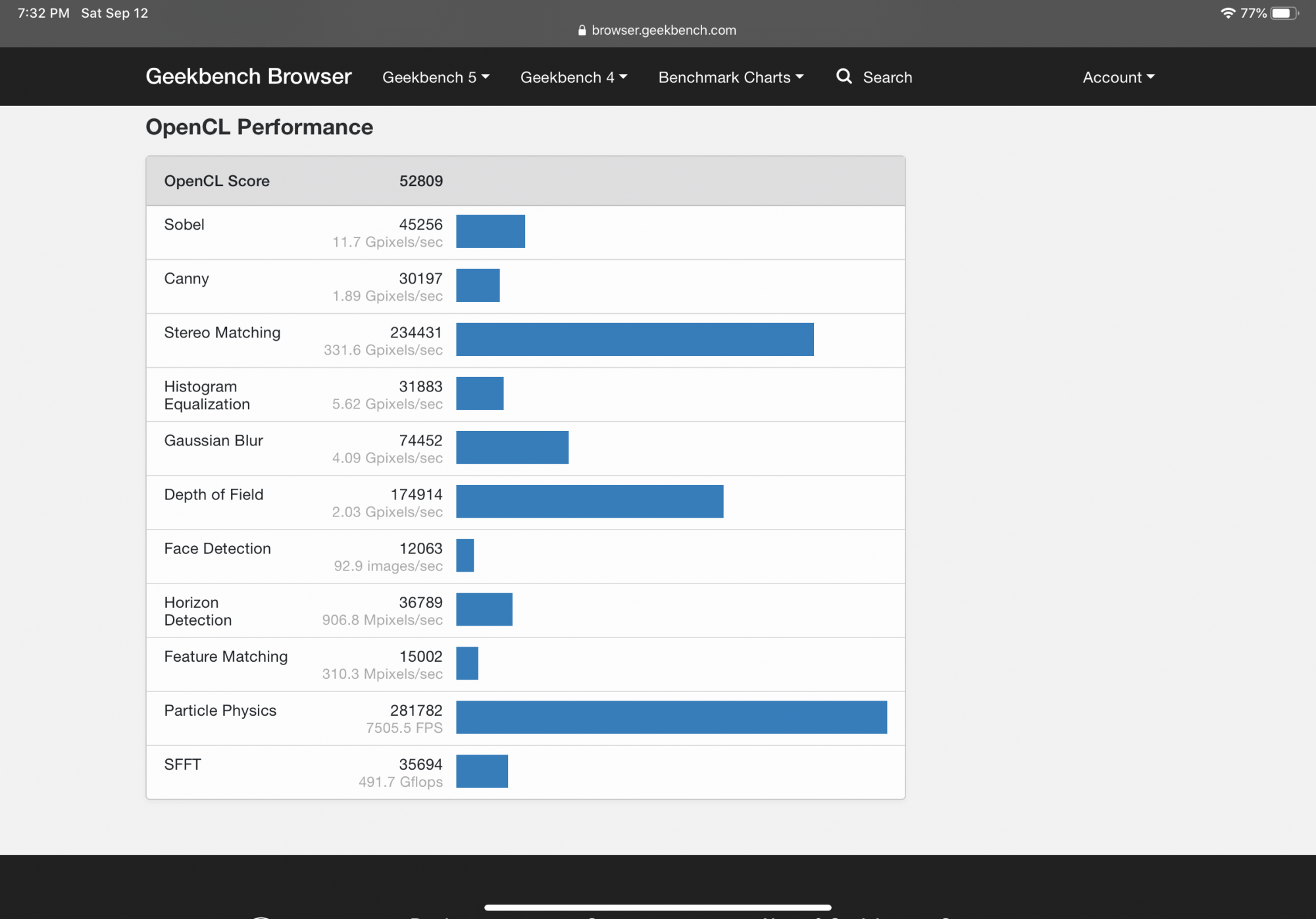

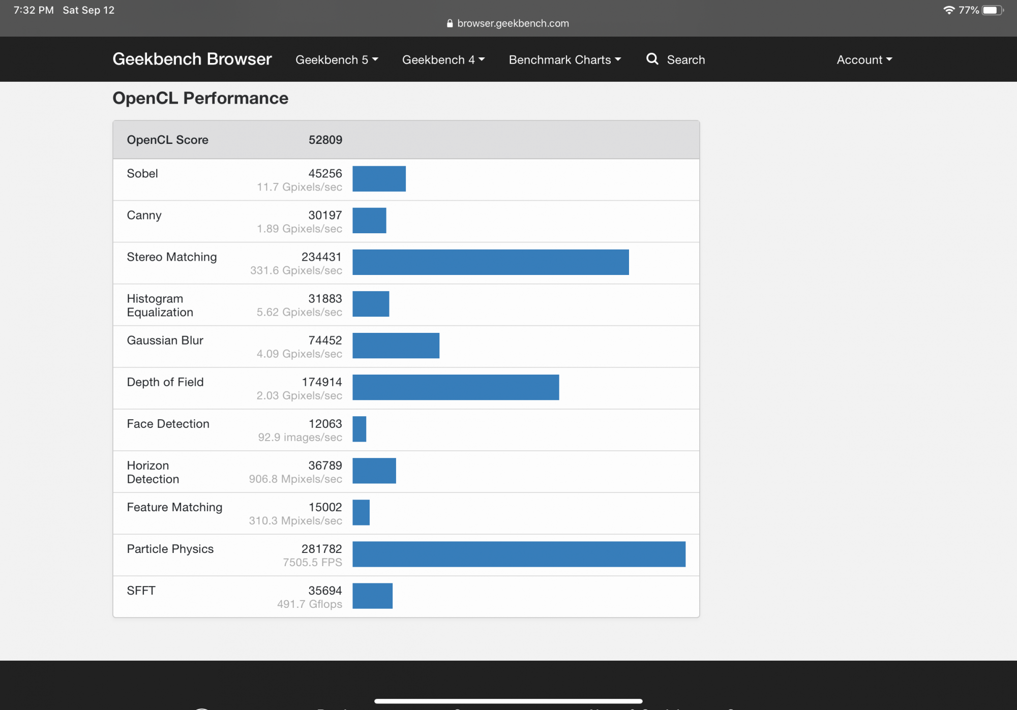

Those are some nice scores @Meatsuit . I am hitting 52,#### for Open CL and Metal on my Asus RXVega 56 in a Asus Station Pro XG box. Funny how my Metal has never outshined Open CL like some other cards. What eGPU enclosure are you using?
You should definitely be getting higher values.
I get 50000 metal for my RX580 on my macpro.
Sounds like the enclosure plays a big part.
That's a very good number.
My RX570 only gives me 33,000 metal and Open CL. But it's only 4GB VRAM.
Running internal RX580 on the MacPro is why his score is so much better than the enclosure on a Mac Mini. I had the RX580 card in a Sonnet 550 and was not that high. I think the hi 30,000’s.
Running internal like on a iMac or MacPro will yield higher results.
But yes @jayducharme has an issue with his setup obviously. And should be achieving well over 50,000 scores on compute.

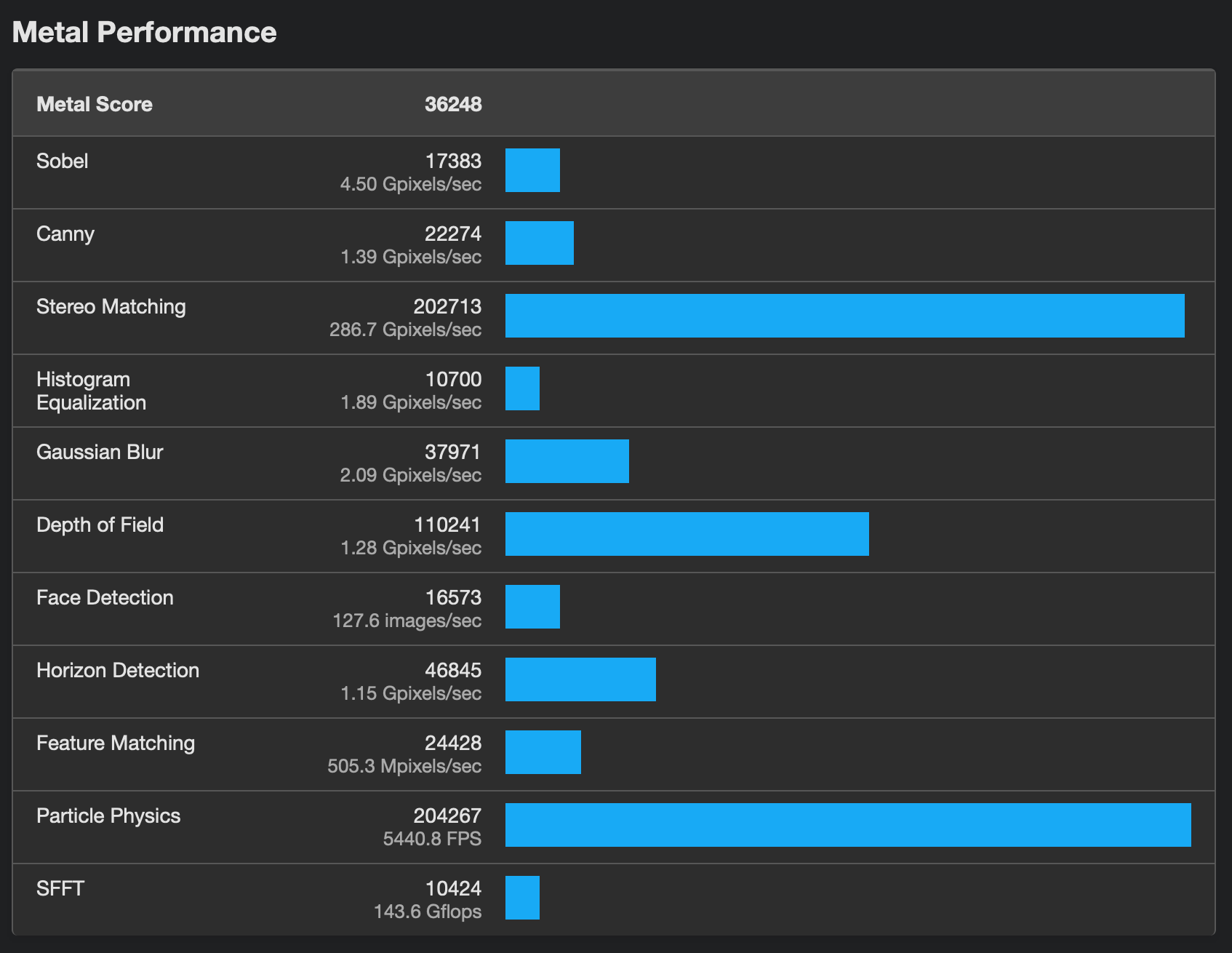

Here's yet another update. I just got my Sonnet Breakaway Box 650. I got everything hooked up with the new TB3 cable that came with the Sonnet and ... no change. My Geekbench scores are pretty much the same as before. So either Catalina doesn't like the Radeon RX 5700, or my Mac mini is defective somehow. I know I should be getting better scores than this.
Was reading a thread in the Macpro section, and someone mentioned you would get a much higher result in Mojave. Apparently the Catalina gpu drivers arn’t too good.
So in other words, I didn't have to buy a new eGPU enclosure. It was the fault of the OS. Great. 🙄
