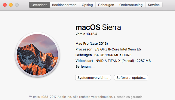

I got my Asus ROG XG Station 2 today. Plugged in the NVIDIA Titan X Pascal. Under Windows it almost is like plug and play, works beautifully. Then I connected it to my Mac. This took a bit more time, with one problem which is probably particular to this specific enclosure. In the end I got it working it and it works fine now.
Unengine Valley Benchmark gives me 71,8 fps on Ultra (2560x1440). Resolve recognizes the card with no problem and seems to work just fine.
I only have D300 cards in the Mac Pro, so this is quite an improvement.

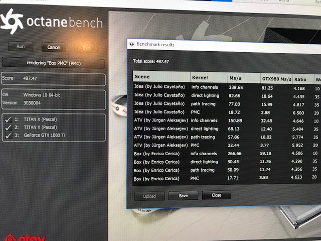

I just bought a 1080 Ti and plugged the Asus expansion into my HP Z840 workstation, which already has 2x Titan X. This also works just fine using TB2 and the Apple TB2 <-> TB3 adapter. Now 10.000+ cuda cores at my disposal. 😱

Do you have Octane benchmark scene ms/sec and the Luxmark 3.1 score for your 2 + 1 eGPU set up? Just for a comparison to my 3 GPU internal set up.
Reactions: googy
That's already close to my internal 3 GPU at 64499. Can you also run the Octane bench mark scene with the object rendering with ms/sec? I guess should be very close to 90-95ms/sec.
Will look at the octane bench tomorrow.
Here you go. Noticed I had downloaded octane bench before.
Thanks for the sharing. It's amazingly fast in rendering with over 10,000 CUDA cores. We have two cards exactly the same: one Titan x Pascal, one 1080 Ti, but mine third card is Titan X Maxwell. Your Octane benchmark could reach 100ms/sec. I don't know if eGPU make deviation every time you test it, but they are in ball park.
