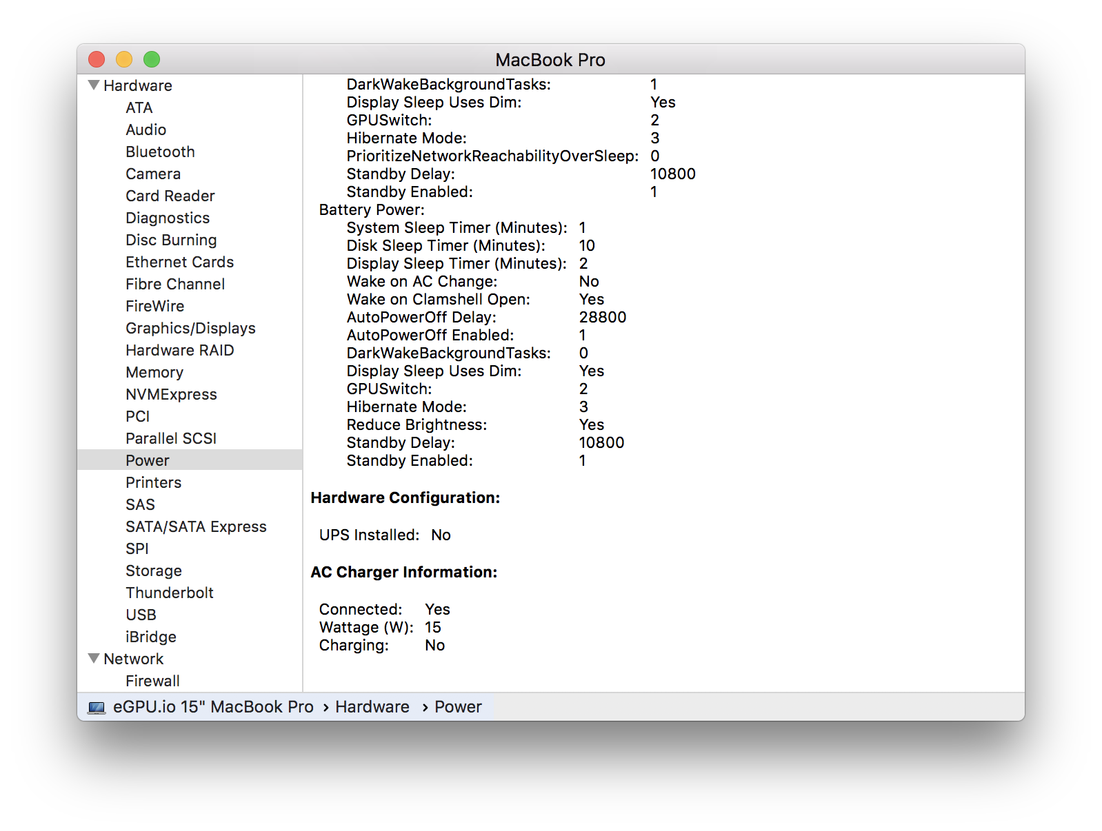

Apple's release note is not entirely accurate. It states the Sonnet Breakaway Box in this kit has a 350W power supply. I'm using this very same enclosure and can tell you its power delivery is only 15W; not 60W PD as the Apple document shows. Unless Sonnet has a newer Thunderbolt firmware, Sonnet Breakaway Box 550 version is the one provides higher PD.

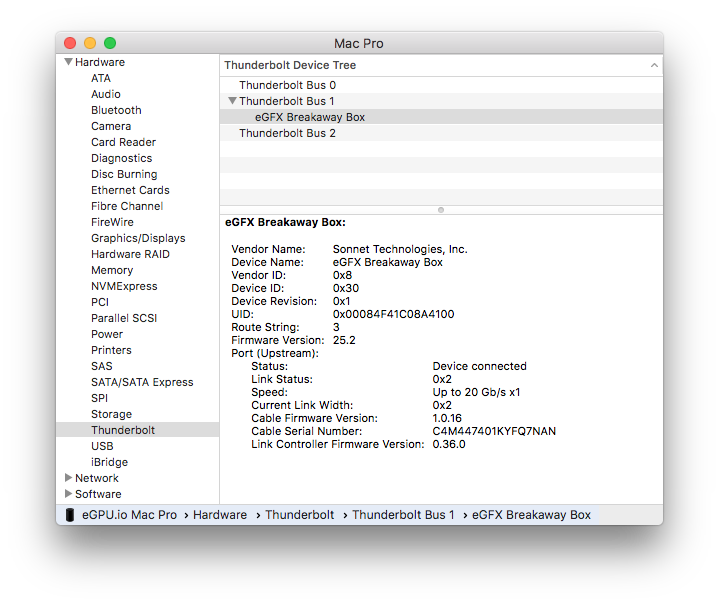

It's a possibility through firmware revision they can squeeze 60W PD out of the 350W PSU. I hope your guess is right because that would make a very nice box. The Thunderbolt firmware version on my Sonnet box is 25.2, just in case people who get these dev kits want to compare notes.

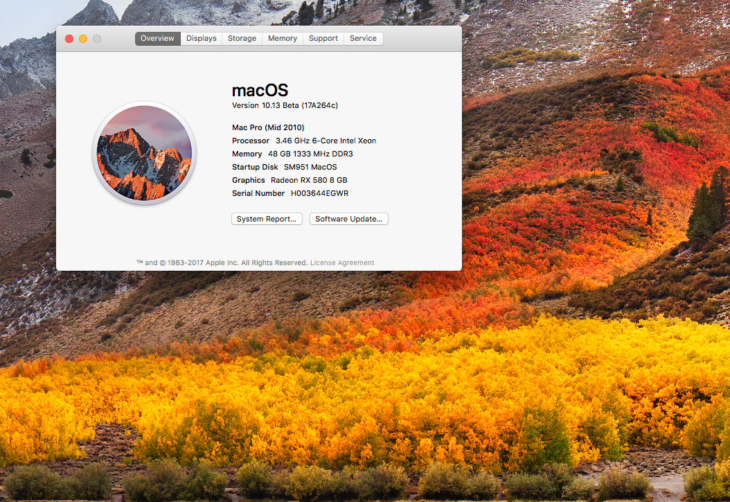

macOS froze during boot. System fans ran full speed then locked up. Apple really wants us to stop using this Mac Pro tower. I'm doing some kext editing and we'll see.

The Sonnet Breakaway Box 350 only provides 15W of power delivery btw. The 550 version is the one that can charge MacBook Pro. It has 60W PD, good enough for 13" MBP, slow for 15" MBP. Currently, the Mantiz Venus is the only eGPU enclosure with 87W PD. If you want to build your own Metal 2 external graphics development kit, take a look here.

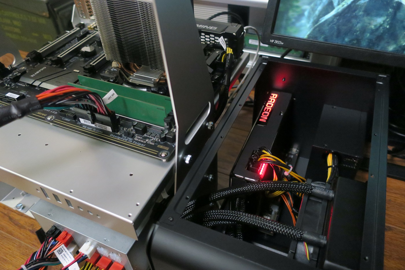

This is next on my list. 10.13 has proper drivers for Polaris 10 GPUs. However, Apple threw a wrench in there for us Mac Pro tower users. When I booted with the RX 580, the progress bar would get to half way (seen through GT 120) and system fans ran full speed and eventually hung.
It's much better with eGPU enclosure though. Recovery mode actually works through the RX 580 eGPU. Here's a user with an older TB2 13" MBP using an AKiTiO Node + RX 480 + Dell 4K monitor.
