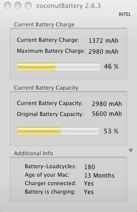

I've recently run into an unusual problem. my MBP is powering down, without warning at around the 45% charge region. It quite simply gives up, doesn't tell me i'm running out of power, shuts down and refuses to boot unless it's plugged in.
My question therefore is, is my battery completely screwed? Why does OS X think it's 45% full when there's blatantly f*all charge remaining and, will applecare cover a replacement? i've got 2 years remaining..

Sounds like a bad battery. Apple's warranty on their battery's is 1 year and independent of the AppleCare extended coverage. At least that's what I've been told on the phone. Not that it stops them from shipping me a new battery and postage to return the bad one.

I assume you've calibrated it?
Yeh, I tend to calibrate on a two-monthly basis however it's only the last 6 months i've really been using my MBP as a mobile solution rather than a permanently plugged-in desktop machine.
