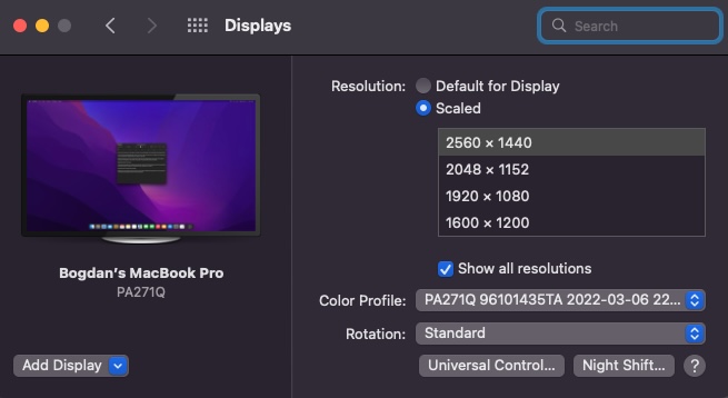

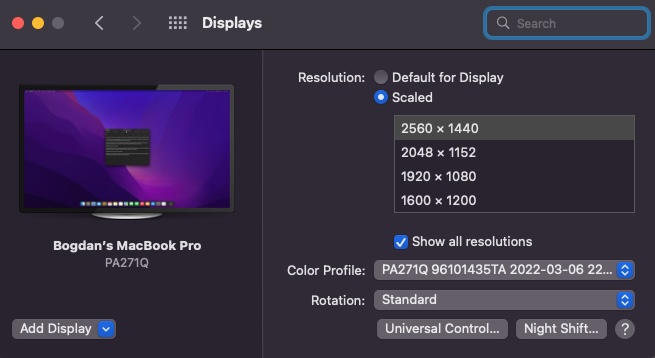

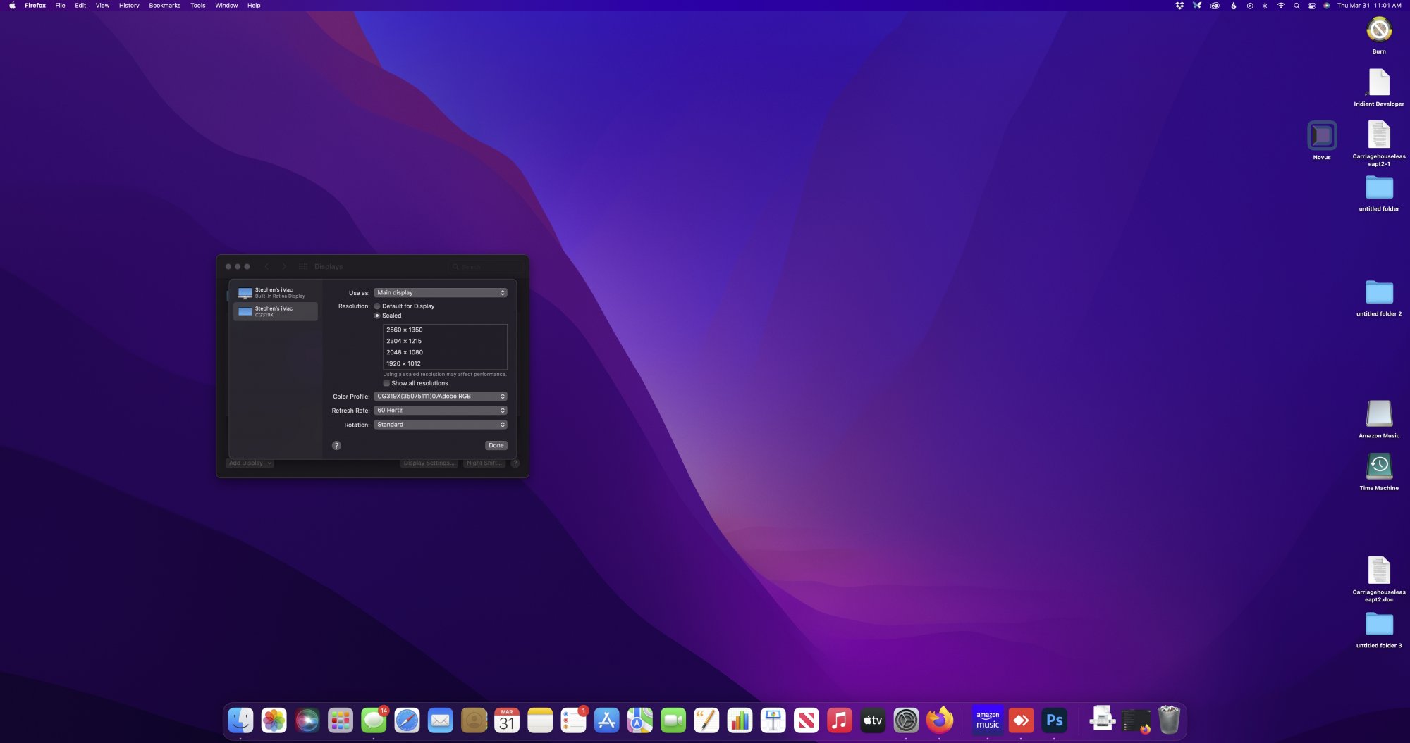

That's great, thanks! Is it possible to post a screenshot that shows all the available resolutions you can choose from the video preferences - like the attached I have? Thanks! Also, are you a photo or video editor? That's what I do, and that's why I'm looking at the CG319X.

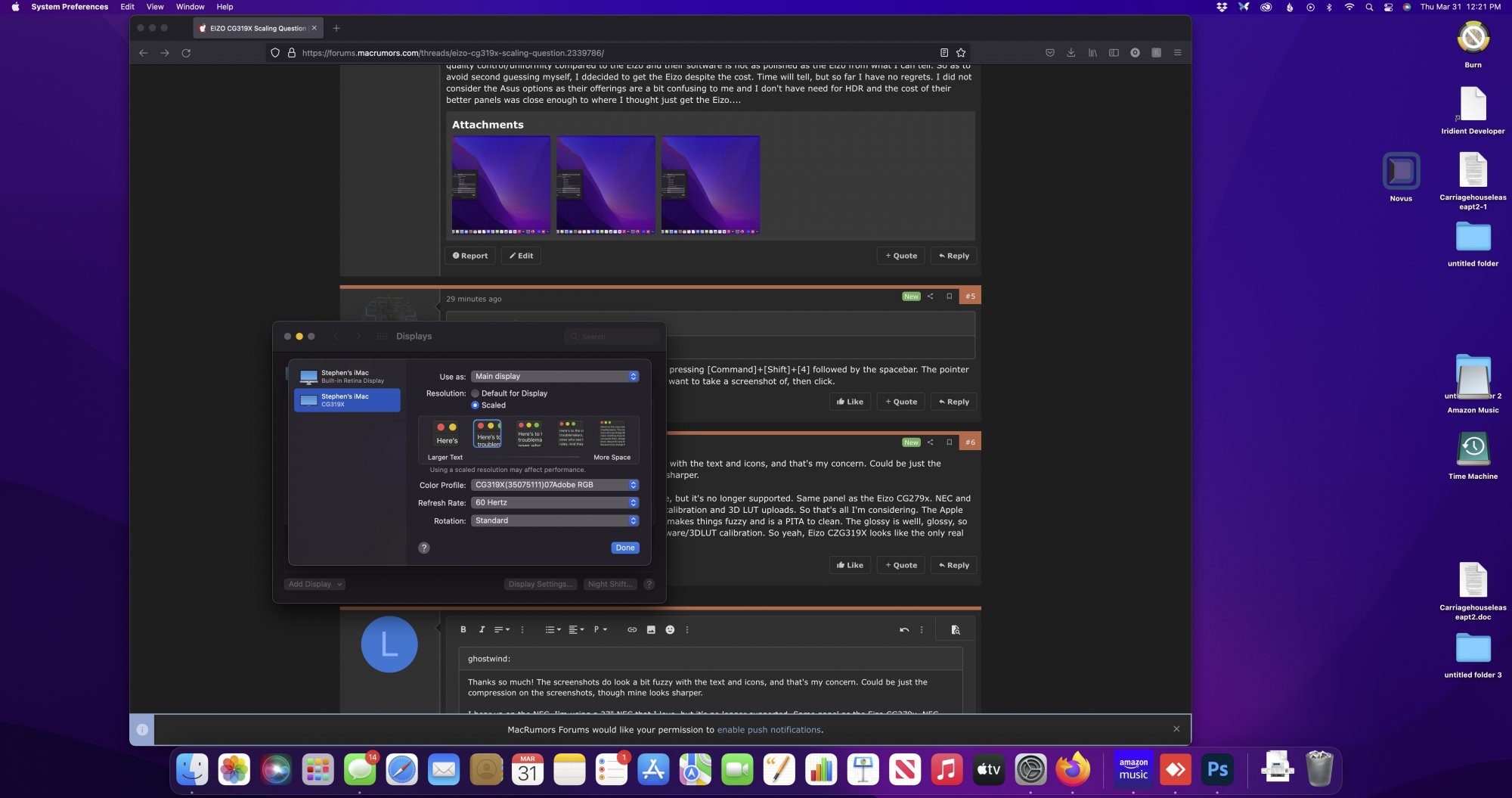

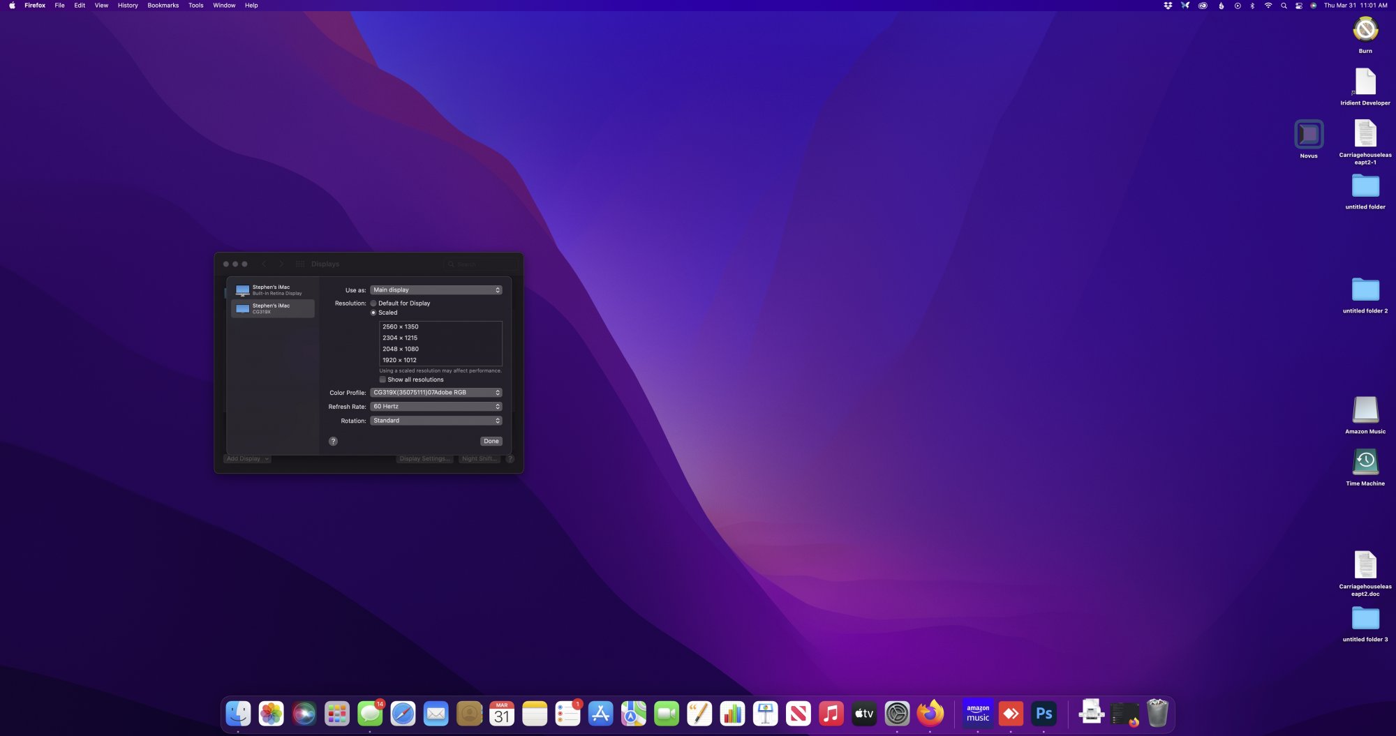

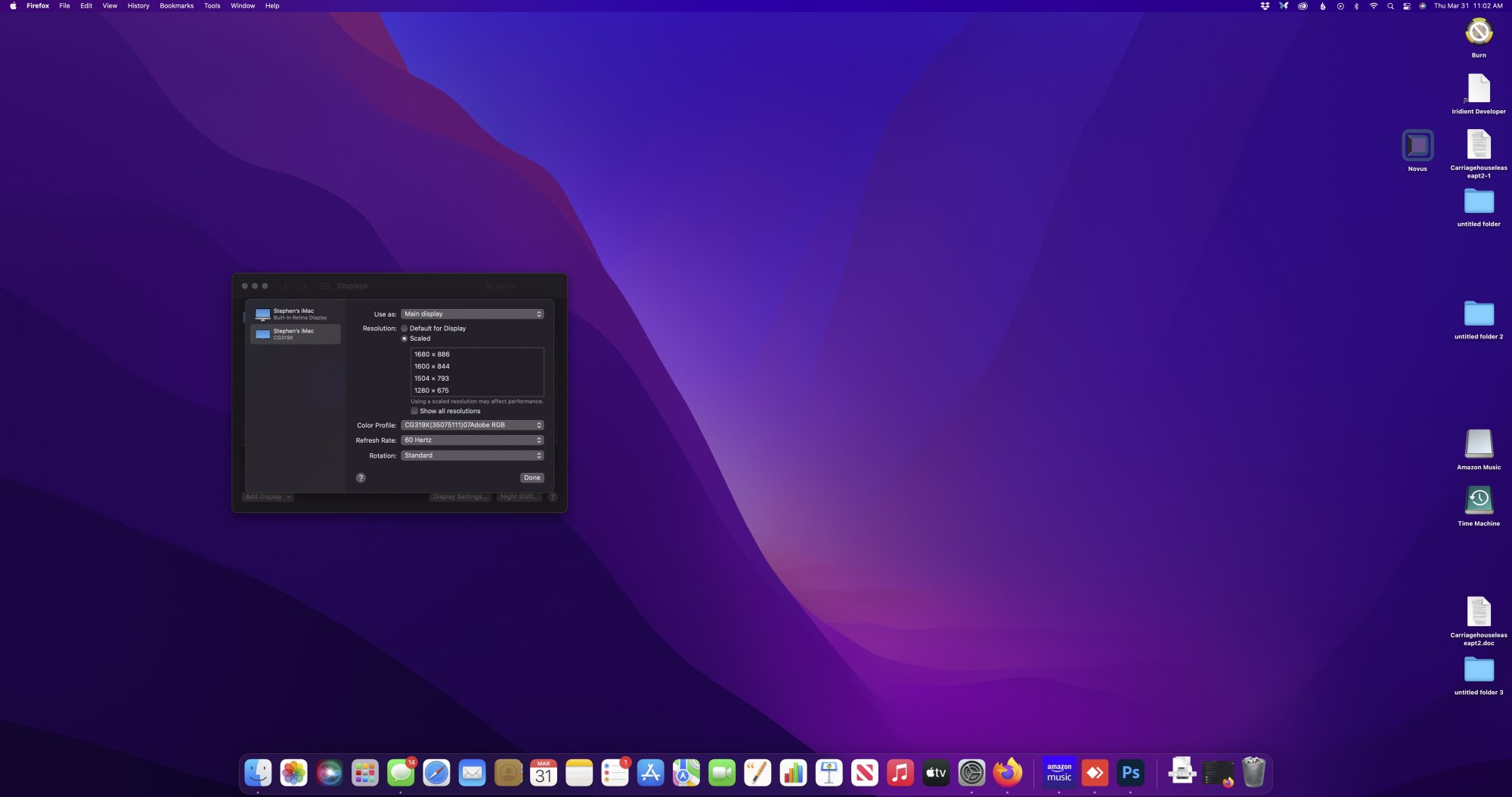

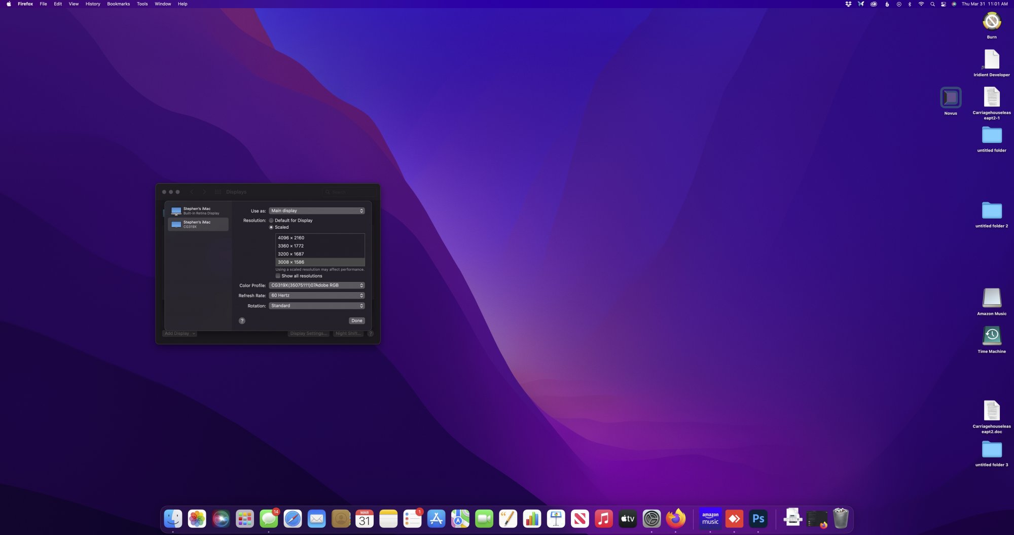

I did three screenshots. I did no show ALL the resolutions as it took three just to get the main options. Let me know if you need more information. I did decrease the resolution in an effort to make the window more legible on a screen shot. Let me know if you cannot read it.

I did three screenshots. [...]
You can take a screenshot of just a single window by pressing [Command]+[Shift]+[4] followed by the spacebar. The pointer will turn into a camera. Move it over the window you want to take a screenshot of, then click.
Thanks so much! The screenshots do look a bit fuzzy with the text and icons, and that's my concern. Could be just the compression on the screenshots, though mine looks sharper.

I am happy to take screenshots at whatever resolution you like. I think I used 3008x1586 for the ones I uploaded. I can also take a photo of the screen and upload the photo (or email it to you) at whatever resolution you provide. Here is one more screenshot at the resolution you inquired about: 2560x1350.
Thanks. I did not know that. However, I then would have had to take three screenshots of the window as the list was not expandable to include all options at once from what I can tell.
Reactions: Amethyst1
Thanks. Not sure why they are so fuzzy - is it the compression? Weird. But if you don't notice a difference in sharpness between the native 4096x2048/100% vs. larger, scaled, I'll take your word for it!
When I look at the screenshots on the forum, the look fuzzier to me than the screen does in real life. I won't swear that the scaled larger options are 100% as sharp as the native 4k resolution, but they are very close to my eyes and absolutely no problem for me. Let's say I don't notice the difference but someone who is very picky might see a difference. I know a lot of folks have espoused the benefits of 5K displays due to scaling problems with 4K. I have not tried to use a 27" 4K display, but on the 31.1" 4K display, I just don't see what the problem is. I think the 5k is a bit sharper scaled to 200%, but the differences are minor to me. Indeed, if I sit close, I can use native resolution on my Eizo and for images, there is no substitute. For text, larger sizes may well be preferable for most.
Reactions: ghostwind
So you're saying that the 5K iMac at 200% (native scaling) looks very good, and the Eizo at 4k about the same. But what about the Eizo scaled to 3360 or 3308?
They are fuzzy because the forum software has shrunk them to a width of 2000 pixels. Images wider than 2000 pixels are automatically shrunk. You need to upload them elsewhere and link to them to show them in full size.
Again, I think text looks very good at both of those resolutions. I don't want to say 100% as good but for me it is so close as to be a non-issue.
