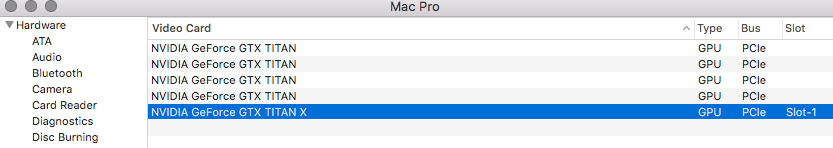

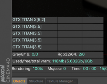

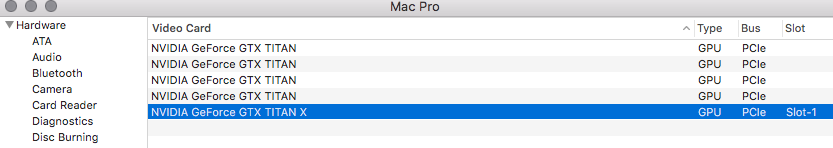

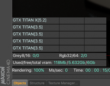

Hi guys,
Here is the news, after having updated my Mac Pro 5,1 to El Capitan following the steps advised by Macvidcards, my primary graphic card GTX Titan X as well as my 4xGTX Titan are recognised by the OS X system and Octane.
My nVidia web driver is the latest: 346.03.02f01
My cuda version is: 7.5.20
Octane version: 2.24.1-R1
I though it was interesting to share it as everything is working well.
Cheers
Regis

The 4 x gtx Titan are unflashed (unmodified).
I didn't do anything in 10.11.
For my primary card which is a gtx Titan X flashed by MVC, I just followed the instruction for making the update from Yosemite to El Capitan.
That's it, piece of cake and everything is working well.
Hope that helps.
Cheers
Regis

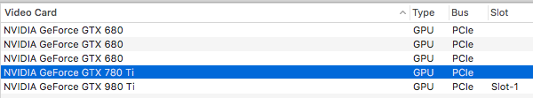

UPDATE:
It won't work with Maxwell externally.
I can't get more than 3 980ti's registered along with any other cards.
Wont boot if i add my K4200 internally or externally.
Must be limited to Kepler which is in internal OS X driver I'm thinking because you and cbm7 (Netkas Forum) both have 4 titans external but u can't get 3 980ti's.
Proof it will only work with Kepler
3x GTX 680 4gb (PC) + 1x 780ti (PC) on the splitter boot up just fine.

UPDATE:
