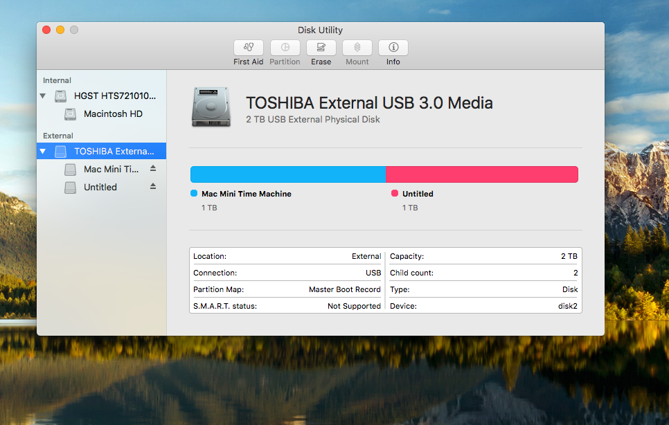

I am having issues as well. I have an external HD that I was using to back up to two computers. I had it partitioned to do this. I no longer wish to have the second partition but when I click the line with the HD name, the partition button is still greyed out? How do re-partition it.

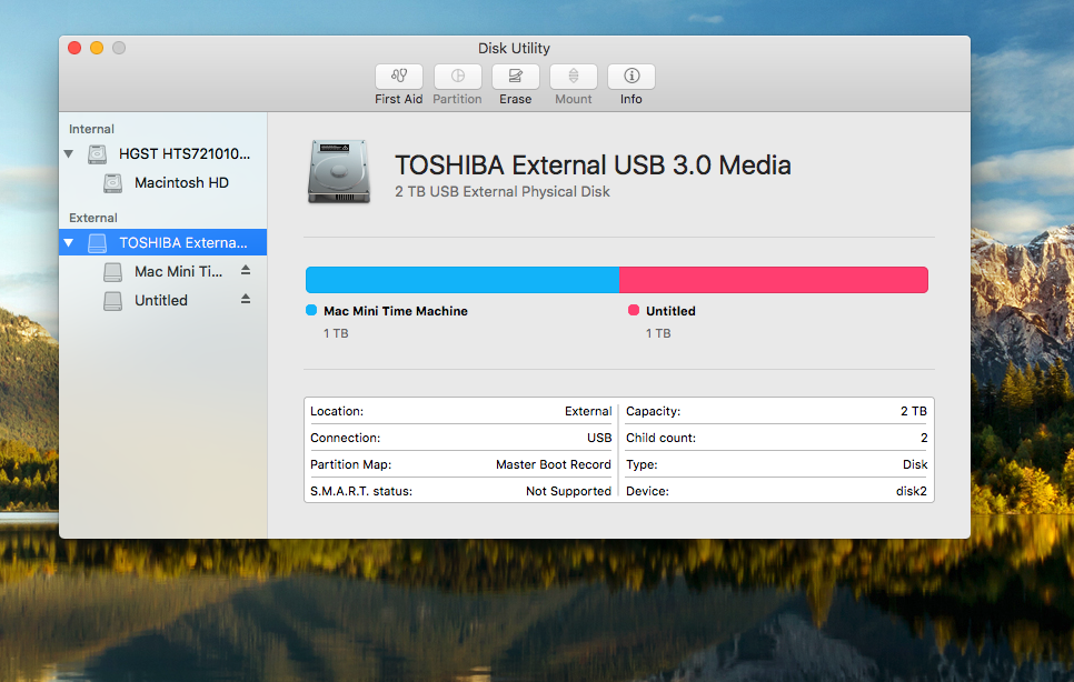

Normally, your screen shot should show that Partition choice is available when you choose the Toshiba line.
But, likely that won't work when your Toshiba has a Master Boot Record partition map.
You will probably need to remove all partitions - Erase will do that from the Toshiba line, as your screen shot shows.
Then, you should be able to get to the Partition tab, and change the partition map to GUID.
Before doing that, you will want to copy anything you want to save to another drive, as you would lose everything that is not backed up somewhere else.
Reactions: Stu and sirius56

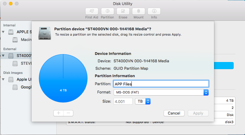

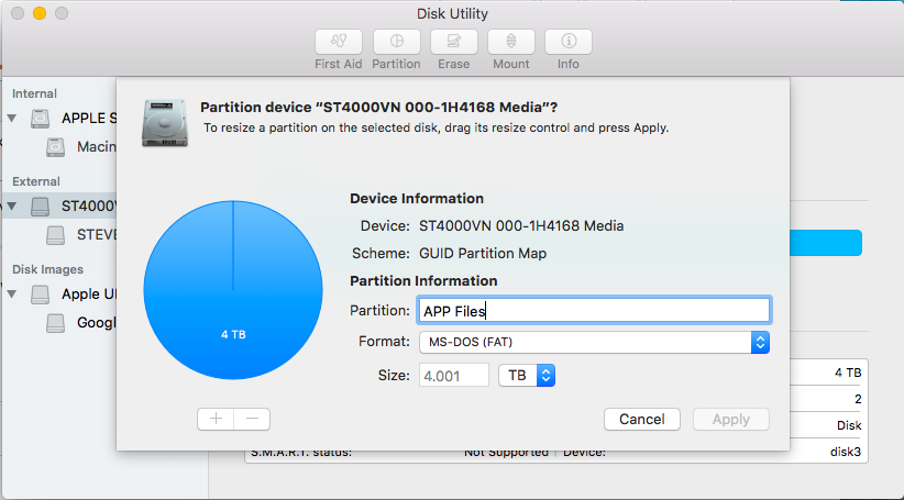

I have a similar issue but different. I can open the partition tab, but all the options that would actually allow me to make a partition are all faded out and wont let me click. Why???
I have a similar issue but different. I can open the partition tab, but all the options that would actually allow me to make a partition are all faded out and wont let me click. Why???View attachment 641053
Hey Eleni,
I had the exact same problem. I found erasing the disk and formatting it to OSX extended journaled allowed you to then partition the drive into whichever format you like. It's a bit awkward that it works this way, but should get the job done.
The entire drive MUST be formatted as Mac OS Extended Journaled with GPT partition table before you can add partitions. This seems to be a limitation of Disk Utility.
That is because the FAT32 file system only supports drives up to 2TB and you can only have files up to 4GB on it. If you select the Ex-FAT file system option you should be able to format your drive. However, this is only necessary if you plan on using this disk with non-Mac systems as the HFS+ file system works better with Macs and is what I would recommend.
