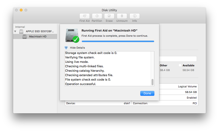

Also, try holding command-r at boot to get to the recovery screen. From there use Disk Utility to run first aid. Does that report any errors on the disk?
I can get into safe mode
, but it's very slow also.
I will try and do the recovery and run the diagnostics.
What should I expect when I run the diagnostics?
You will get a screen that looks like this showing everything is okay. Or you will get an error message in that same screen if there are problems.
