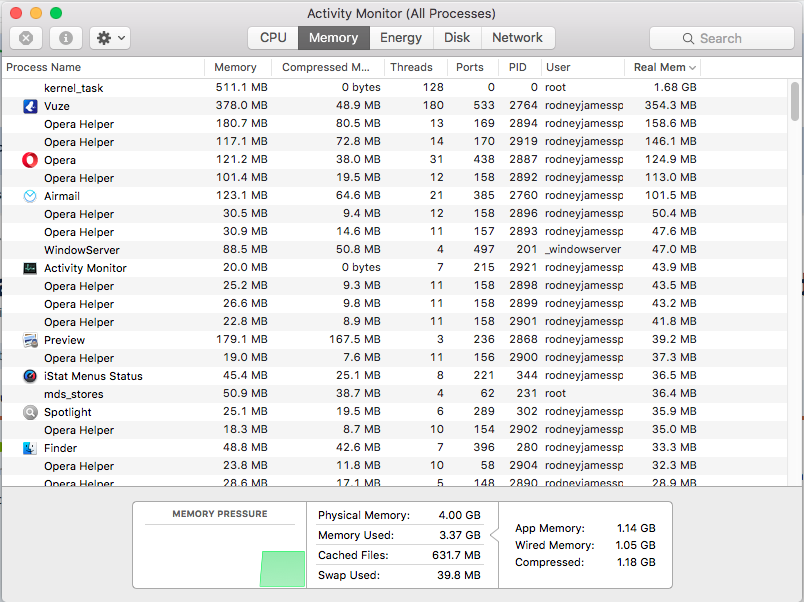

I'm not sure what you are worried about as far as Memory goes. As you can see from my screen shot these levels are normal. Around 3Gb total useage is nothing to worry about. I don't understand why you would go to the trouble of reinstalling your OS unless you are experiencing major problems and so far you have not mentioned an actual problem.

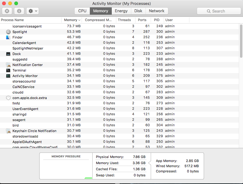

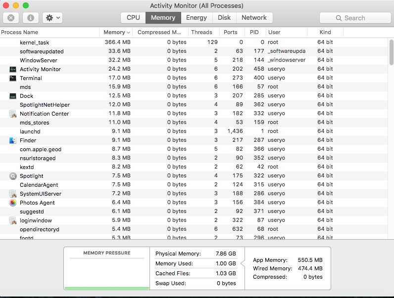

I am concerned because the OS memory used more than triples after booting in safe mode. Goes from 1 gig used to around 3.36 used. That is without loading any applications. Seems like memory is being wasted.
The only problem I can see here are your misplaced expectations 🙂 Memory management is a complex thing and I don't know how safe boot is affecting it. But your memory usage is very low and the memory pressure is a non-factor, so there is no reason to be even remotely concerned.
