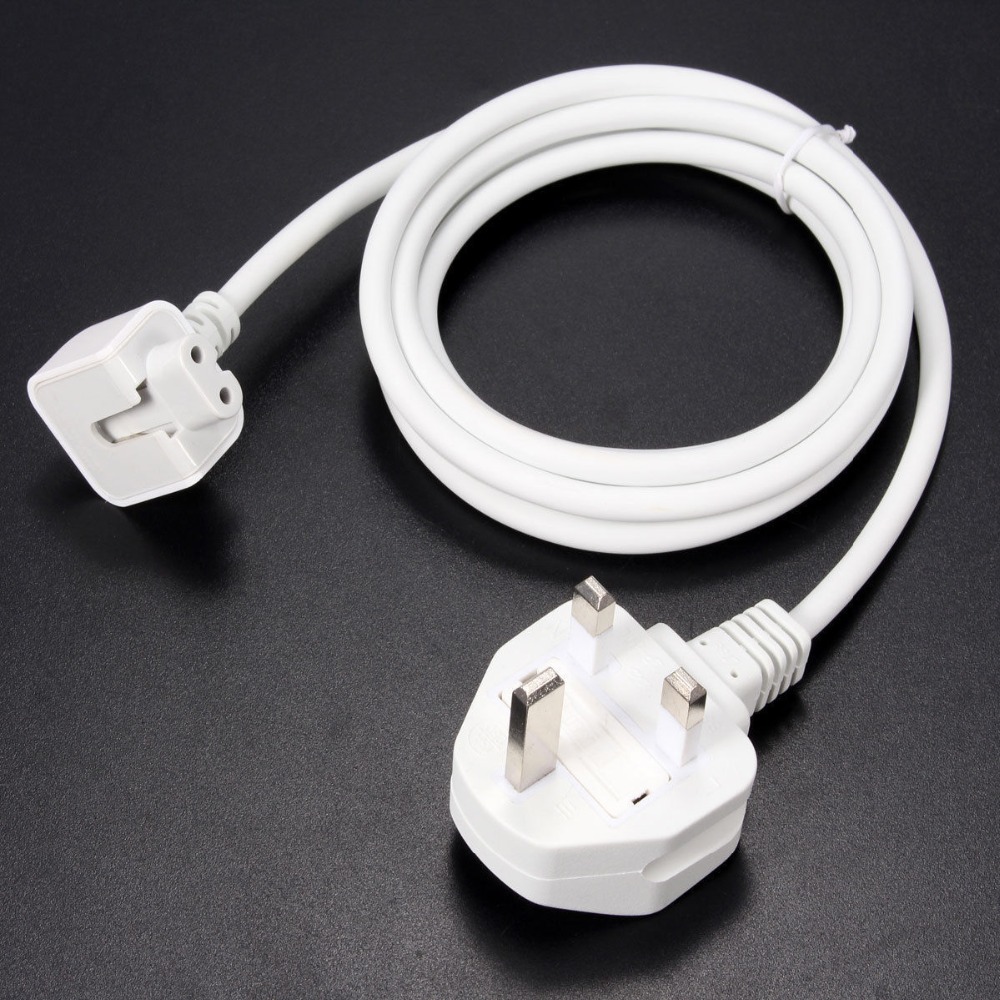

It’s due to the grounding on the plug on your charger. You’ll get that feeling when you have it plugged in.
Basically you’ll need to replace the plug socket bit with the older “longer” cables, as they’re earthed correctly and don’t cause the problem. One of the below rather than the one that plugs directly in:

I have that attached to the charger already. I took the laptop and the lightning cable to another usb wall outlet I have, and it does the same thing.
Question is wether the USB(A or C) Apple chargers even connect that ground-contact to the USB port.
Otherwise you are just grounding the high-voltage part of the PSU (maybe not even that) which will make little difference to some leak current on the low-voltage side.
