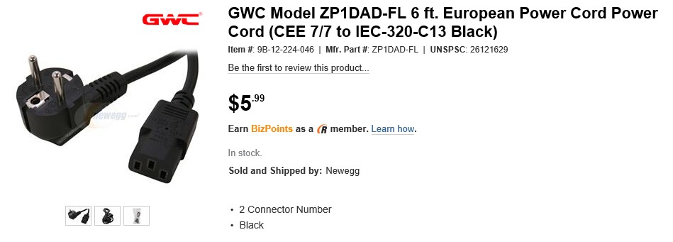

http://www.neweggbusiness.com/produ...-1&isNodeId=1&Description=european+power+cord
Note that "type B" and "type F" are also called by standards names.
CEE 7/7 is the standards name for the European plug, the standards name for the American 15 amp grounded plug is NEMA 5-15P.
IEC-320-C14 is the three blade male socket on the back of the equipment, IEC-320-C13 is the female end of the cord.

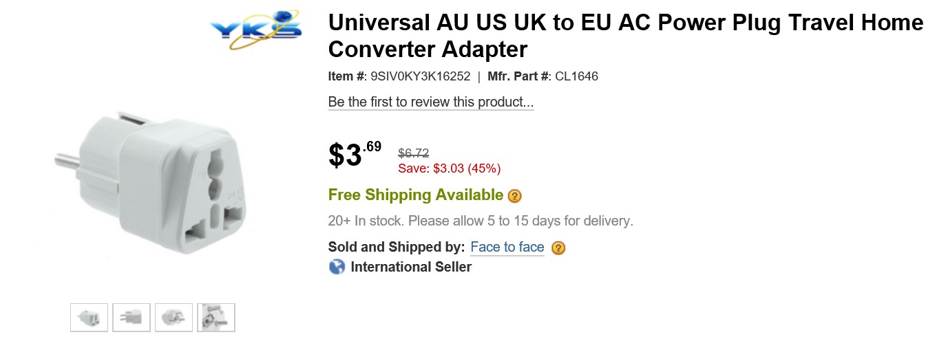

And of course, there's:
