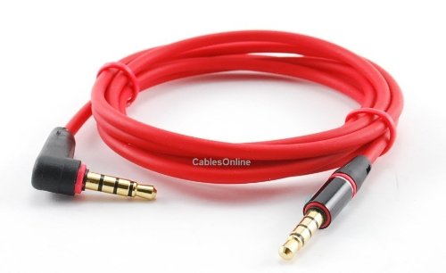

Mine looks like this. Cannot fix to factory as that seal can only be done in factory.
http://ecx.images-amazon.com/images/I/413+kLYGo6L.jpg
But I want to use this for ease of repair plus TRRS isn't readily available in Japan.http://cdn4.explainthatstuff.com/earbud-stereo-jack-plug-wiring.jpg

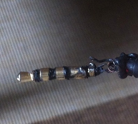

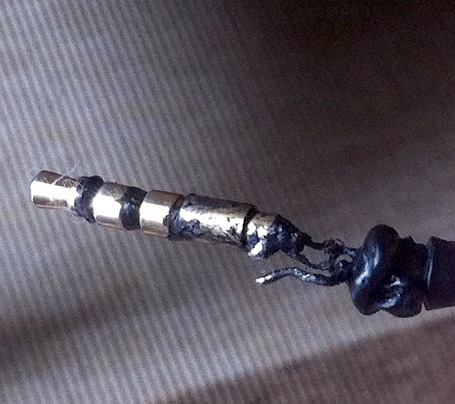

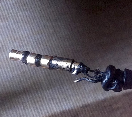

Anyway here is my original jack. Had to melt the factory rubber to see how the original jack looks. Iactually can't find ANY online that are just like it. Some are close but not exact. Above the sleeve mine seems to be a solid pice of metal with no bands like other jacks. Well actually I guess there are three distinct areas to solder to. Notice how the two wires connect together at the top. I thought this is supposed to be a no no.

What you should have done is cut away the outer plastic cover on the cable, and checked the continuity of the cables underneath with each of the poles of the connector... now it's a mess (not impossible, just a mess)
That jack is useless now, the whole thing is warped.
