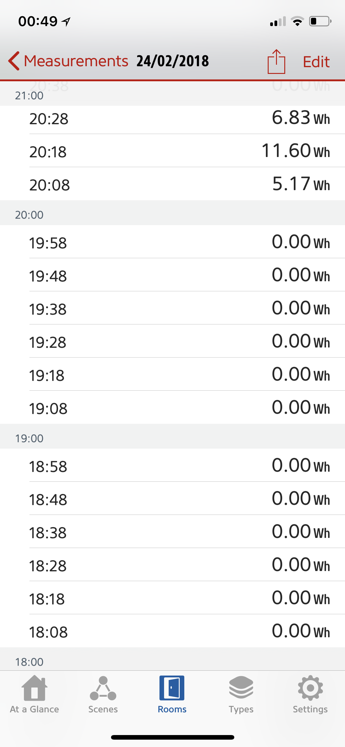

Hmmm. It’s in the detailed measurements that I’m seeing periods of time of as much as 2-3 hours at a time showing 0.
The projected cost per year figure looks about what I’d expect though.
I’ve attached a screenshot....

Since you are getting measurements above 0Wh sometimes and the projected cost shows a reasonable number, then it’s possible that the freezer is just completely “off” in the idle state. To make sure nothing is wrong, check the periods when you’re sure it’s running and compare the consumption data afterwards.
