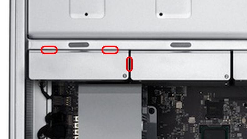

I have a 12TB Toshiba and a 10TB Seagate mounted on OWC drive sleds (the original Apple ones don't support the newer screw placements) and they both emit quite a lot of mechanical noise in form of vibrations, which is at times quite frustrating.
Do you mean the metal vibration sound?
You may open the side panel when that happen, and then give each HDD sled a light push.
If this action can stop the vibration sound, then you know which sled is the root cause. In some case, after that push, the vibration sound will go away.
If the sound come back after you release your hand. You may apply some blu tack at the edge of the sled (make it "connect" to the next sled, or the case). This may be enough to stop the vibration.
But if you mean any vibration sound coming from inside of the HDD, then I don't think you can fix it. At least no easy way to do so.
Actually both types of vibrations unfortunately!
I also need to replace the (makes a low frequency humming noise because it's old and probably worn out) CPU fan. Actually I've already purchased a Noctua "almost direct replacement" fan, but haven't gotten round to the hassle of connecting the new wires etc.
I agree with what you're saying about the side panel etc. I've for a long time been thinking about fixing it, but haven't found out exactly what kind of insulating material to use.
Unfortunately the OWC drive sleds aren't designed as precisely as Apple's, and because of this they physically touch the cMP side panel and transfers the vibrations, sometimes very loudly (but often stops (for a while) if I tap on the side panel).
