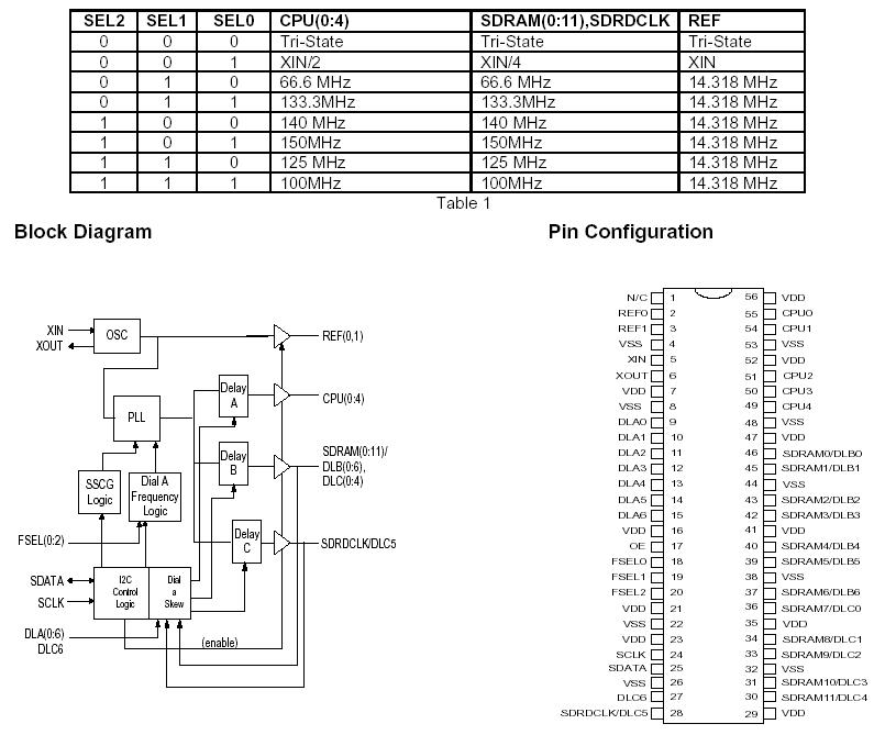

I've been looking at the g3 350mhz imac and find out something on the board that could be the pll clock signal chip.
It as the reference IMI C5002BYB 0032 T3010
Anyone know what can be done with this?

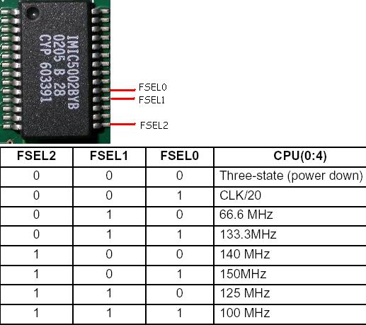

IMIC5002BYB Settings
I think these are the FSEL for this chip but i'm not shure about the FSEL order...
