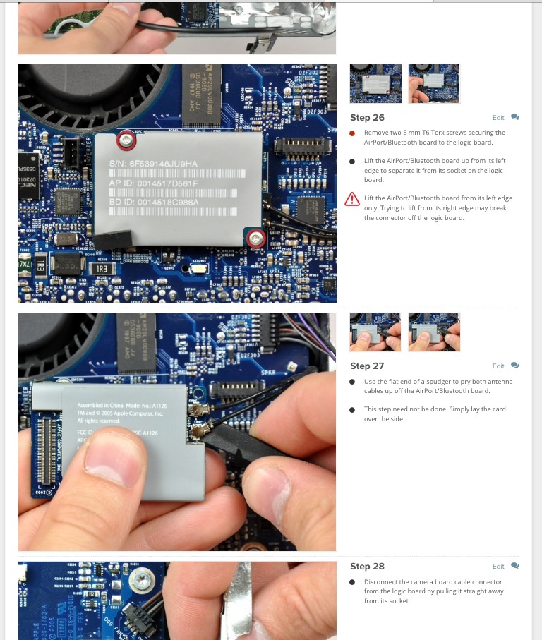

This is from an I sight imac g5 17" Do you think that this might work on the mini?..
According to what I can find, that card you have pictured (from an iSight iMac G5) should be OK in a mini that will accept it.
As I already posted - depends on which mini G4 you have….
Older G4 uses the Airport Extreme card, and newer G4 mini uses a combo card like the one that you show.
added - I do see in your other thread that you say you have a 1.25GHz mini G4. That's the oldest model (different from the Late 2005 mini), and will NOT take the card that you picture. The Airport Extreme (same as used in the newer eMacs) is correct.

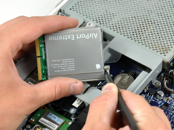

Hi, thx for your reply. Thanks for the research. As such, I gather that this card from an eMac should fit my 1.25ghz. True enough, EveryMac states that it is a 2005 model.

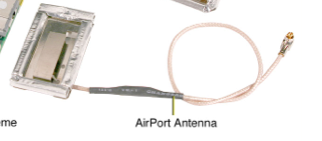

Here is a pic of the Emac's card. The cable which was attached to A/e is the antenna right ? I do have the cable as well.
Yes, the cable is the antenna wire.
The antenna for the mini will be different - with the antenna at the other end (about 1/2-inch in size, and padded edges, looks just like this:
