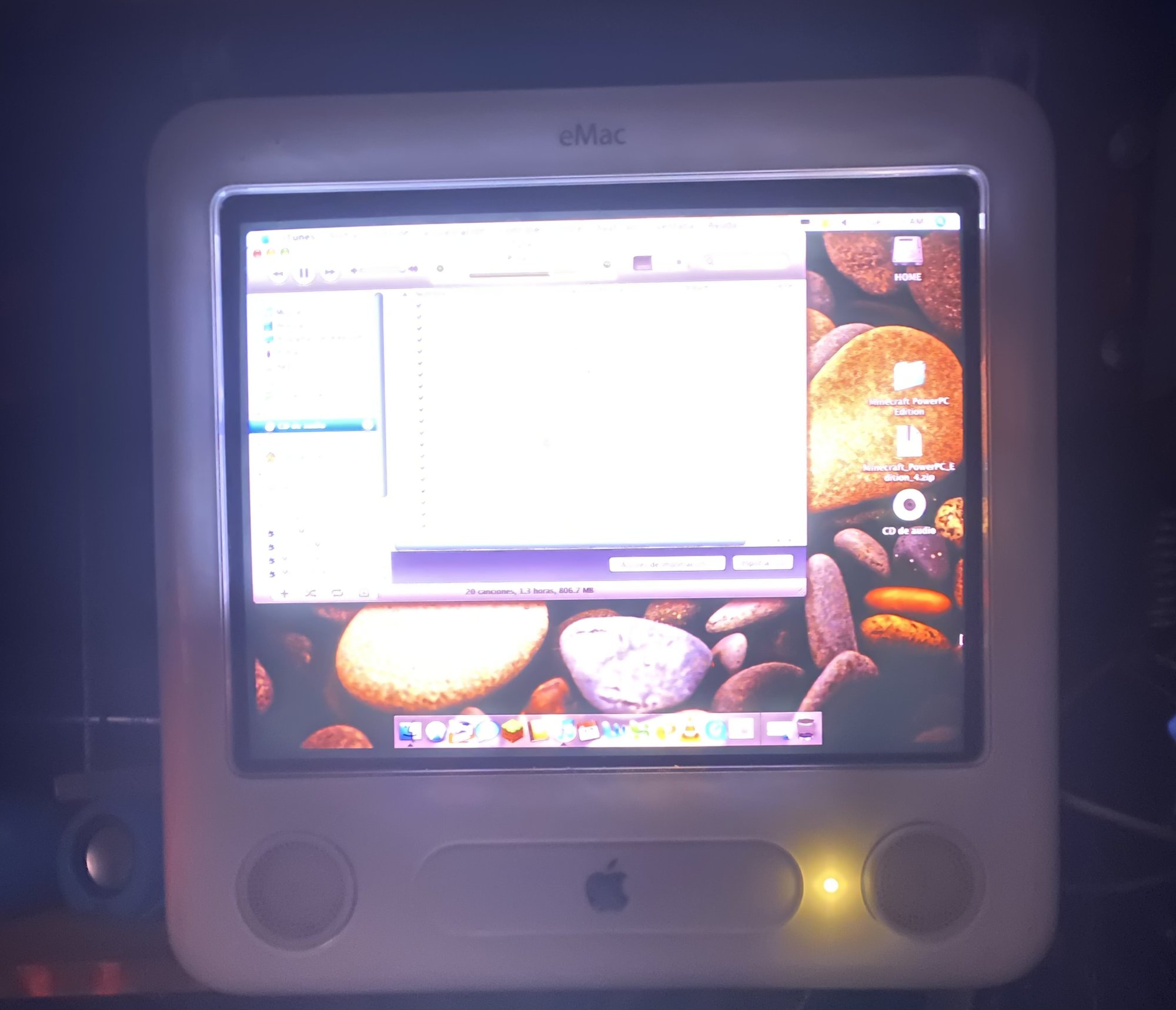

I have an eMac G4 (CRT), it loses image (black screen witout light) but of I gently tap the monitor, the image comes back.
What could be the cause?

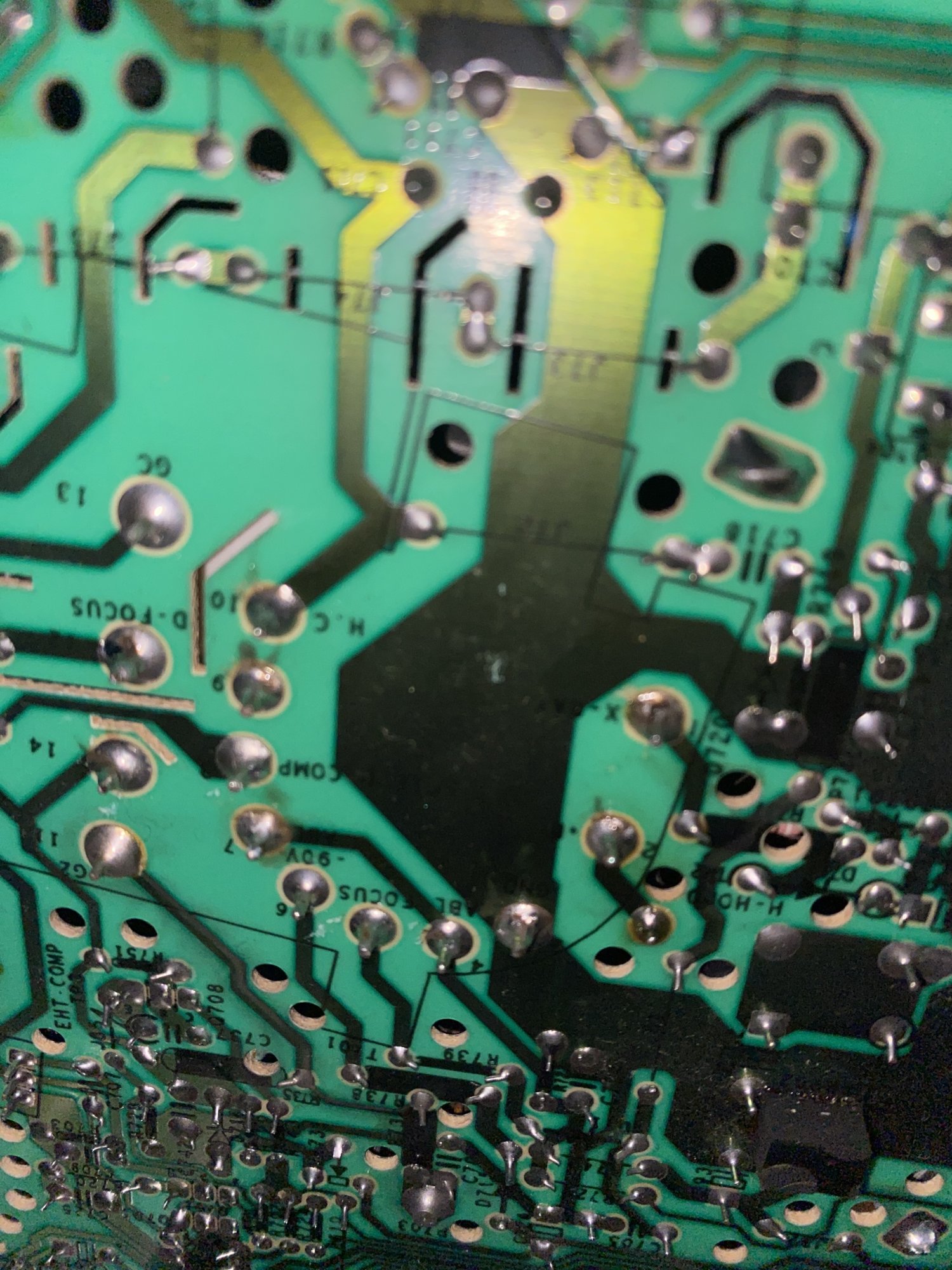

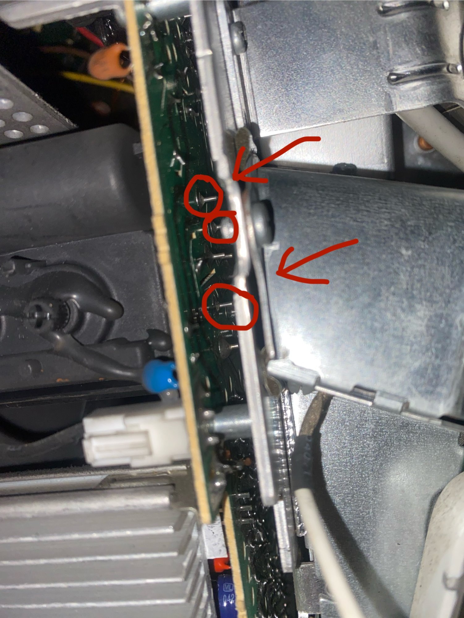

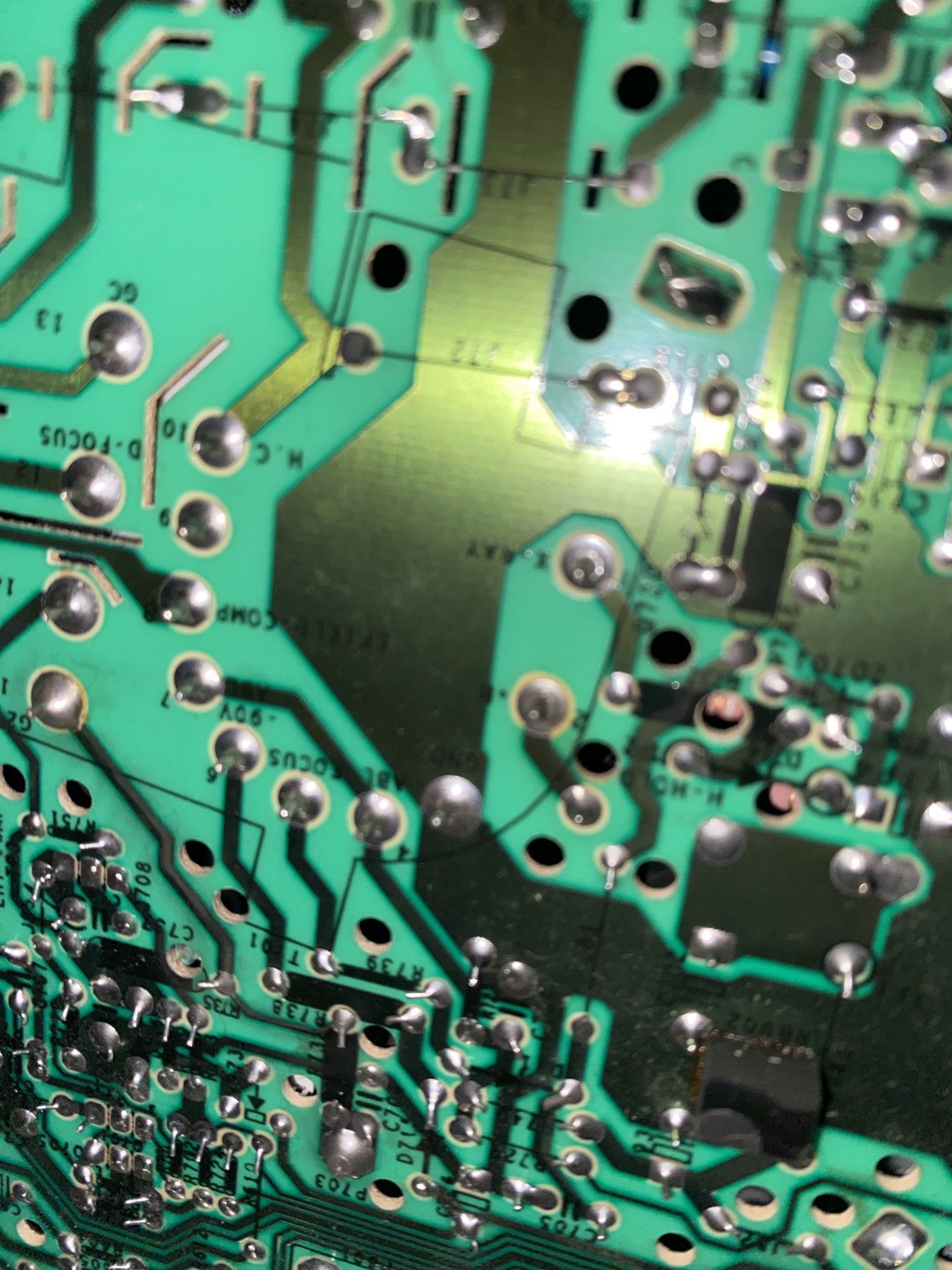

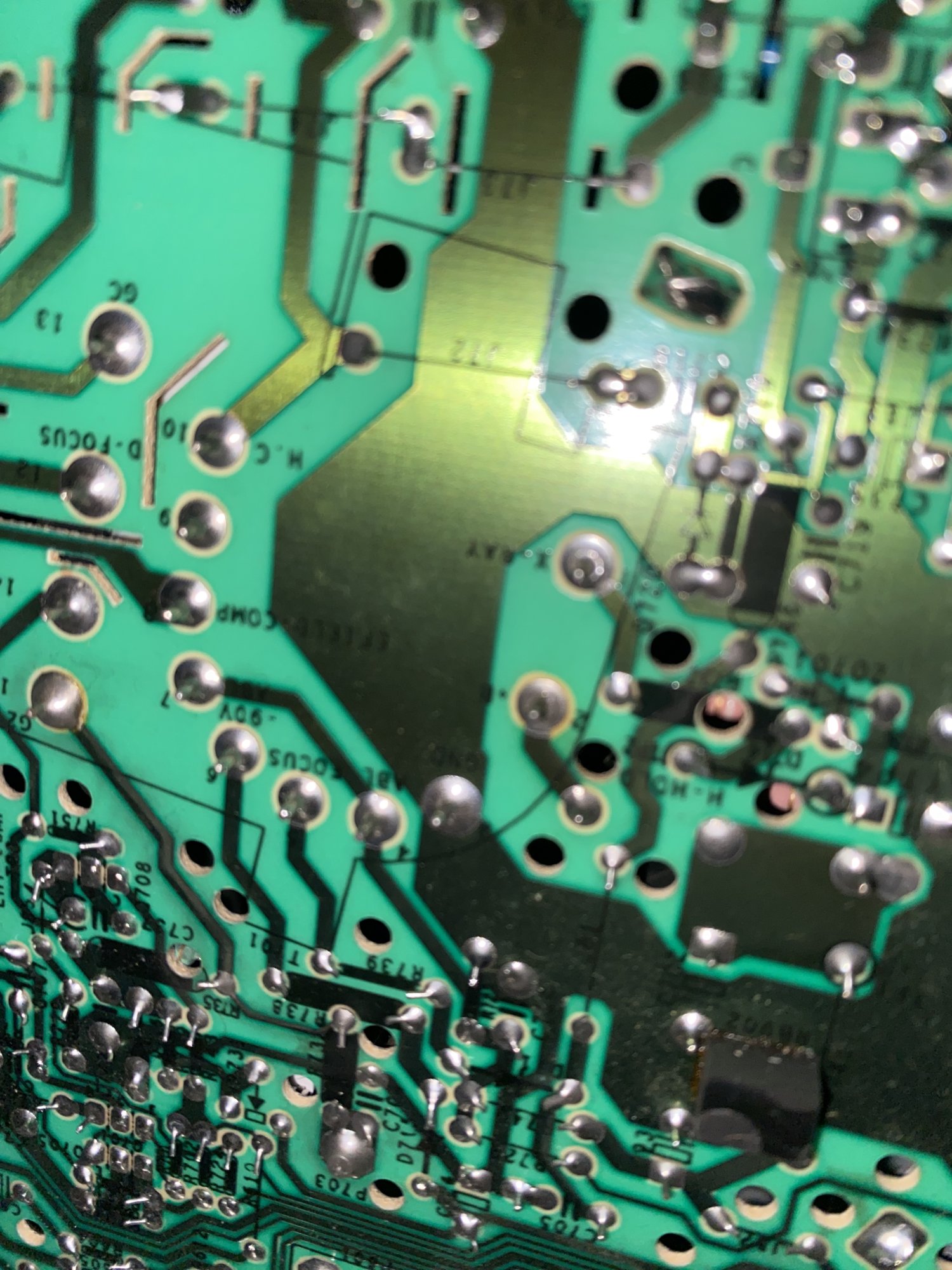

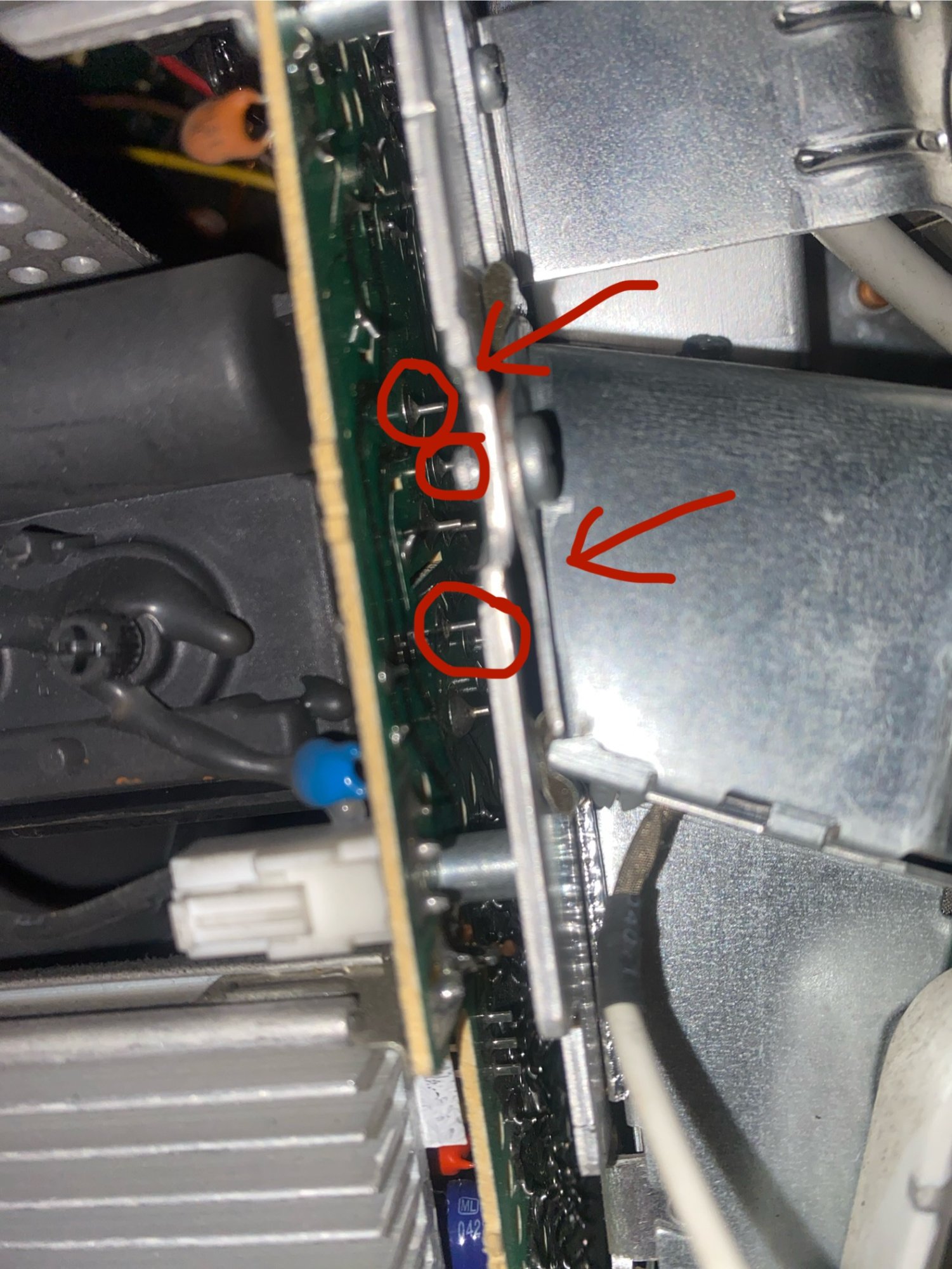

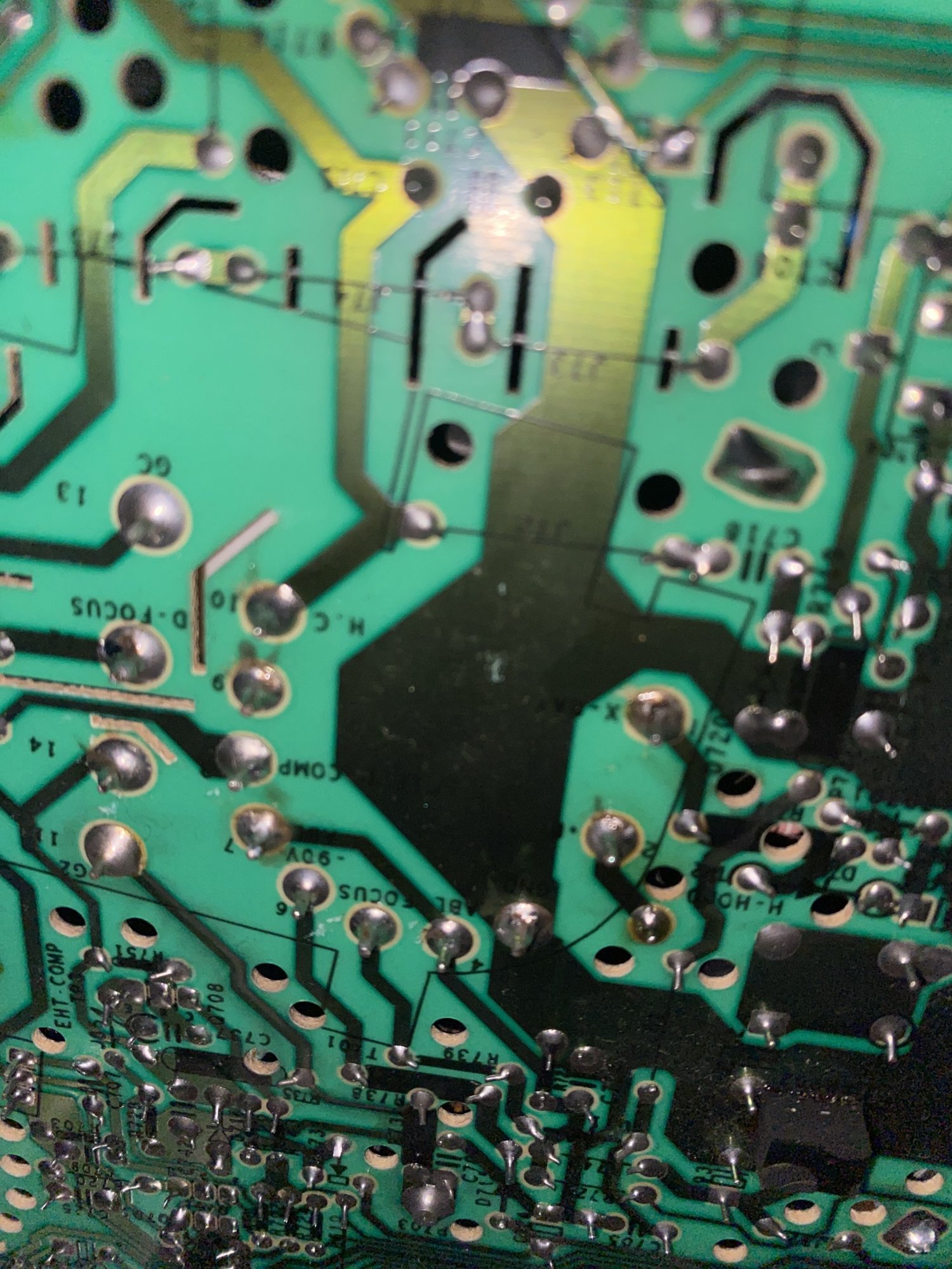

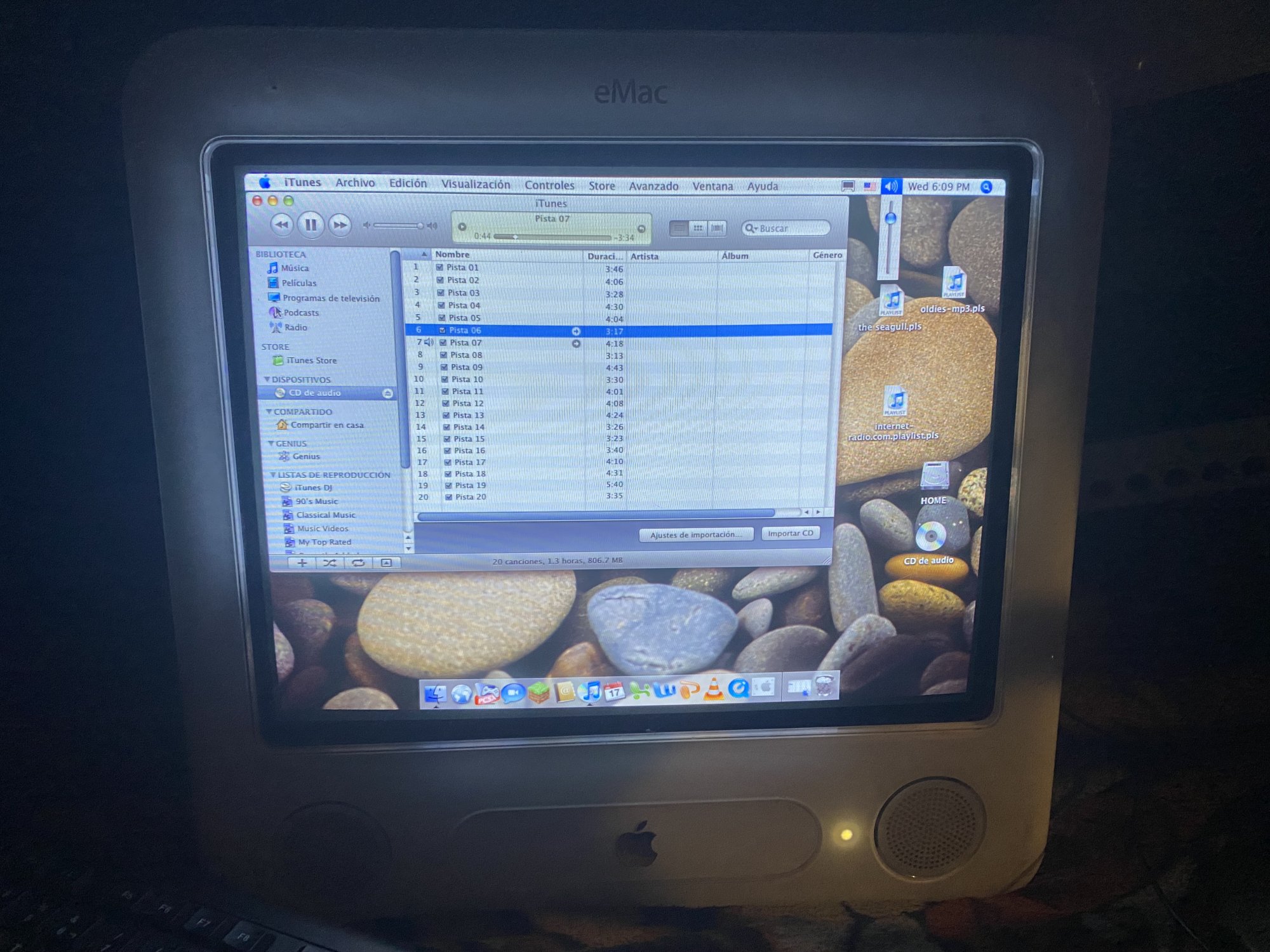

I found the guilty, the flyback transformer is unsoldered of the image board.

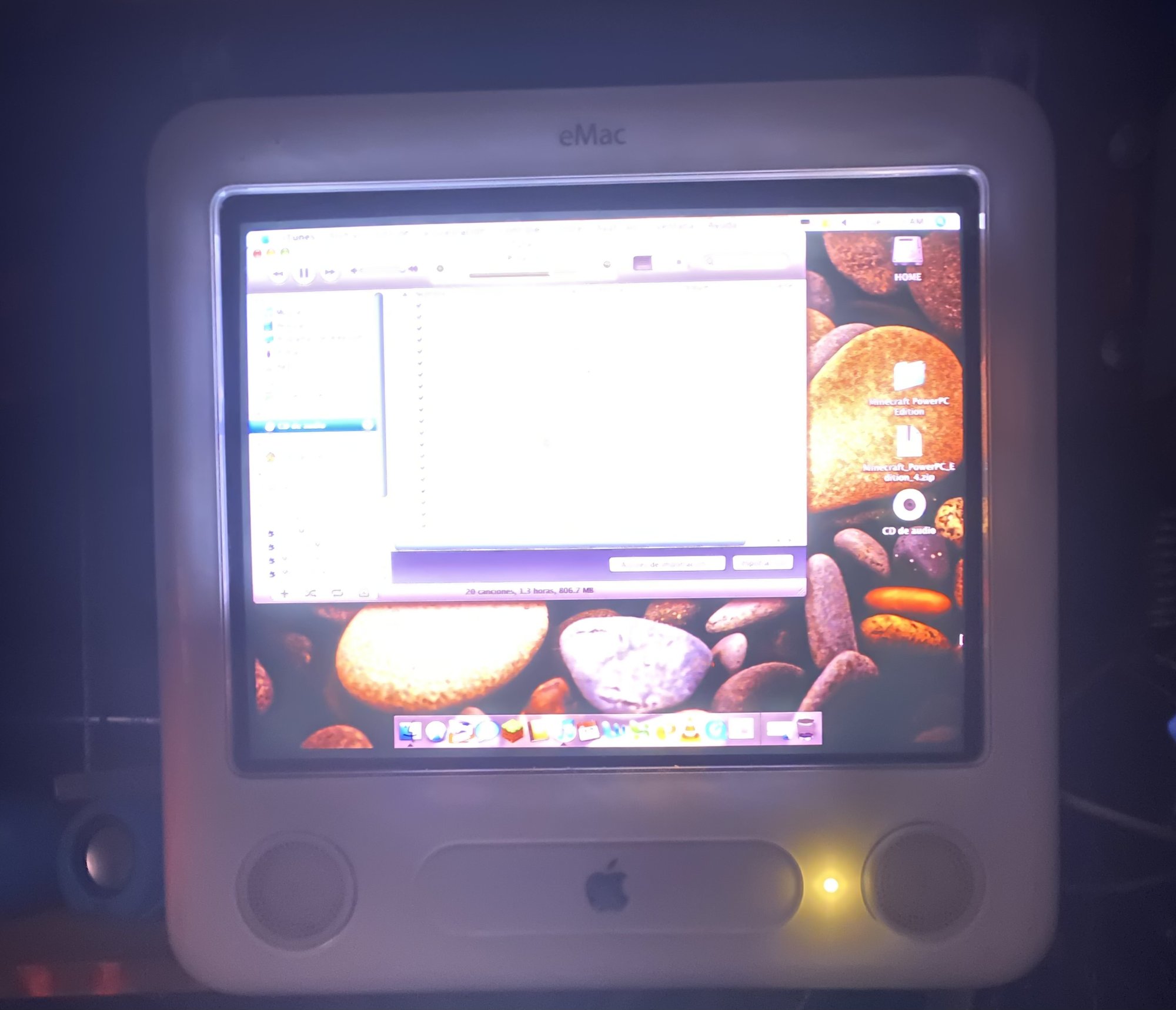

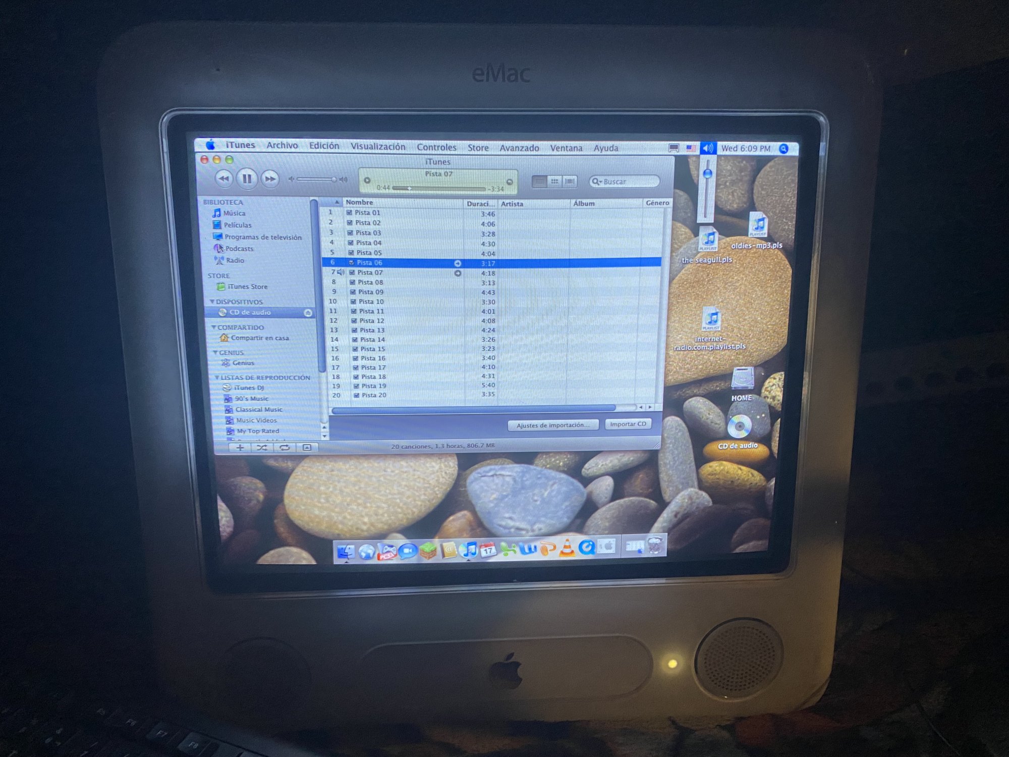

I soldered the flyback after a tedious disassembly an it's working again, it's my first repair (xd)
