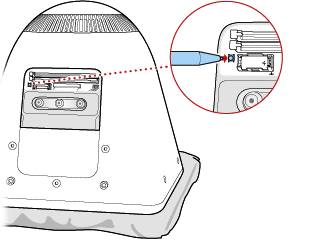

Not sure if it'll work but there's a very slim chance your display settings have wrecked themselves in which case resetting the PRAM/NVRAM should help and if not then maybe reset the PMU if you can be bothered although it probably won't help. To get to the reset PMU button you must take the bottom part of the eMac off so it may not be an option if you're not confident with that sort of thing. :)
