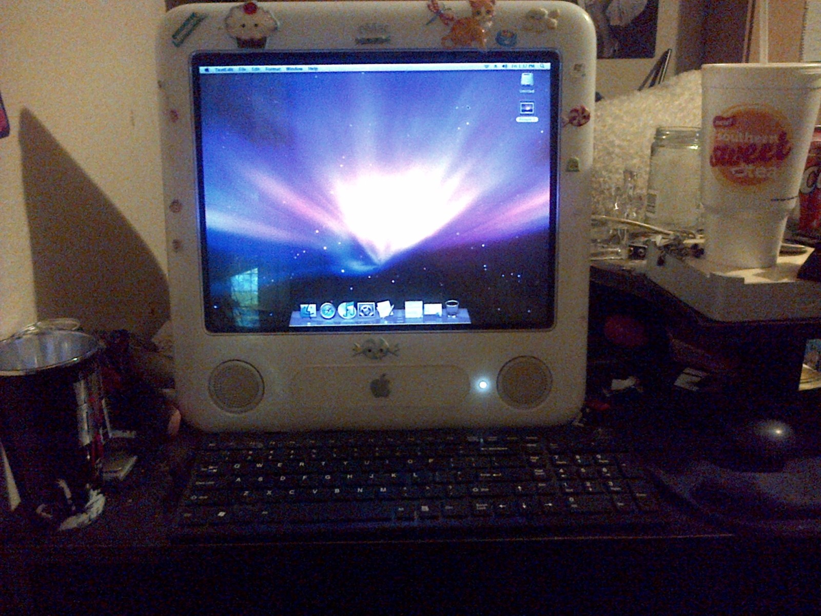

Well, this post is brought to you by my once-again functioning eMac!
You have no idea how I happy I was to see that "Welcome" start up video. 🙂

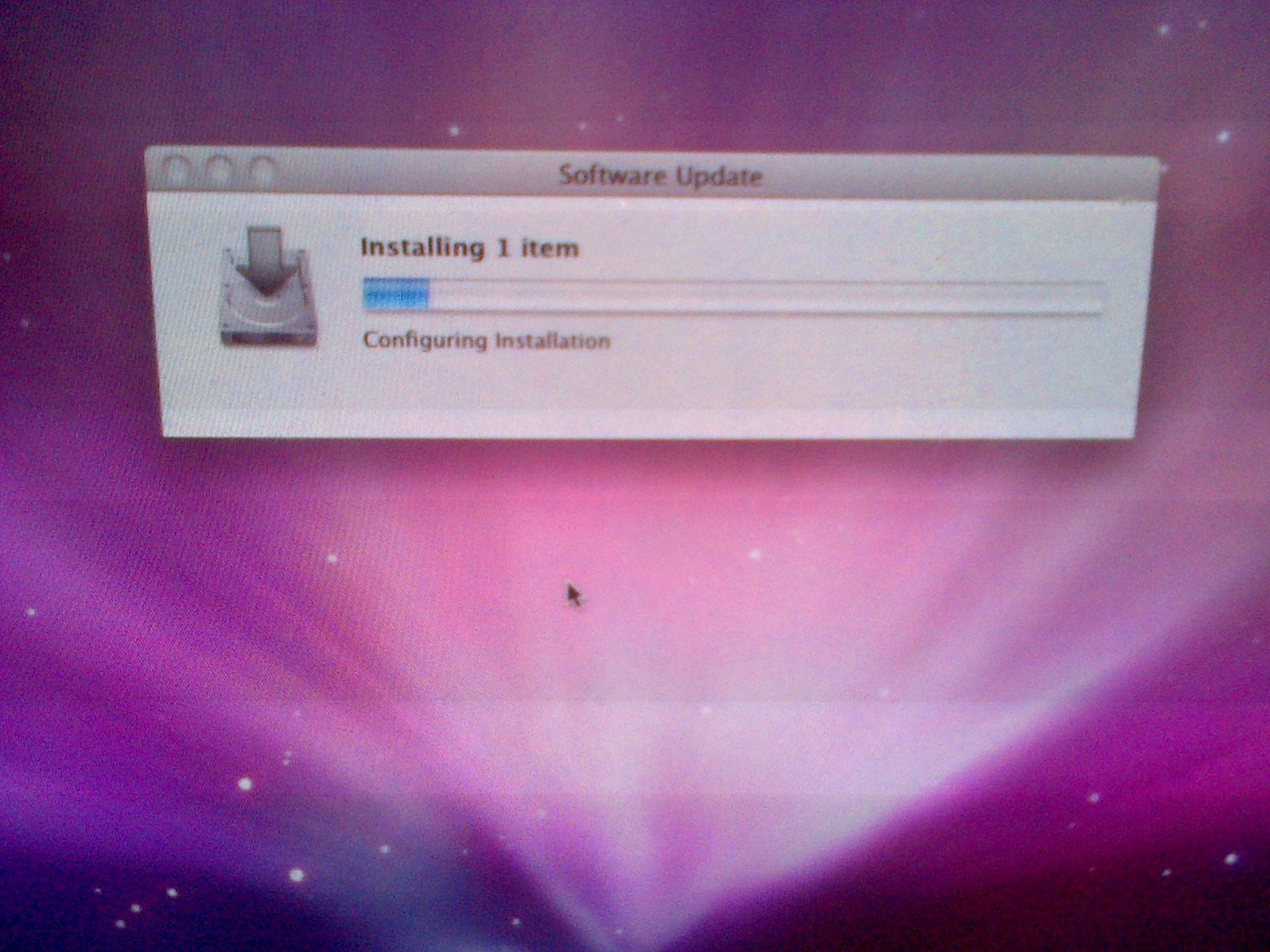

However, today I seem to have run into a familiar issue: I tried to update OS X and iTunes through software update. First off, after downloading both, it tells me something along the lines of "some package values were changed, either by Apple or an outside party, and iTunes cannot be installed." I've never seen a message like that before, but if that was really the case I decided to just update it manually when the time came. But when restarting to install the update to 10.5.8, I got stuck right here
I say "familiar problem", because my late 2006 Intel iMac gets stuck at the exact same place with the same update. I left that one running overnight and came back the next morning to see it right where it was, and subsequent attempts failed at the same point. I've only tried once on my eMac so far, but I suspect that I'll likely hit the same roadblock.
Any ideas on to why this might be? I'm really considering just reverting back to 10.4 at this point. 😕

When you run the updater there is an option to "Show Errors and Progress". If you select that a window will be shown that allows you to follow everything the installer/updater is doing.
This may give you a hint as to what is going on when the installer/udpater gets stuck at that spot.

Over the years I had this problem many times with Leopard - either the install would take forever to complete or it would be stuck like yours.
Recently I installed Leopard on a machine and tried running the 10.5.8 update from a previously saved package file - just wouldn't have it, stuck at the same point as yours. I found the update as an img file and that worked fine.
In every stuck case I had to repeat with a fresh install.
I'd try again but first zero out the drive to map out any bad sectors that might be affecting the install.
