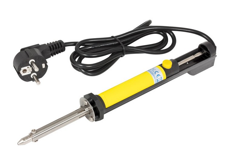

As far as the actual replacement of the flyback it's as easy as desolder the old one. Better with something like
But I guess it's ok to use just a simple solder iron and a simple desolder suction pump.
I had to move a component on the board otherwise the replacement flyback wouldn't have fit but I think as far as I remember it had only to be bent to a side.
