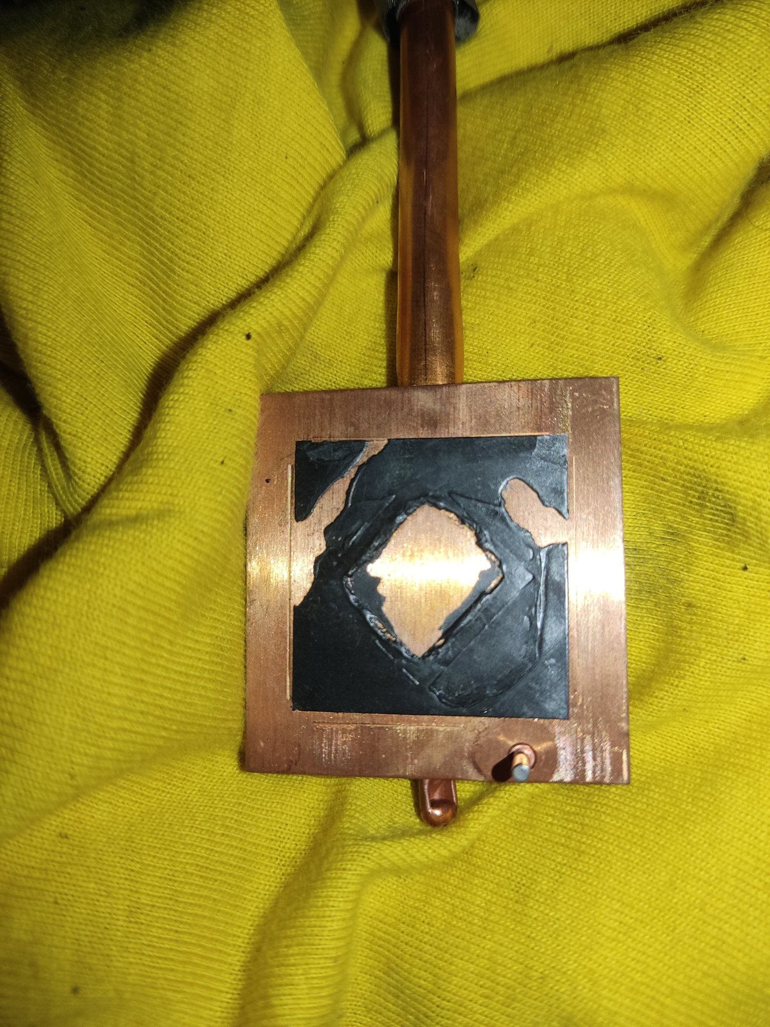

I wanted to replace the thermal paste in my emac g4 because i had to take the heatsink off and there is a thermal pad that seems very hard to come off what schould i use to take it off ?
And normal thermal paste is good?
Sorry if my english is bad.
Please add a picture. I am not super familiar with emacs but on some computers apple used a thin sheet of aluminum foil coated in some kind of heat transfer compound as the thermal pad. Those are very hard to remove without scratching the heatsink. I usually just put a dab of thermal paste on the processor die and leave the black aluminum piece alone, just put the heatsink back on over the thermal paste. If its a thicker foam/silicone thermal pad you will need to scrape it off and replace it with a thermal pad of the equivalent thickness.
Here it is
I wouldn't do that, if it comes with a thermal pad you should use a thermal pad, with a termal paste you can't fill the gap between the heatsink and the processor, and if the thermal pad doesn't come off esasily in one piece or it's desintegrating maybe you should replace it with a new one.
But it doesn't seem that it's a thermal pad mostly that i seen are blue and retain some clue that it's a thermal pad, I see really old thermal paste but I could be wrong.
You will need to remove that pad. I think thermal paste will be fine as a replacement as i do not see that pad filling up much if any space between the processor and the heatsink. Where it touched the processor die seems to be very thin. Apple commonly used thermal pads on their computers i think mostly for ease of assembly. No need to deal with messy thermal paste. To get the pad off try soaking it in alcohol and using a sticker scraper to get it off. Be careful not to scratch the heatsink. There is going to be some of that goop stuck to the processor die as well. You can see where it peeled off. use alcohol and a qtip to get it off the processor die. DO NOT scrape it off with a tool or you might crack the die. If the pad is thick, like .5mm or more where it touches the die you will need a thermal pad. If where it touches the die is like a sheet of paper or thinner thermal paste will do fine.
I will do what @mustagcoupe said in this case some isopropyl alcohol or paint remover will do the trick, drop some and let it a couple of minutes. The gap seems to be thin so with thermal paste I guess you're good.

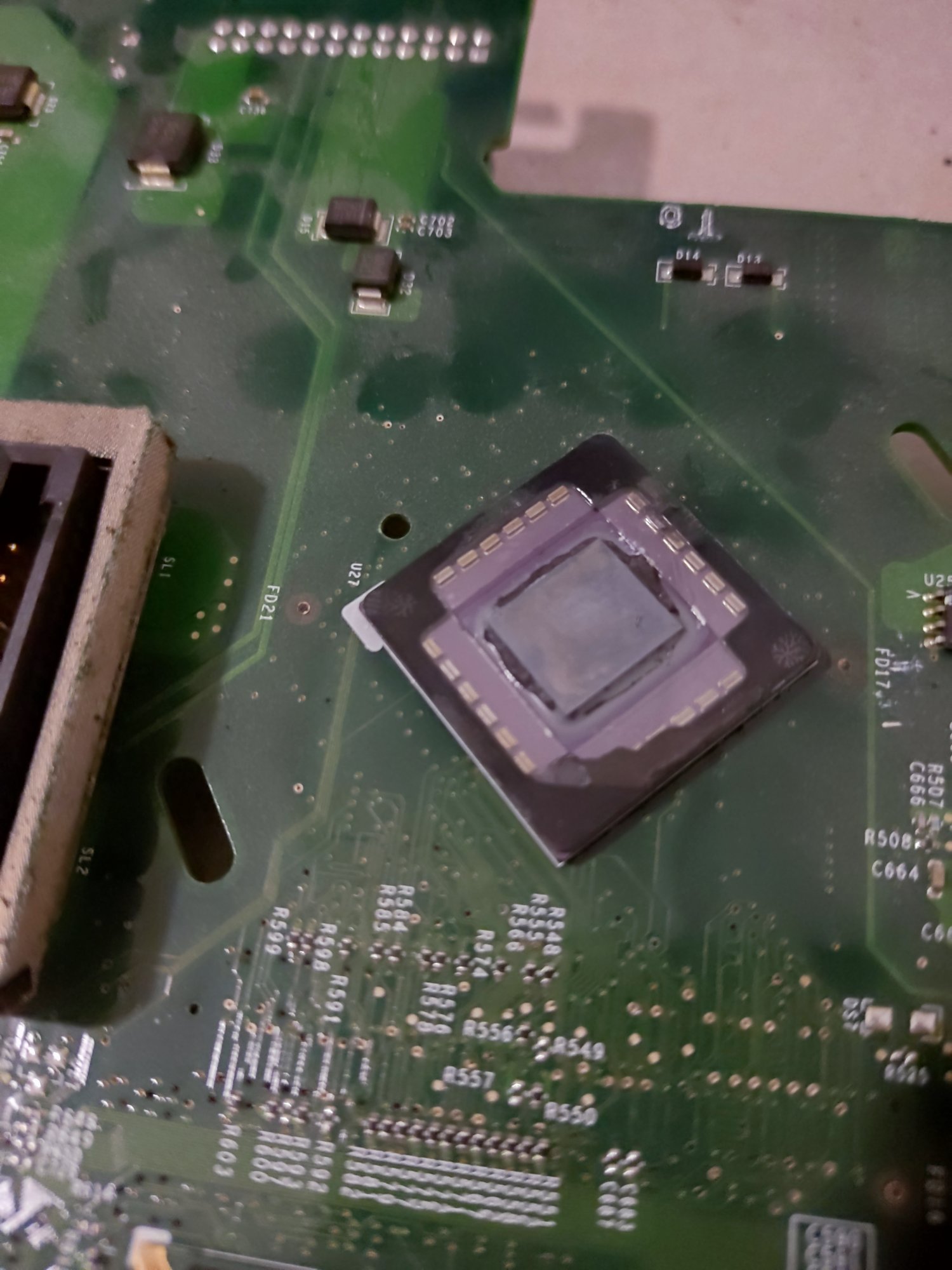

Here's a picture of the processor and on the heatsink the thermal pad seems very thin like less than a paper it's only more big at the centor of the processor
Yeah, clean both the processor and the heatsink, apply in the middle of the processor and if you want spread it with a plastic card or not and when you put the heatsink back the pressure will spread it.
You should use thermal paste. A thermal pad is not a good choice when you can use paste. Thermal pads are less efficent. What apple used in a lot of cases including this application is some kind of hybrid of a very thick paste in the shape of a pad. The only reason they used this instead of paste was for ease of assembly at the factory. Just get some decent thermal paste like artic mx-5. Put a rice grain size drop in the center of the processor die and bolt the heat sink down.
