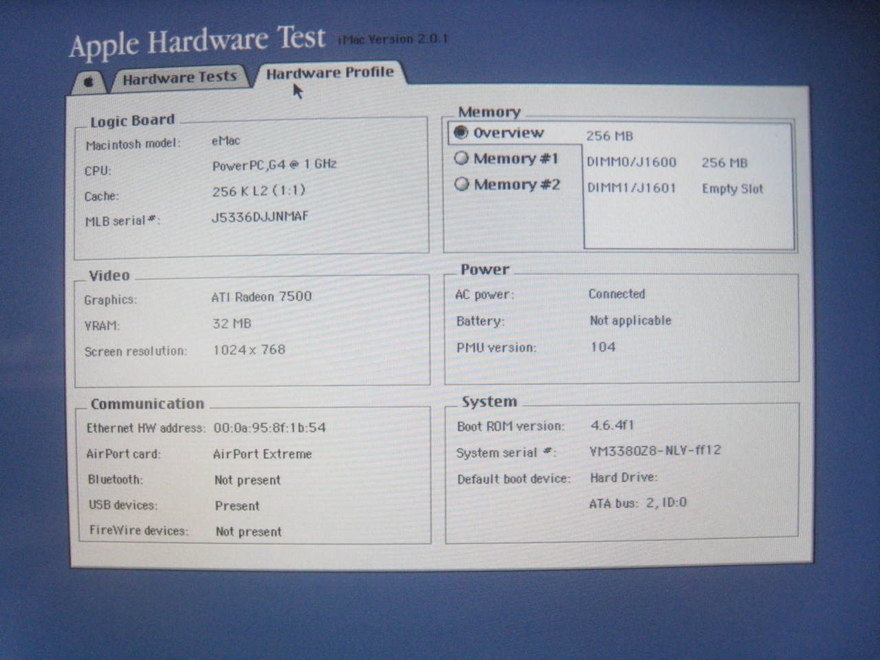

I have an eMac (G4, 1 GHz; ATI Radeon 7500 Video card) which will no longer boot, even from the original Software Install and Restore DVD.

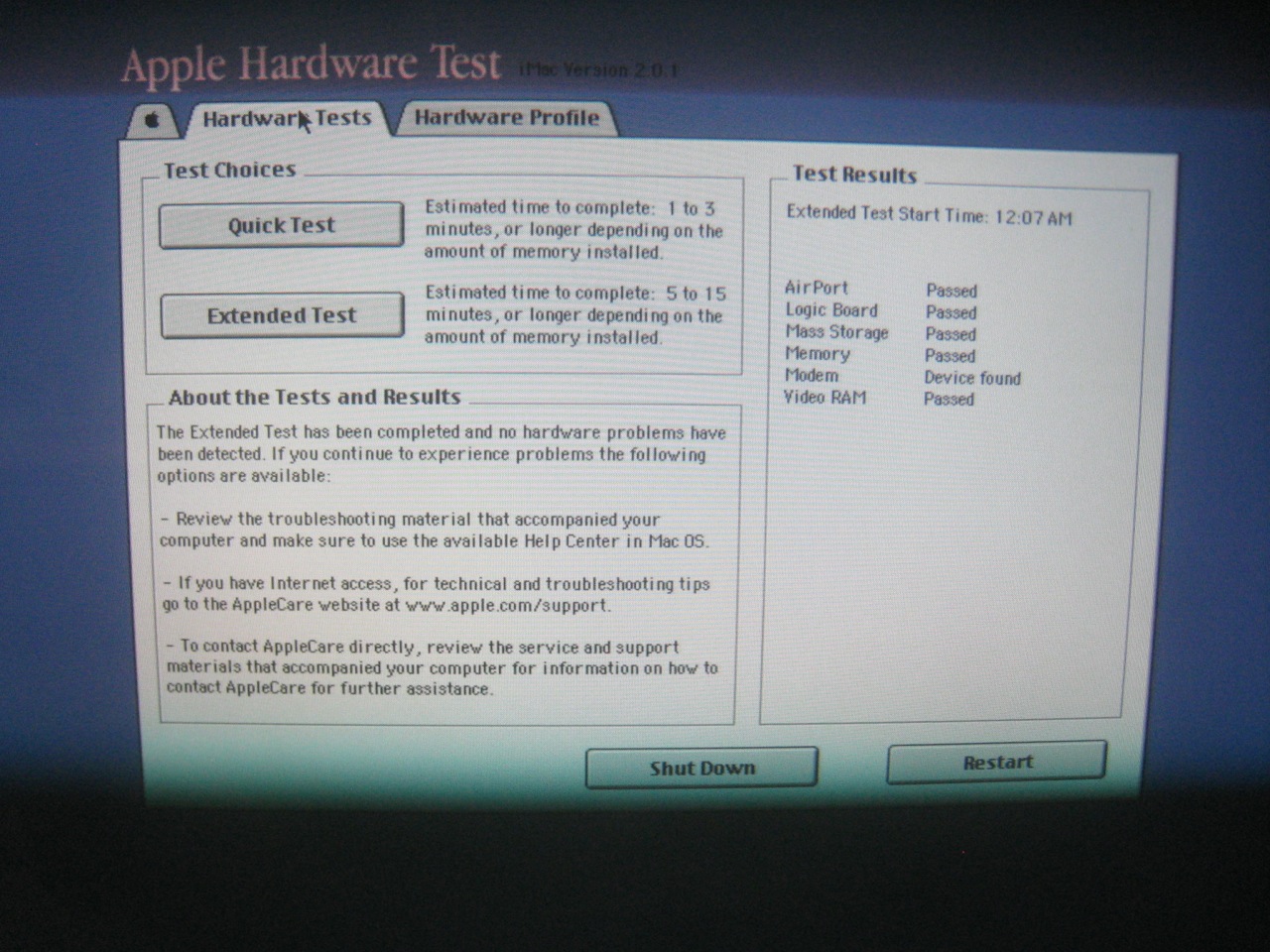

I ran the Apple Hardware Test from the original CD, and it found no problems.
My father (it is his eMac) then took the computer to an apparently authorised Apple service provider, who told him that the hard disc needed replacing and that it would be better to buy a new iMac.

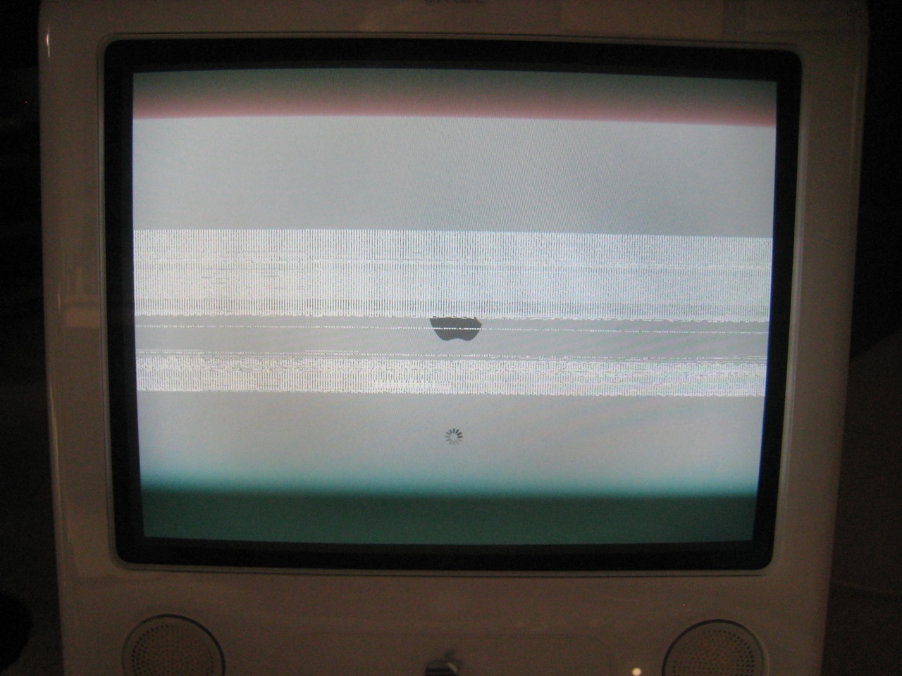

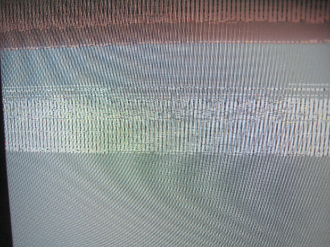

I was not convinced, so removed the hard disc and tried booting from the Software Install DVD. The result was the same. The Apple logo and spinning wheel appear, but after a few seconds a jumbled strip appears across the screen and the computer freezes. Picture is attached. It looks to me as though something is mistakenly being loaded into the Video RAM instead of into the normal RAM (or perhaps into the wrong part of the Video RAM).

- Run Apple Hardware Test - no problems found (see attached picture)
Before I call it a day and consign the machine to the scrap heap, does anyone have any suggestions as to what else I could try, either to help diagnose the problem or fix it?
Thanks in advance for any advice.
Attached photos:

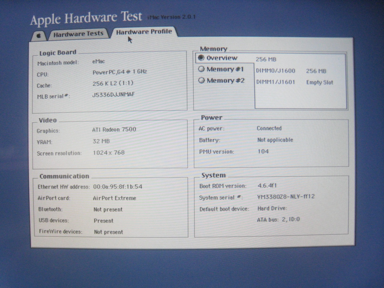

1) Hardware Profile, from Apple Hardware Test
2) Hardware Tests result screen (extended test)
3) Frozen screen
4) Close-up of frozen screen

I have tried a 'verbose mode' boot (cmd - V), and I did notice the same garbled strip appear across the screen and then disappear up into the blackness as the screen scrolled down and eventually froze. If I could get it to output the results to a file somehow then I imagine that would help to locate the problem, but I can't of course as the machine doesn't boot up. Perhaps I'll try taking a video of the screen and see if I can make out what is happening before it freezes.
If it freezes up completely, it's like the capacitors. Even good looking ones can be bad on the inside and that model eMac is known to have capacitor problems.
