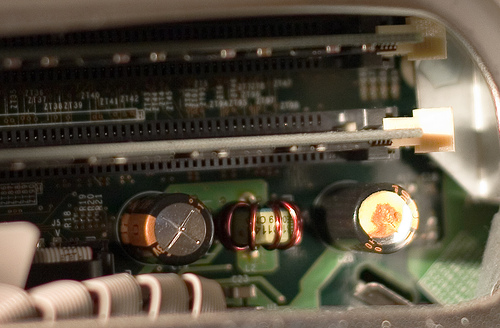

I can 100% guarantee you it's bad capacitors on the logic board. I just repaired a friend's 1.25 eMac with bad caps. You can actually see some of the suspected caps by pulling the memory access panel off the bottom and looking at the caps on the inside. If they are bulging at the top and/or leaking, you need to replace all of them on the board.

PowerPc G4, 1.0ghz, 40gb 512mb, CD, it was originally 250mb, but I bought it like this, also how do I look for caps?
Yeah, yours is one of the affected models. Unplug the computer, lay it on its' face on a towel, and take the single philips screw off the memory access cover.
You are looking for this -
If you see that, your capacitors need replacing. With it locking up at the Apple logo screen, it's almost always a hardware problem.

I don't see those caps in mine. I see a green logic board tho where the ribbon tape is.
Yours might differentiate from that picture. I'm pretty sure there are caps inside the memory access area on all eMacs.
From your angal mine has only one big green cap. That says made from France. It says lithium, and says hi compacitor, it looks like a battery laying horizontal on the board. The company says saft or something like that.
That's your PRAM battery. If you don't see any capacitors in there, then I guess the 1.0 models don't have them in that area. But before pulling it apart to see the rest of the capacitors, I would suggest getting OS X discs and try reinstalling the OS first.
