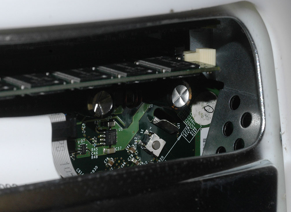

Holding down the restart button didn't work. So I'm on to the reset switch part but I've run into a problem in that I cannot locate the reset switch. Where the reset switch is supposed to be there is a cover that says t1A 44, and that does not look like a reset button.
There doesn't appear to be any button in the general vicinity of where it is supposed to be according to the apple diagram. The green bit on the bottom right is the battery, oriented the same way as the diagram
btw what does holding down the power button do (apart from making the power light flash a few times) and what does the reset button do?
EDIT: I forgot to mention that the display will sleep OK (but not the computer).

Hmm... Sorry but that picture has me a little lost. Would it be possible to have one from a bit further back maybe? It might help a little. 🙂
Resetting the PMU reverts some of the basic power firmware settings (slight misnomer but it's easier to understand) back to their defaults. Some of these firmware settings are related to the Energy Saver component of the eMac, including some basic shutting down files.
From what I've gathered, resetting the eMac by holding down the power button has a similar albeit less encompassing effect.

Here's a wider shot. It is aligned the same way as the apple diagram. The beige blob at the top is the clip that holds the ram module in place.
It sounds like the reset button might work. I wish I could locate it.

Well, I found this picture on the Apple Discussions board looking for a better explanation. It appears that either this image is upside down or the PMU button was moved during one of the updates to the eMac range. Does this help? 🙂
Note: this is not my image. Thanks go to Thomas Bryant from the Apple Discussions Board for it. 🙂

mad jew thanks for that yes it appears that the reset switch diagram is for the old nvidia cards. So I reset the switch, it's a micro switch and I pressed it about three times, then I found out that pressing it too much can blow up the logic board, 😱 fortunately three presses seems safe.

EDIT: here's a better shot of the reset switch for ati cards.

Sorry for misleading you with where the PMU reset button was. I haven't opened up either type of eMac for quite some time. 😱
Not your fault about the dodgy diagram there is no indication on apple's website that it was card specific. I only posted the new picture for others who might come across this thread at some future date.
