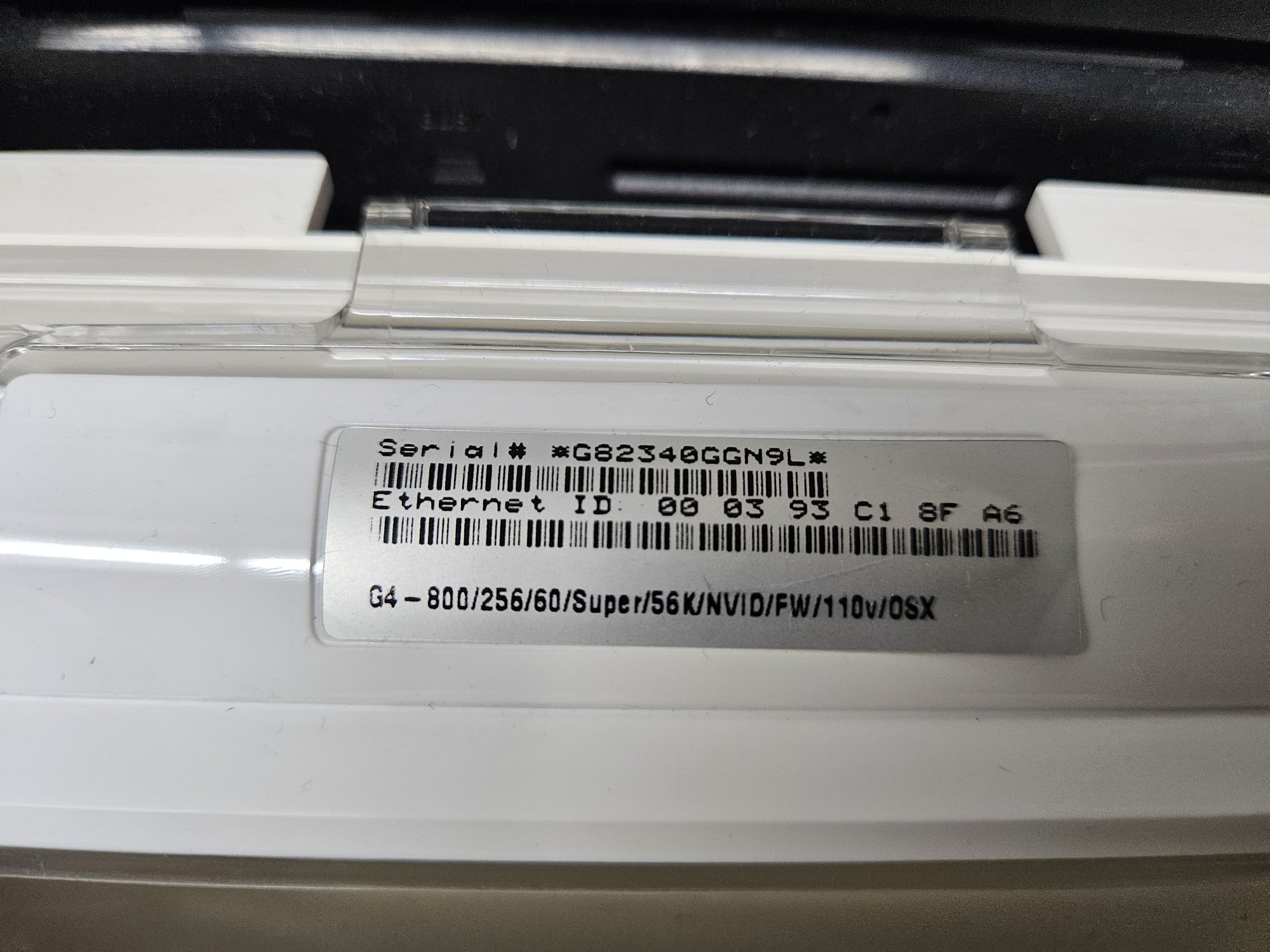

Help. My emac died. I've tried it all and the last thing I think it is is the capacitors I just can't prove it. I would like to find out if someone would sell me a compatable emac so I can place the hard drive in it to see if it'll boot. Not even sure that would work. I don't really have to have the data its just kind of a project to me. I've been a Mac User since day one. I hope I posted this correctly.

If you are able to provide more details on what you mean by 'died' and 'tried it all' you will likely get more help. It's not really possible to provide any specific help at the moment, please ellaborate on your eMac's issues. Typically a troubleshooting workflow for a non-booting system will begin with testing your software install before moving down to the hardware.

It began with me pushing the start button with nothing happening, no lights mo sound.. Nothing. I checked the plug strip to the wall, it had electricity. I checked the logic battery. It was dead so I replaced it. Then I took out and reinstalled the ram. Then I let it sit with no battery and unplugged for hours. Nothing. I checked the capacitors all seemed fine. Hope this helps describe why I said it's dead.
