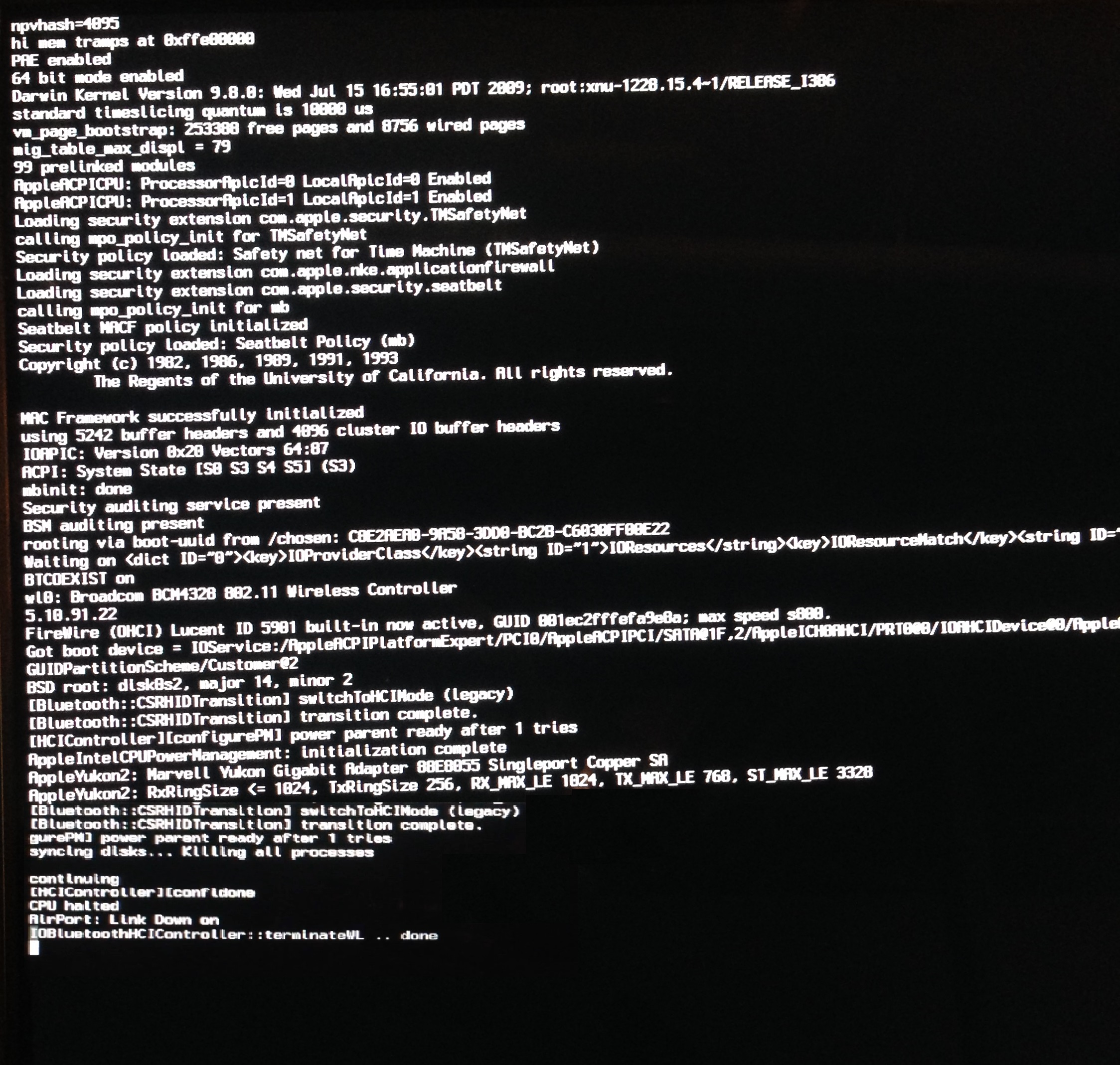

I then tried booting in verbose mode (Cmd+V). I will try to post that output here so you can see it.

Here's the output of verbose mode followed by the machine halts and the screen goes black.

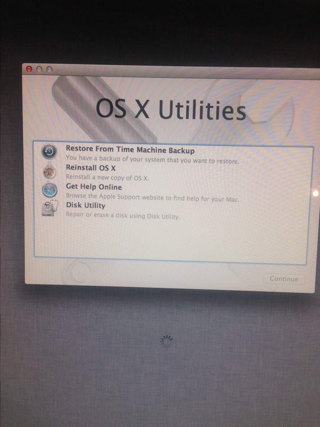

I don't have a Time Machine backup. I hitch up to the internet and boot the machine. When I see this screen,
what do I do next? Select "Disk Utility"? I have the old disk I replaced. There will be some kind of file manager available, right? Can I then just drag and drop files onto the file manager? I'll need to adduser, right? I can use a Linux LiveCD to add data files to the new volume but somehow sense that is not the way to do it.

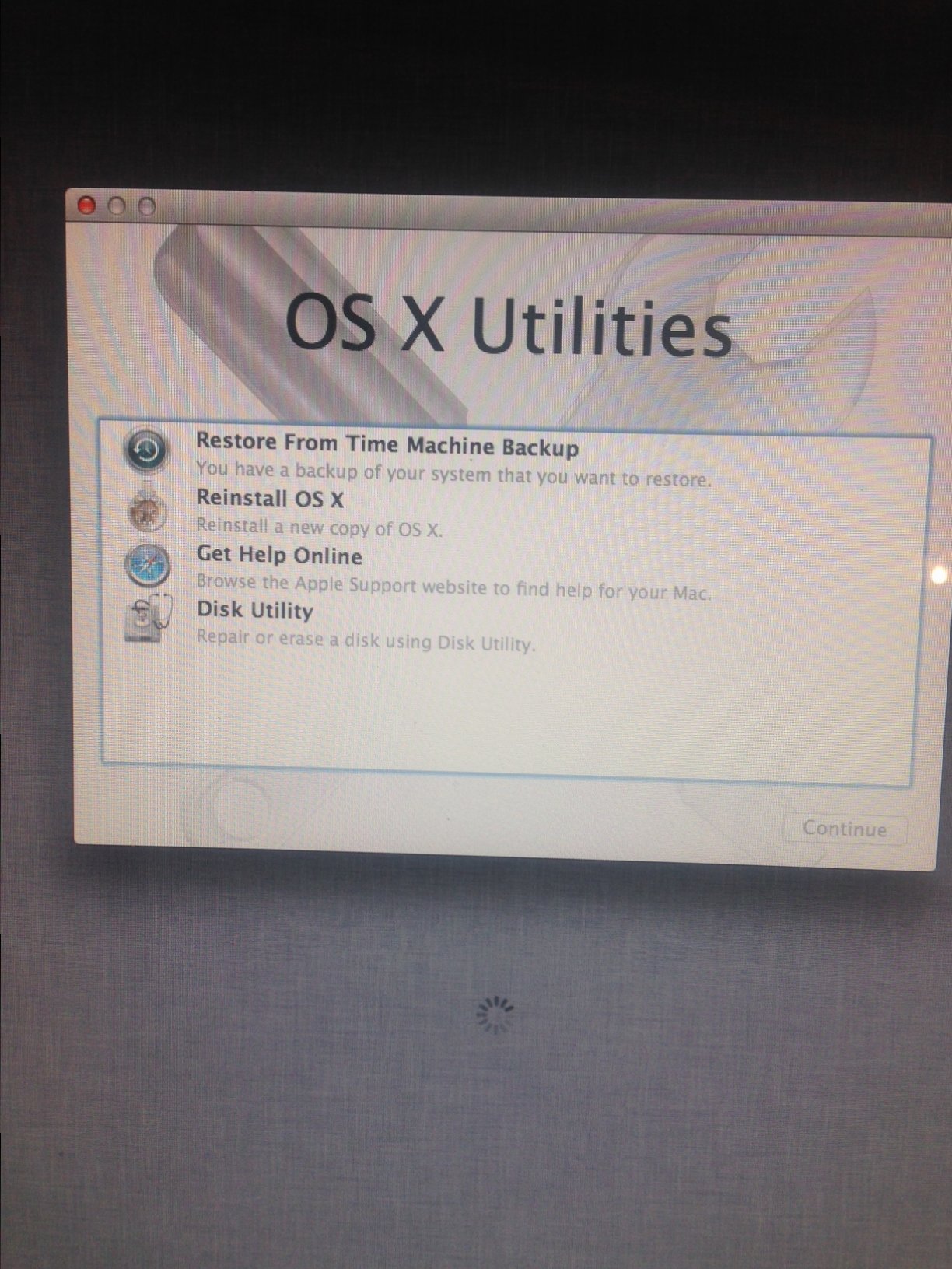

The new drive is in the machine, right?
Here's what you do if that is the case:
1. Open Disk Utility, and format the drive as HFS+ Extended, Journaled. Name the drive.
2. Select Reinstall OS X.
I'd suggest installing 10.11. Mountain Lion is no longer supported, and 10.11 is just as fast, if not a little faster.
Alternatively, you can hook the new drive up to a Mac via USB, Thunderbolt or FireWire, download the ElCapitan installer, and install ElCapitan, with the external as the target drive.
Hope that helps!
The new drive is not in the computer yet. The computer did appear to boot from the new drive via external Plugable USB Lay-Flat dock. That got me to the startup screen displayed above.The drive in the machine is apparently no good, so I plan to install the new drive into the machine then follow your directions as above then load the data, DL applications etc.
